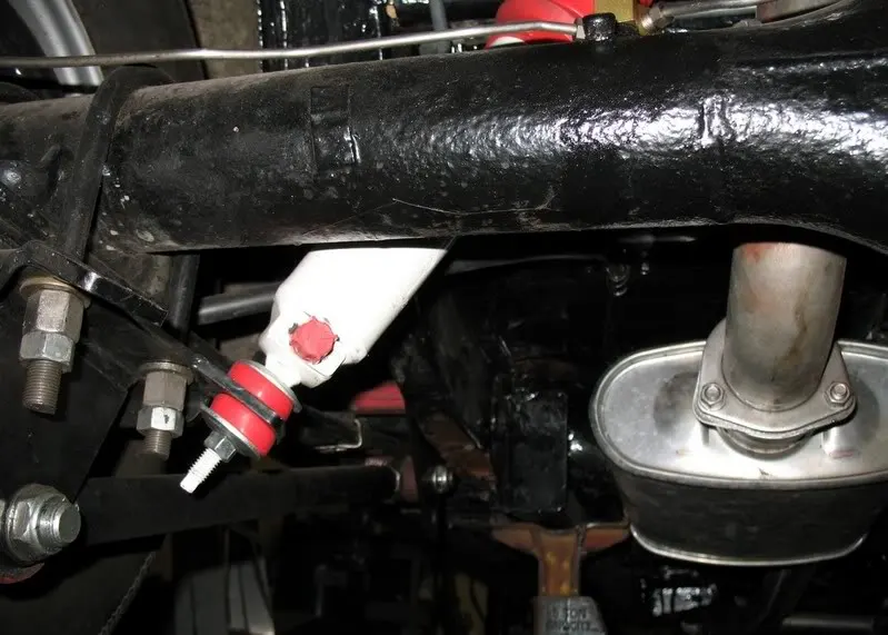

My solution was adjustable shocks. In particular, I use the Rancho 9000 series 9 way shock that Calvert recommends with the Caltracs. Model # RS99904. Unfortunately, due to recent price increases, these shocks are now about $100 each through Summit. :-( To me, the better ride was worth it as these shocks work great.
Each shock has a little knob on it that helps you dial a ride. I use 2 clicks on the street and 5 clicks at the track. The difference in ride is "tremendous." Shocks do make a difference.
You could also back off your Caltracs 1 turn when on the street, but I found little difference when using the gas-a-justs. Find a softer shock.
