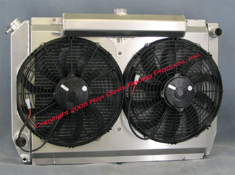

One of the best Radiator/fan/Shroud setups I have ever seen are from Ron Davis. I would say if your serious about cooling and can spare the cash, this is the BEST way to go.
This is the optimal way of sealing the fan to the radiator using a shroud which encloses the ENTIRE fan. This way ALL of the air HAS to come from in front of the radiator. Mounting the fan on the front like 99% of us do works but not nearly as good as this setup.
I'm no rep for them, just impressed by their radiator/fan setups!! :nice:

hey 91lx..did you get to see how much that setup was...and how many cfms those fans are pulling??.....i have drained my coolant and refilled it with 70/30....water/coolant....havent done the stat yet....just wanted to see what this would do....i also added the bottle of water wetter....tomorrow will be the first day i drive it since the change....ill fill you in on any changes....it just sucx i thought for sure the mark viii fan would cure the hot temps....but i guess the heat out here really is killer....it was 108* today!!!!
