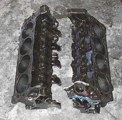

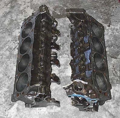

D.Hearne, I don't usually say stuff like that but I was on my way out the door to work and felt like being funny. I actually have never seen any engine block split down the middle.
Allow me to do the honors....
