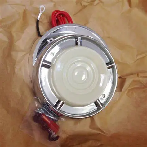

One thin layer on entire ceiling then second fatter insulate layers in-between the headliner rod locations
And unless your going original, add the 67 over head light (or something similar) before headliner install
