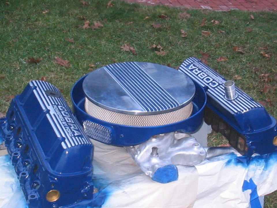

I had mine powdercoated ford blue years ago. Best $40 I ever spent. Looks great to this day, and cleans up super easy.

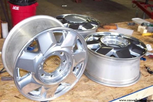

They have some chrome powder coats nowadays that look damn good. You can tell it's not quite chrome but it's close. You can also get natural aluminum looking powdercoat if your not a fan of chrome. Another good thing about powdercoating is that it will make a rough surface smooth. My manifold had a rough finish from sandblasting but came out smooth as glass when powdercoated.
Here's a pic of some aluminum wheels that have been powdercoated with Caswell's "Extreme Chrome".
