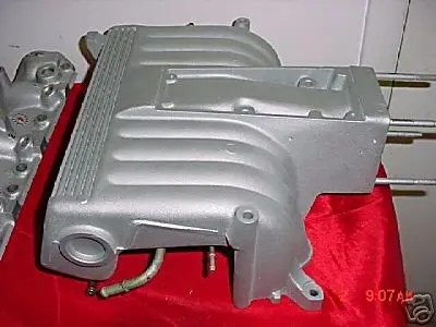

Alright guys wanna knock my intake manifold out this weekend... but i need a list of tools... Sizes ect... That im going to use... Part numbers for gaskets,thermostat ect.... I have a writ up already... i just wannna make sure i have everything i need... Oh and my intake manifold has realllly long studs... how do yoou get these off to replace them... i do have the elbow i need it just wont fit with these huge studs...

get two nuts and thread them onto the stud. then tighten the two together. then the one closes to the intake use that to loosen the stud to pull it out
For the studs, use two nuts tightened together and loosen it by the inside nut. Or you can try vise grips. The studs you put in might need to be really short since the lower front stud will hit the inside corner of the elbow adapter. I don't know about anyone else, but I made my own gasket for the adapter to the manifold and from the TB to the adapter. I used that $2 gasket sheet from Checker, you just trace it out and cut it.
