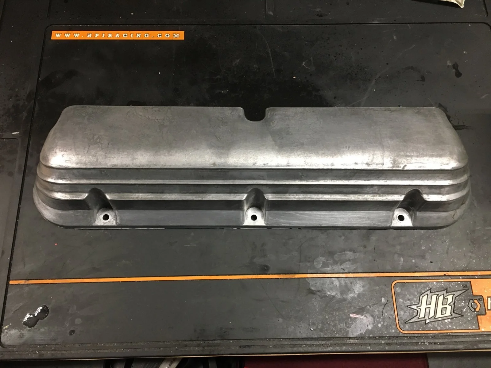

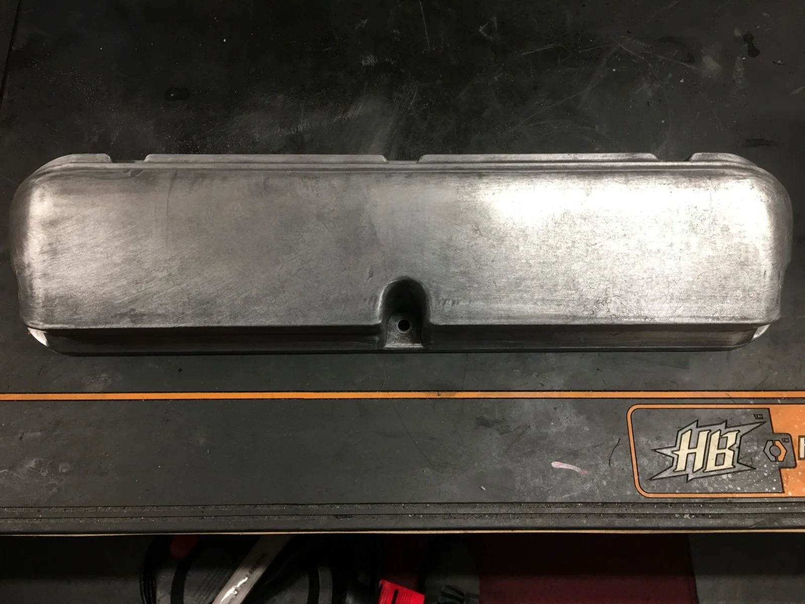

I’m gonna try the paint out on a valve cover first. I figure that’s easier to strip back down than the intake if I don’t like the outcome.
If not, I’ll just go with polishing covers and some silver back on the upper.
Cleaned the first one up last night.

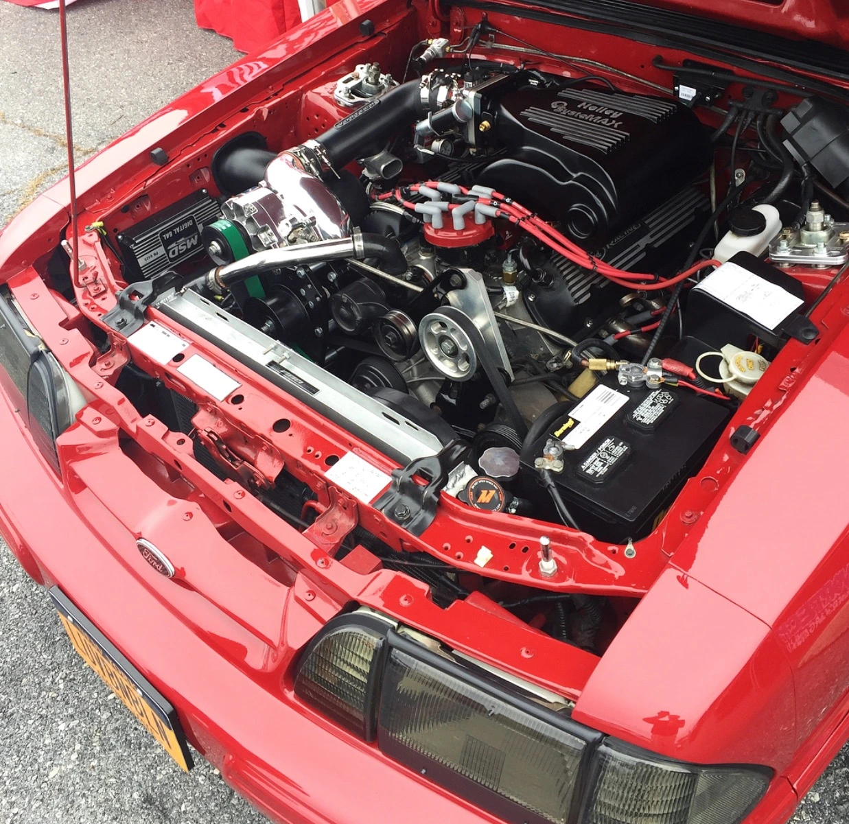

Your MSD box is upside down.

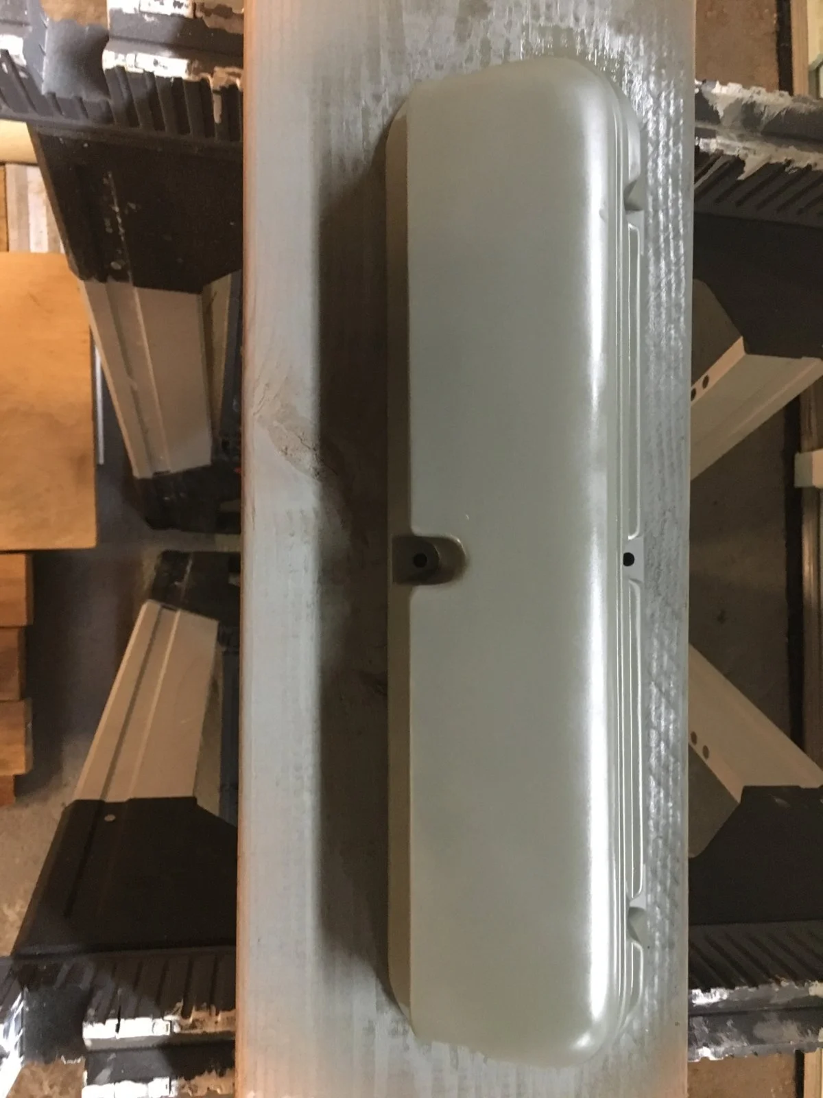

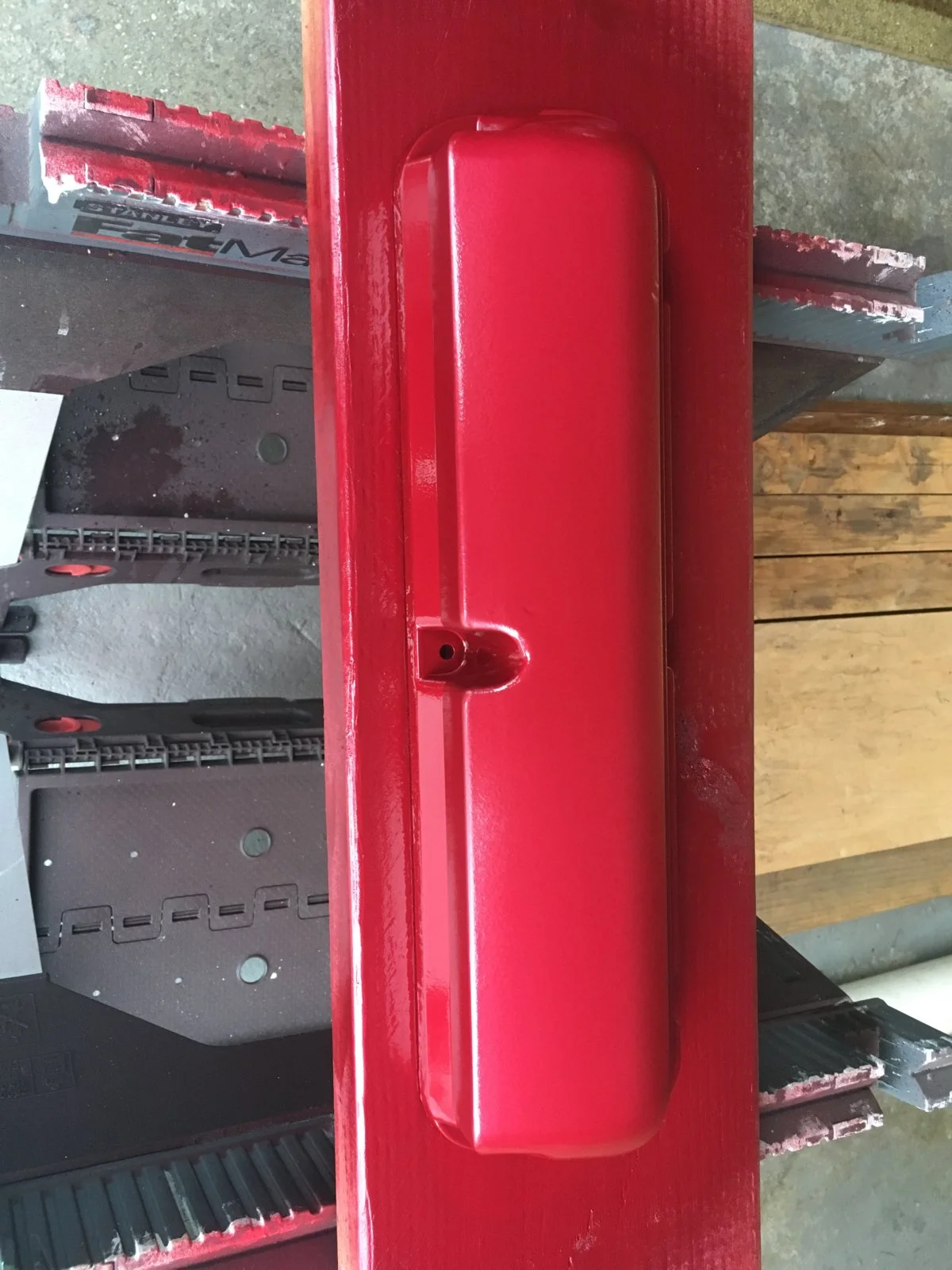

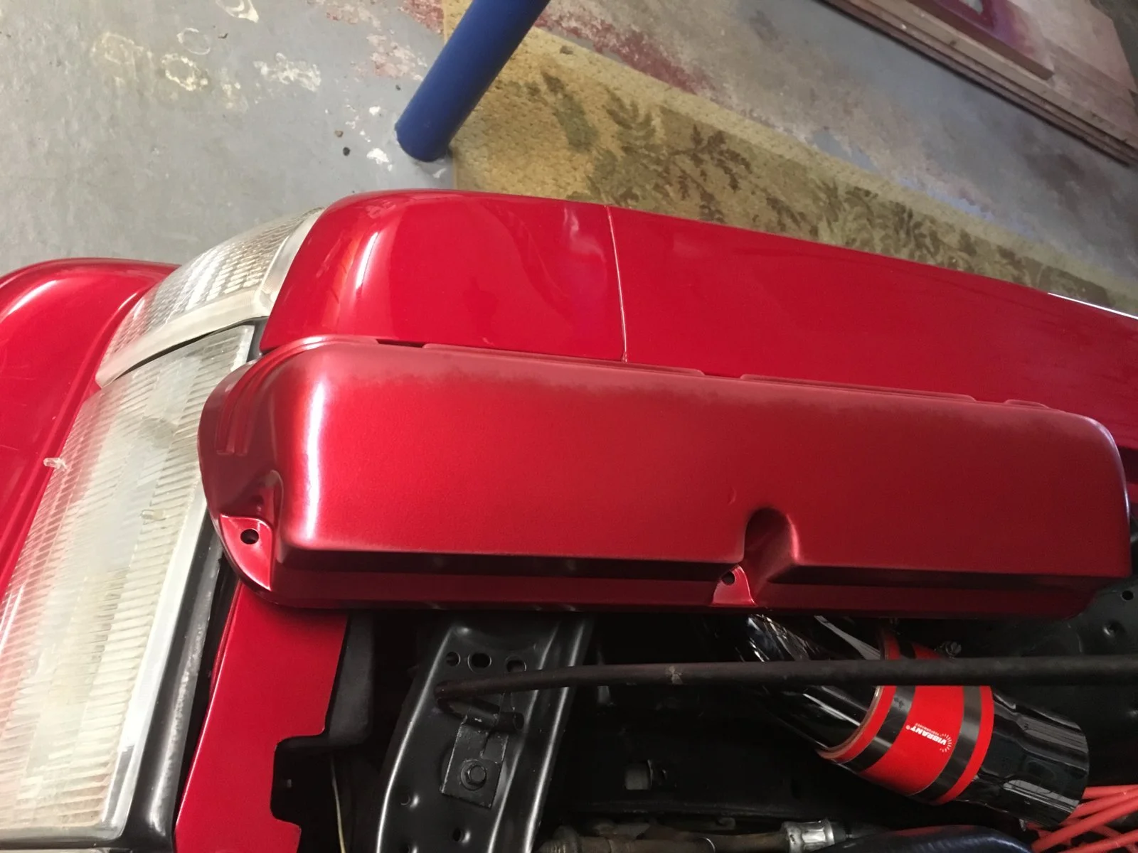

So, after much contemplation, I decided to paint a valve cover. I cleaned the crap out of it. Washed it, rinsed it, washed it again. Final clean was with mineral spirits. Primed with a self etching primer. Wet sanded that with 400. Then I went to work on my very amateur painting skills. It looked great for a while, but when completely dried, I see about a half inch or so on the edge looking dull. Did I not hit that with enough paint, or was it something else that caused it?
I’m thinking it’s from putting on too much material too quick. It’s a form of solvent pop.
That happens when the surface dries/hardens before the solvents had a good chance to leach out. Usually caused by putting the material on too heavy.
Completely opposite of my thought!!
There’s my “learn something new everyday” for today. Thanks!
Will applying a few more LIGHT coats get it to blend in. I’m not looking for perfect. Much of it will be hidden under the intake anyway.
