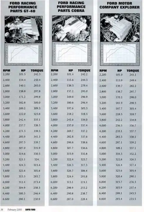

Thats interesting....seeing as you can get the explorer for $100 with today's economic times. And seeing as it flows as much as the cobra intake....
Im gonna bet if you outgrow the explorer, you also have outgrown the gt40 and cobra.
That is....unless you have some data to back up that the explorer is not as good :shrug:
I doubt u can find a gt40 for the price of an explorer....or even a cobra. So at that point i'd just go aftermarket. But when comparing a cobra vs. explorer...its a photo finish.
That'a nice chart there Nate, I've been looking for something like that......for those times when people down the Explorer in favor of the Cobra. Looks like the Explorer made more power than the Cobra did.
yep the explorer intake is truly the same thing. :nice:

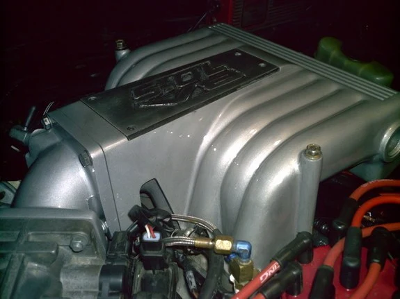

I cleaned up my exploder upper and had it powdercoated and it cleaned up REAL nice.
