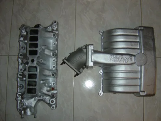

The_Mustang said:
the performer outflows ALL other street intakes out there, end of story. And they are super cheap if you buy them used, I had one and loved it. And I recommend it to everyone. And when polished they looks sick!
The Performer certainly outperforms all the other long runner intakes (Stock GT, GT40, Explorer, Cobra, TFS Street Burner, BBK SSI) but not all street intakes in general. I'd still consider the Holley Systemax II, Eddy Performer RPM II, TFS Track Heat, and BBK SSI-R as street intakes even though they have shorter runners that favor the higher rpm performance that's required on the strip.

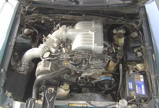

As for the looks, I painted mine (bought for $182 in ebay) with heat-resistant aluminium paint and it looks like this:

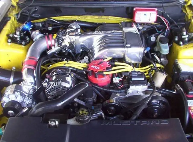

Here's my old Eddy, polished by yours truely:
Crikey, it looks like you've polished the whole engine bay there Mark. Very nice, and clean enough to eat dinner off it!

99FiveOh
Too bad I had to sell it a couple years back. It'a a car I literally put blood, sweat and tears into!
