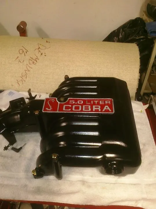

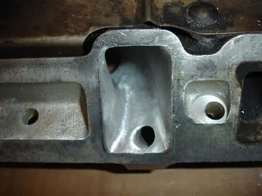

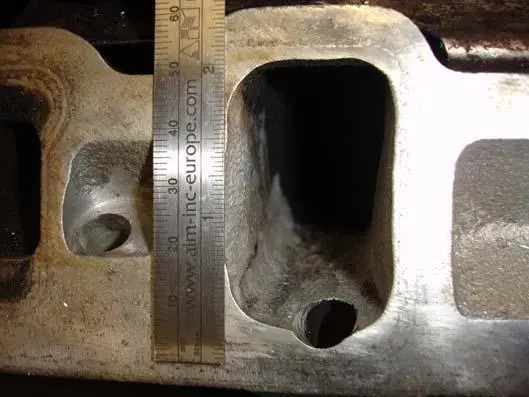

I currently have a 95 cobra upper and lower intake that is getting ported and polished
Before:
After:
I have read mixed reviews on here about phenolic spacers and if they actually help or really do anything at all. If i go with a spacer what is the biggest i can fit with a stock hood and brace? Seems 3/8 is a popular size. I would assume i also would need longer intake bolts and egr tube as well? :shrug:

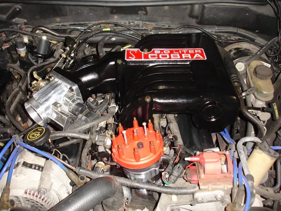

Well i ordered a .5" GT40 spacer kit made by ford racing that also included the Intake bolts needed with it. Well.. you would think that a kit that has a .5" spacer and the bolts thet they would be .5" longer right? Nope. After checking the length they are not long enough. :rolleyes: I dont know what they were thinking putting stock bolt lengths in a package with a .5" spacer. So i did not end up using the spacer.
I was amazed after taking off the stock GT TB and manifold. Wow they are just junk lol. Manifold is just tiny!! Even though the OEM Tb is 65mm the butterfly is about HALF that.
Anyways i decided on holding off on the H/C/I since there where far more parts and cost then I originally anticipated. (Rocker Arms, Push Rods, Valve Covers, ect..) Here is the reassemble so far...
