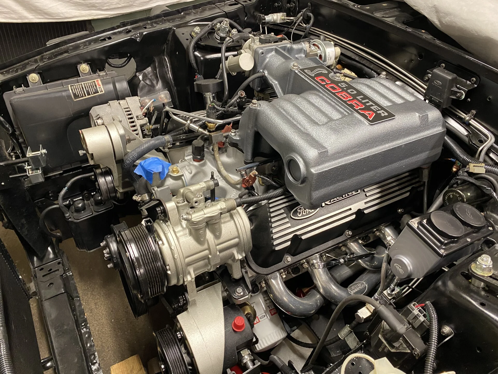

A 3/8” spacer is all you need for a cobra intake to clear those valve covers. 3/8” will also fit under stock hood. 1” will not
That's exactly what I have on my car

I have Cowl hood. But the money iam spending on the intake debacle I caused, I have to wait. Will order the kit..thank you very much for your quideance on everything. Your motor set up looks cool. I ordered some black wrinkle paint. Iam going to paint the lower, upper, and valve covers. Should look pretty good. I like the black out look.

I those same valve covers with a cobra intake and didn't need any spacer for it to clear. All you need to do is notch the bolt holes in your throttle cable bracket a little bit to allow you to slide it up a higher to clear the valve covers. I did buy a 3/8" spacer but didn't use it due to clearance issues with my strut tower brace.
