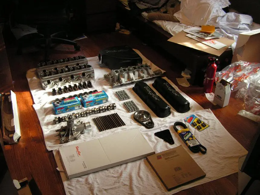

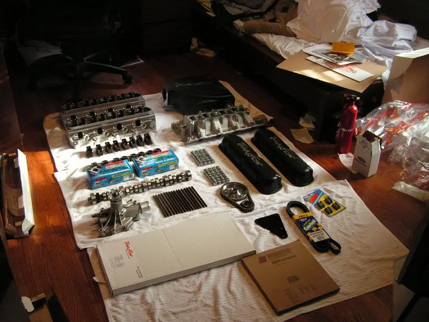

Here was my TFS kit the day I got it, really a great buy.

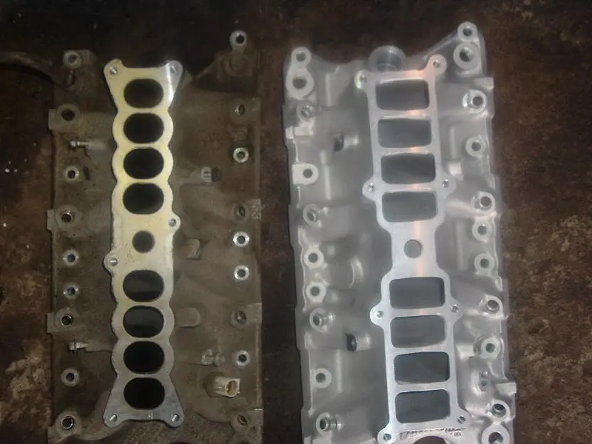

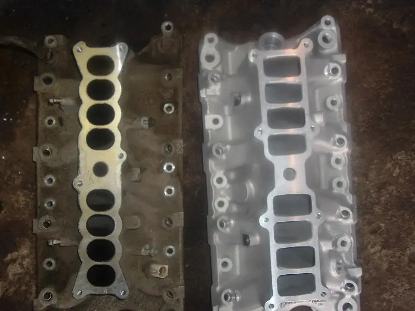

btw just for fun, this is the difference between a stock intake and an edelbrock RPM2
