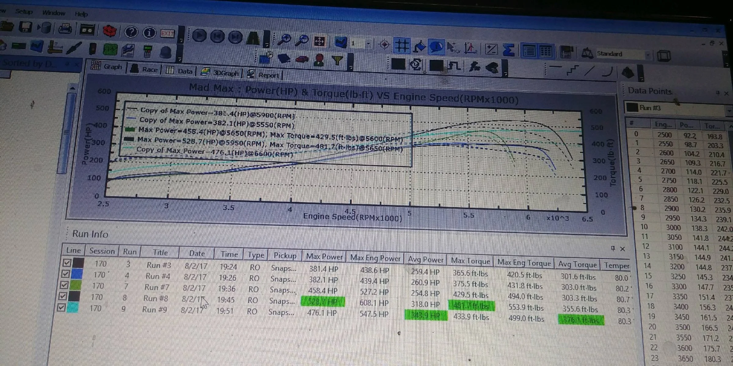

Well guys she's tuned!
Made 528hp/481tq on 12psi!
On just wastegate pressure it made 476hp!
Pretty good power curve as well!
Only downfall, my trans took a dump on the dyno, so hopefully my tko will be here mondat that I ordered from LMR.
