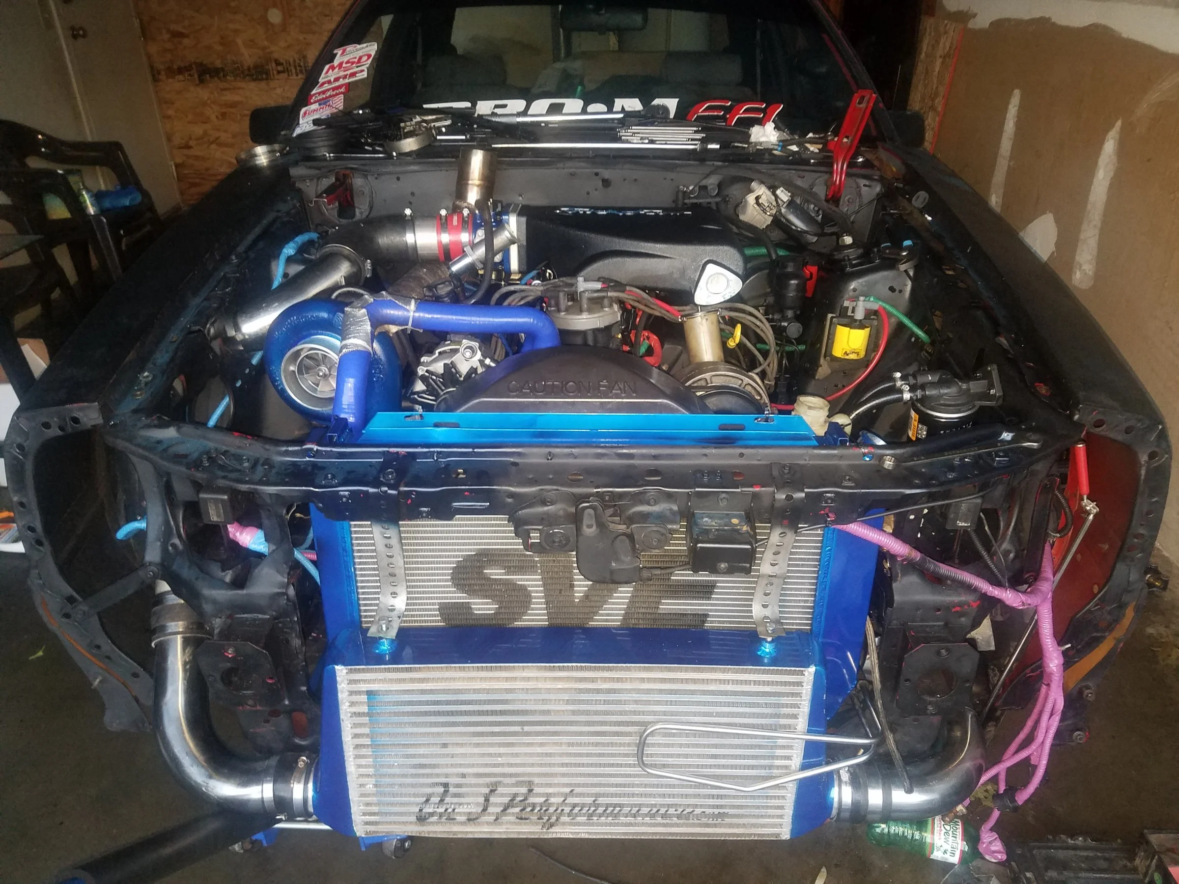

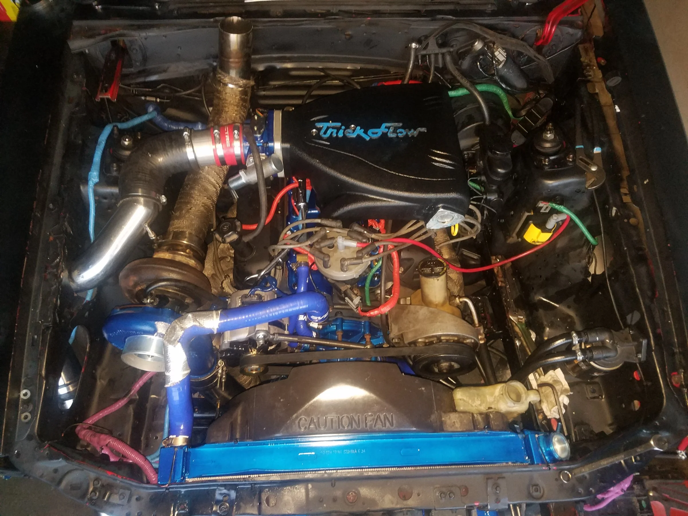

Finished product!

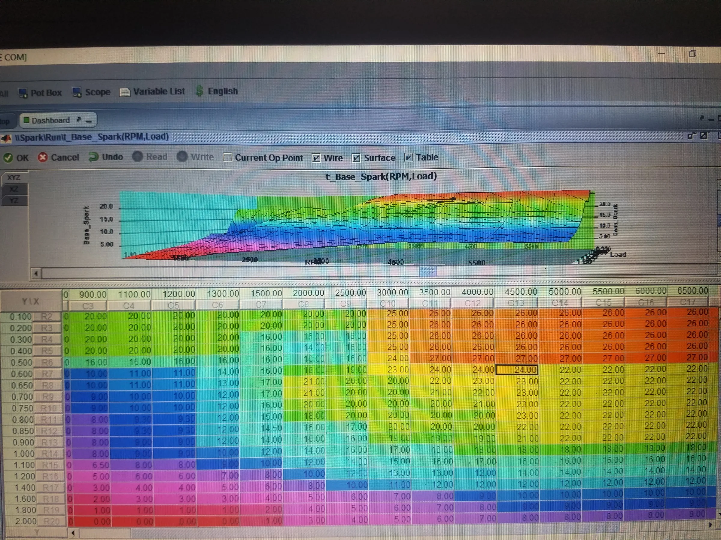

2* per psi is super conservative.
Run 93 octane pull .5* per psi.
I don't pull anything below 5psi.
Max timing 28* with an a9l that's a base timing of 10*...

Alright I'll keep that in mind, thanks.
But I'm running the pro-m efi system.
So for 6psi just pull 3* of Max advance and call it a day?

Yes and no. If you are new to tuning 1* per psi is where you start. Then you verify MBT on the dyno it usually comes out to .5*per psi roughly.
Get AFR in boost between 11.8 and 12.1 this Is the sweet zone.
If it has an option to pull timing with manifold temperature I suggest you do so. When intake temps get above 130* detonation becomes more likely.

Alright awesome, yeah im pretty new ti tuning, but pro-m is a pretty simple system. I'm writing the tune now, so we shall see.
Just to make sure, I'm looking for 14.7 at idle, cruise, part throttle?
Awesome, thanks for the advice!
I've got it idling at 14.7-14.8.
I'm gonna let it cool off, top fluids off as needed and do some street tuning!
Any tips for street tuning?
I won't be logging, but ill be tuning live as she runs.
I don't know how to log with this software.
Tuning on the fly with this system is easy, adding fuel and taking away is just a click
This isn't going to be the final tune, I'm gonna tune the drive ability, then get it dyno tuned for power so I have a good mix of street manners and racecar
Hard to judge without a datalog to tell me where your voltage curve is each rpm/throttle position.
But it looks good 22* in boost is safe 16-20 at idle is good. Cruise timing can be advanced, I run up to 40* in some conditions
I wish I had a good way to data log.
So far it idles well, and I can light throttle my way through the gears without crazy afrs. I'm gonna call my tuner Wednesday to get some dyno time booked
