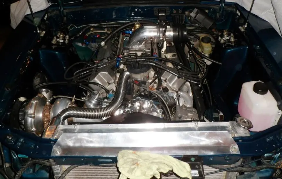

The intercooler is to small for the application. Inlet/outlet to small and it should be physically a little larger. Your car should be capable of over 1000a horsepowerzz and that thing is gonna choke it.
Made some progress. I still like the Precision intercooler, I have gotten great reviews from others using it.
These guys are owners of shops that have built cars making more power than mine ever will. All of them said the Precision unit is more than enough and the the in/out is not a problem.
Greg Banish went so far as to recommend smaller inlet piping for faster spool and transient time.
One of the shops built a LSx motor touching 4 digit power levels with this intercooler ( bigger turbo than mine )
How big of a motor? I am just finding it had to believe that is the best option for you.
