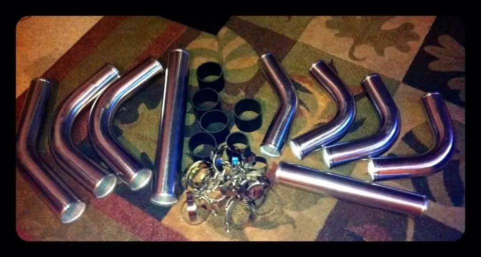

Intercooler time!
pipes!

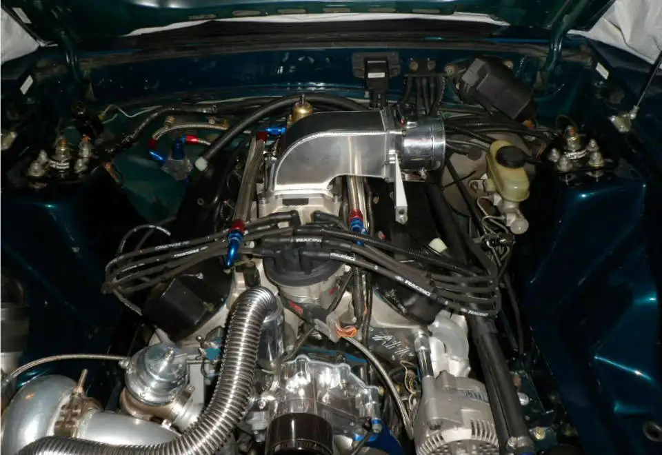

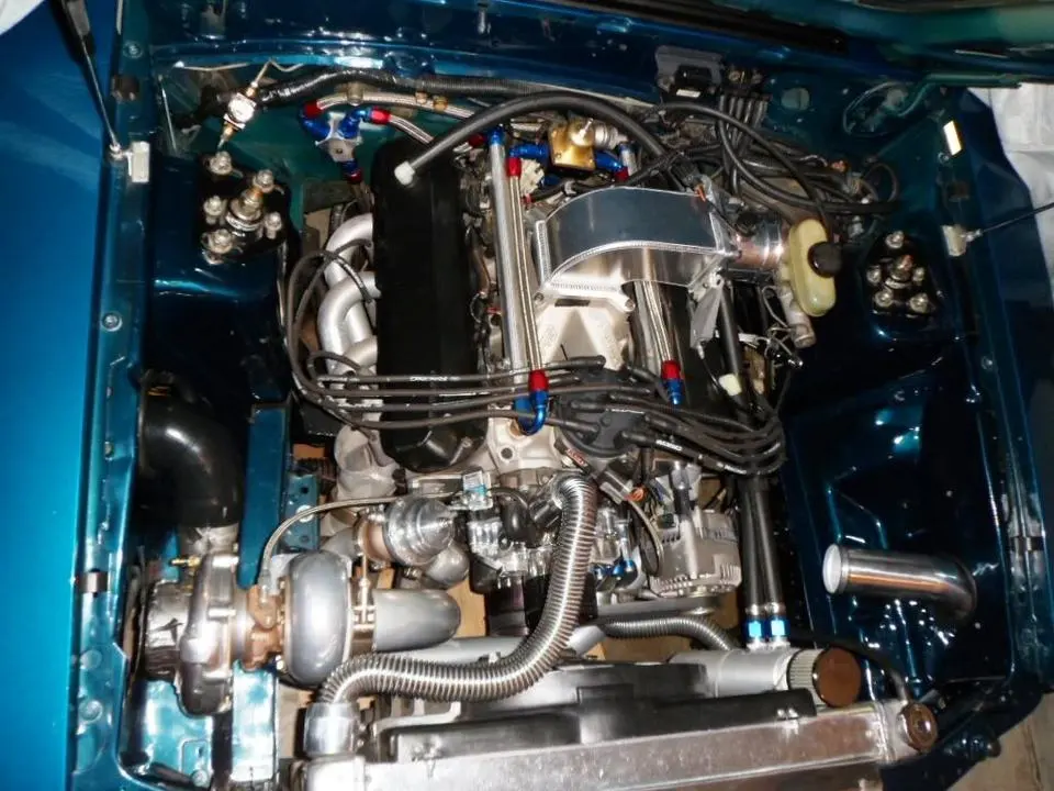

slow progress, waiting on some 90* couplers. I did fix up the wiring mess in the back passenger corner.
I still need injectors, not sure what to do. I dont have the funds for a standalone and I dont think going from 60's on gas to 80's on E85 makes any damn sense.
what do you guys think?

I think you'll be safe with a set of 120 high impedance. Once you determine the proper injector sizing for gasoline, you can generally add 30% to get an idea of what size injector will be needed for e85. Unfortunately, I think 80s might be undersized and run at too high of a duty cycle. The consensus seems to be that you dont want your injectors to run higher than 85% duty cycle.
Hope these links help:
E85 Injector Sizing
Injector sizing ? with E85 - Ford Mustang Forums : Corral.net Mustang Forum
http://*******.com/index.php?topic=28992.0
