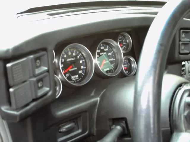

I have his gauge plate. VERY nice piece. Sitting in my basement wired up waiting to go in the car.
I have the same cluster

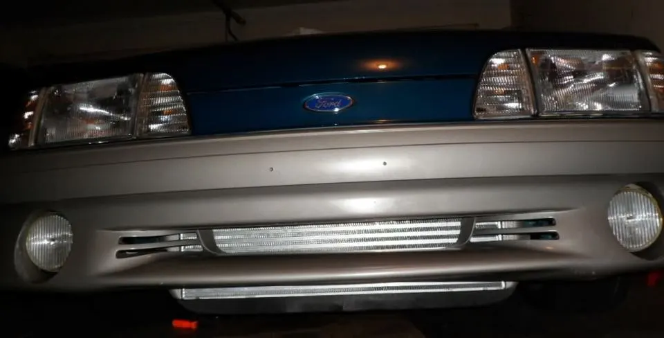

Intercooler mounted.
Had to toss the nose back on for a quick shot or 2.
Looks great to me and I think it will get plenty of airflow without having to cut the bumper any. Hooray!
