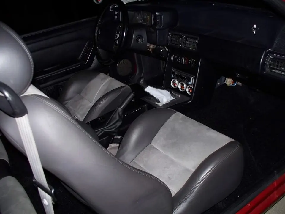

To be completely honest, I painted each of my interior parts with three coats of SEM landau black color coat and they each turned out to be a perfect match for OEM black without any kind of clearcoat at all. I'm letting them cure for a ridiculous amount of time before I ArmorAll them, but that's just my own paranoia at work. I'm sure a good ArmorAll coat on your painted parts would give you all the shine you'd need. The factory finish is flat, not glossy. Just my $.02.
here's a pic of mine, it's 90% done, i still have some touching up and painting to do, but it's pretty much there... don't mind that annoying HVAC control vacuum plug thing, it pops out in every picture i take

Thanks that just the opinion I needed, Im going to leave them the way they are, with just 3 coats of paint
