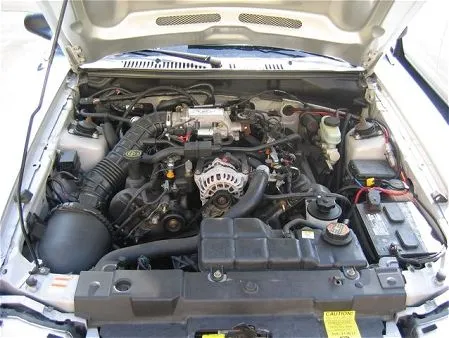

The mod is obnoxiously larger than the old pushrod motor.
compared to
Compare the locations of the valve covers of these two engines, how much space there is either side of the pushrod engine. Add in the intake manifold and upper plenum and you end up with a very tall package too.
The fact that pulling off even a valve cover on a SOHC engine is tricky (getting it past the master cylinder and hydroboost, for instance) indicates that the mod is a dimensional pig compared to the pushrod motor.
Both fit in the Fox/SN-95 engine bay but one definitely leaves more room left over... :)

But I'm not fixated on the manifolds. Look again at the valve covers of both engines: The mod is 10 inches wider. Another example: The 5.4L mod is a tight squeeze even in a volume as large as the SN-95 engine bay because its added deck height just pushes the cylinder heads that much further apart.
A 460 big-block is narrower than these engines...
For the cubic inches available versus the volume taken, the mod isn't a very efficient solution. In a wee little car I think a pushrod mill would be a better solution both aesthetically and performance-wise.
