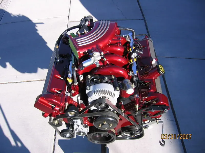

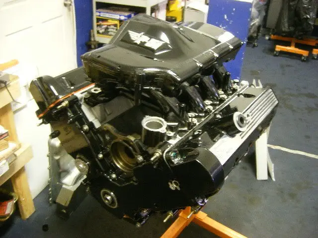

Keep in mind that 4.6 2V's can be made to look very nice if you know what you're doing. The stock PI intake manifold looks terrible, but there are a couple choices such as the Bullitt, Trick Flow, or P-51 manifold that when painted look great. Here's a couple pics of painted 4.6 2V's:
Using the P-51 manifold:
Using the Bullitt manifold (could also use the Trick Flow and it would look similar):
I think your project sounds like an awesome idea. It sure would be unique and cool to be able to open the hood and see one of the engine pics I posted above or a 4.6 4V.
Those 2V 4.6's look beautiful. The first on though is too tall, I'd need a low profile intake.

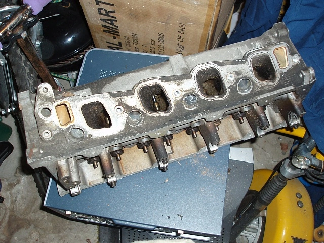

How can i tell the difference if I have PI heads or not?
The intake ports look different. The PI heads have a more square appearance, the NPI heads have a teardrop shape to them.
PI heads:
NPI heads:

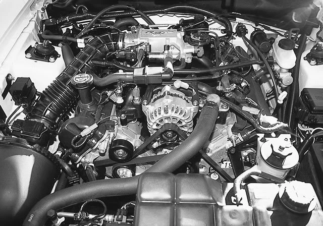

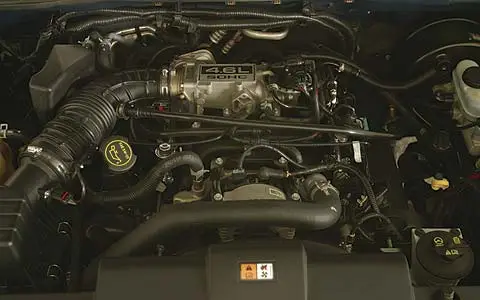

IIRC the explorer has the same manifold as the Mustang, just a different TP and plenum.
I believe mechanically, the plenum and throttle body are the same. The differences are purely cosmetic. The Explorer says "4.6L SOHC" on the top of its plenum, where the Mustang has the running pony on the top of its plenum.
Ford Explorer
Ford Mustang
