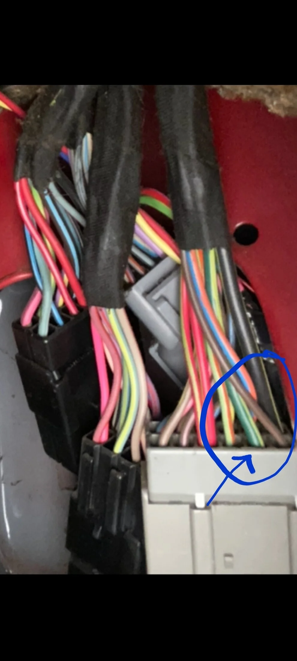

I second that fuel filter check. There was a good write up here on that code 96. It ended up being a bad connection at a wire behind the drivers kick panel. Worth checking. If I remember correctly the connection in the connector heated up and left a burn mark. I've helped a couple people with this pic. Wish I knew where to find that thread.
