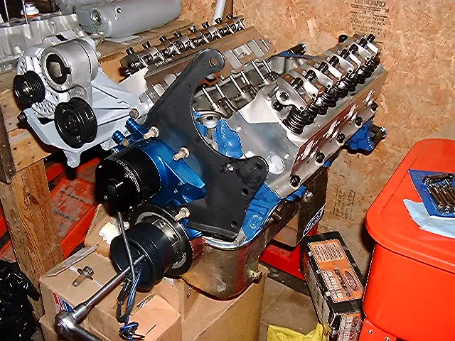

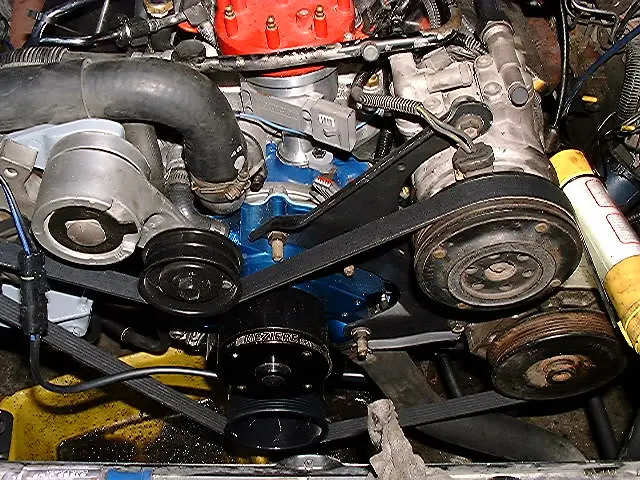

i run a meziere 300 series. i'm using the one without the idler pulley built in. it looks like the factory pump and has all the mounts done proper to hook up all the factory brackets and heater hoses. it is not my daily driver due to cost of driving it cause of gas. but if i got decent mileage, i would drive it more. i got it like 5 years ago for around $300. dunno what the price is now, or what improvements have been done.

did no one read my previous post? get the meziere 300 series like i did and be done with it. 55gpm is enough. i have never had a problem with mine, or running to cold that i had to run a on off switch, controller, or whatever. i do have a DCC controller, but it is hooked up to my fan only. just use a relay to turn it on with key power and forget about it. i run a thermostat and everything works great. i had to grind the A/C bracket to clear the pump but it bolts up and allows me to use A/C and power steering like stock.
