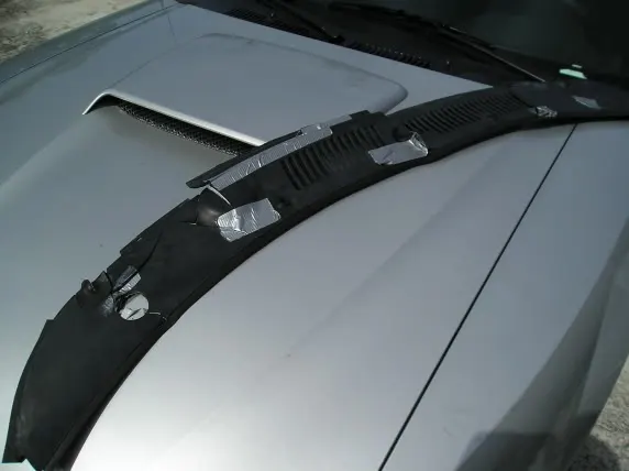

its pathetic how bad mine cracked when i took it off. but there is a certian procedure to remove the cowl you have to unbolt the window pillar covers on both driver and passenger sides. which i never had a clue to do not untill i got the instructions with the new cowl
i had to shell out 140 for a new cowl cover.

KronicRacer said:
been there done that ^^^
i wish they had an aluminum or metal replacement for that cowl cover
That's some good info! Thanks :nice:
BTW, where did you get your replacement? I've yet to get mine.
WOW! $140 That bites,...... :nonono:
this is why i had to get mine the next mornin LOL
also when you undo the bolts for the windsheild pillar cover slightly separate them dont pull them off completely the instructions are provided with the new parts. so give them a once over before installing
