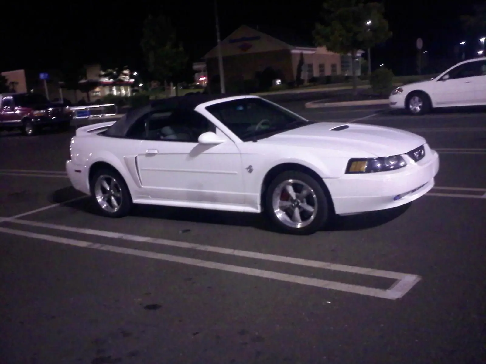

I want to know if it normally for my 1999 GT auto vert to chirp tiers at 50mph with just a few mod's:shrug:
I was getting onto 422 near my house and one thing I love to do is give the Stang some gas when I get onto the on ramp:D and at about 50mph the tiers chirp, I was kind of thinking is that normally for a auto GT to do that, so I thought I would ask you guys.
A little info on the car if this helps. I purchased its from a friend that’s works at a local speed shop, he had a GT and his wife had a v6 vert, he crashed his GT:doh: then he changed every thing from the GT to the v6,!!!so his wife didn't want a GT so I purchased it for $3,500 and the GT only had 70,000 miles …I thank his wife all the time…..;) because I love this car!! :nice:SORRY FOR LONG THREAD! :SNSign:
Modification: MagnaFlow cat-Back, bassani o/r X-pipe, bbk cold air intake, , Cobra Brake Upgrade.
Not installed; saleen underdrive pulleys, 410 gears
So, the car is actually a v6 with GT drivetrain? Did he swap the rear end over as well? It could just be the open rear diff that the V6s got making it happen, or if you still have the big balloon sixer tires. I've seen a few bone stock 4R70W cars squawk second with little effort, like any MN12 car with a V8. Or, it could in fact be a massive belt squeak happening on the hard shift. My old belt would do that, and it almost sounded like a blowoff valve.
Is it normal
So I guess its not normal for the car to chirp at 50mph,but it wasn't the belt I had the top down and I heard it pretty good. Yes the car was a v6 but every thing from the GT was swicted over into the the v6 and I mean every thing, except for the bumper:shrug:
