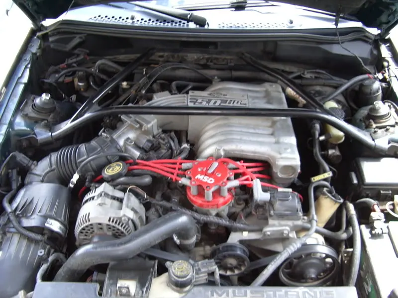

before:
after:
Thanks for tips Stephane. I'll go ahead and buy some degreaser later this afternoon. Just finished spraying down the engine with water and tire foam and it's looking great already. Wiped it down with a clean towel.
I don't know how they got there but there were penut shells under the upper manifold. :rlaugh:
