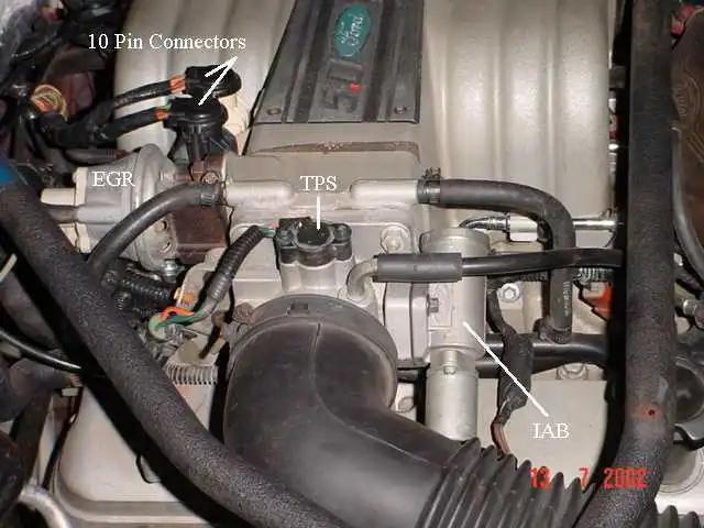

Clean the MAF as suggested. If that doesn't fix it, replace the TPS. A flat spot in the TPS will act just like you described.
Picture courtsey of Tmoss & Stang&2birds....
See http://www.veryuseful.com/mustang/tech/engine/ for more good stuff...
