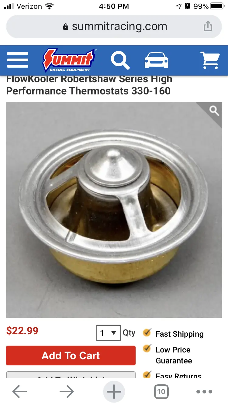

If you do change it, be sure to get the full flow type. This one is the brand and style I use if given a choice. The picture shows they are not the typical Stant design that can close under high rpm flow and pressure.
