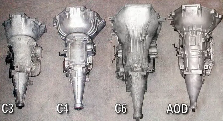

Here is an article that might help.
From the article: "Ford redesigned the C-4 into an overdrive automatic to lower highway driving ratios resulting in better highway MPG ratings. They called this replacement transmission the AOD, meaning automatic overdrive, and it became Ford's first automatic four-speed offering. Because the AOD is basically a retooled C-4, many classic car owners have discovered they can substitute this overdrive transmission into their '60s and '70s production vehicles relatively easily and reap the benefits of a lower final gear ratio and decreased wear and tear on their vintage small-block V-8 engine." Looks like first offering was 1980 but if you can call it a C4 you could get by.

Is the inspector even going to know what a 1979 C3/C4/C6 or AOD is supposed to look like? Do they actually look that closely?
A '79 Cougar uses a C4 I think? I mean, they look pretty darn close.
