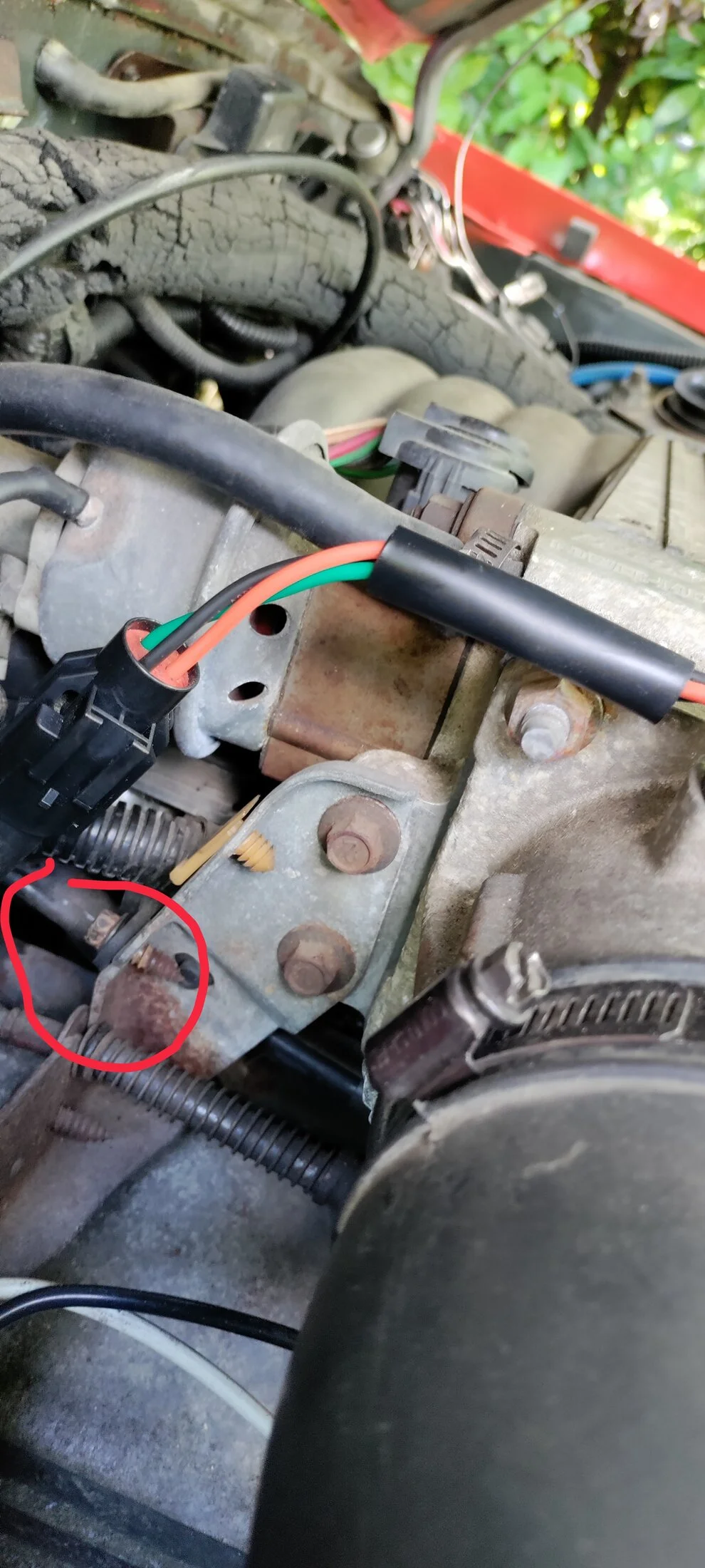

Doing an idle reset on my fox and I wanted to know if I got the right place where to throttle stop screw is (circled in red) I have an aftermarket throttle body. Also I wanted to know to turn it counter clockwise or clockwise to adjust the idle (currently the car dies when I unplug the iac)

No. It's on the throttle body by the lever, clockwise to raise RPM, counterclockwise to lower RPMs.
Note: a little goes a long way turning the screw.

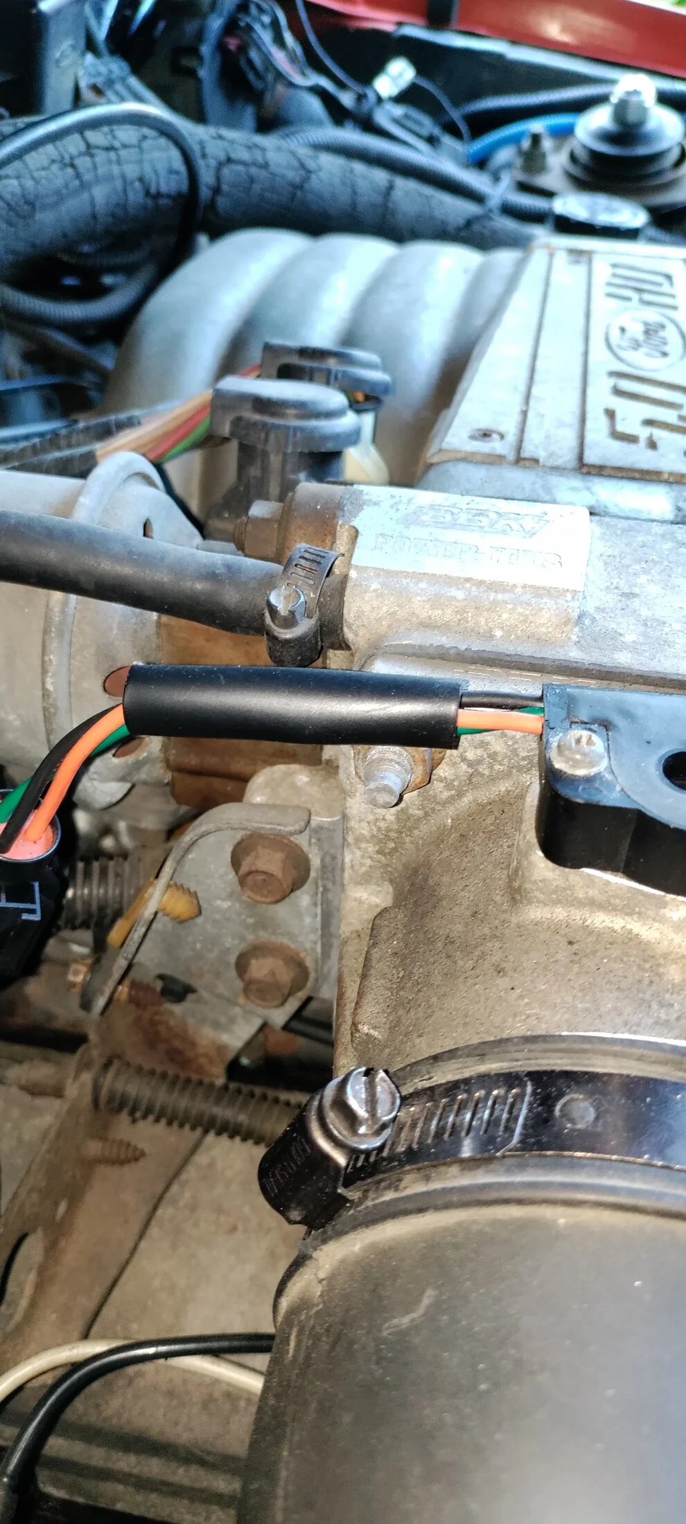

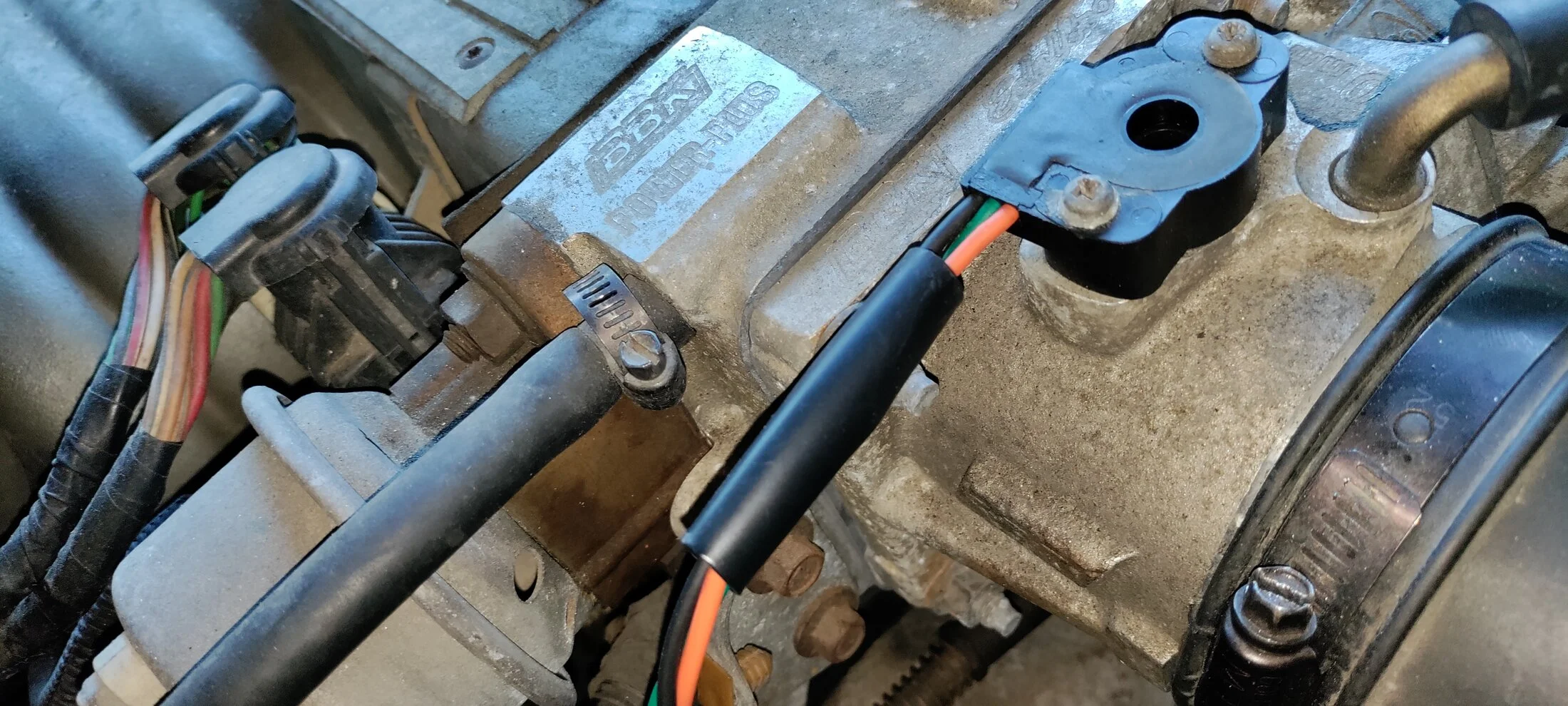

Yes I have. Pretty simple procedure except I can't find the exact spot that would be the throttle stop screw. Do you by chance see it in the pictures?
