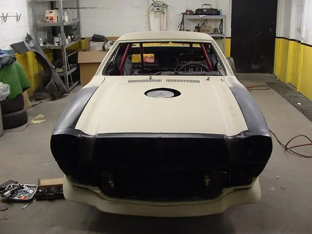

back to the scoop i simply cut a 12 in centered hole in my hood, used the factory scoop and installed a k+n top flow 9 in lid.. im done..
the only pic i have is with the scoop off , getting ready for paint.
