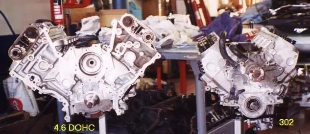

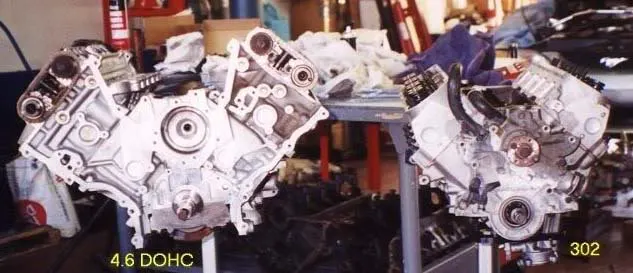

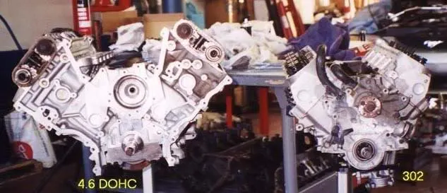

This should give you a better idea about why it isn't feasible to put a mod motor in without removing or greatly notching the shock towers:
OMG!!! I knew the 4.6 was a wider motor, but I never imagined it was THAT wide! That thing if frikin huge!
Yep . . . it's as wide as a 460 (if not wider), which is why I can't understand why anybody would want to put one of those in a classic Mustang--if *I* am going to put something that wide in *MY* engine compartment, it's gonna have some CUBES!! :D

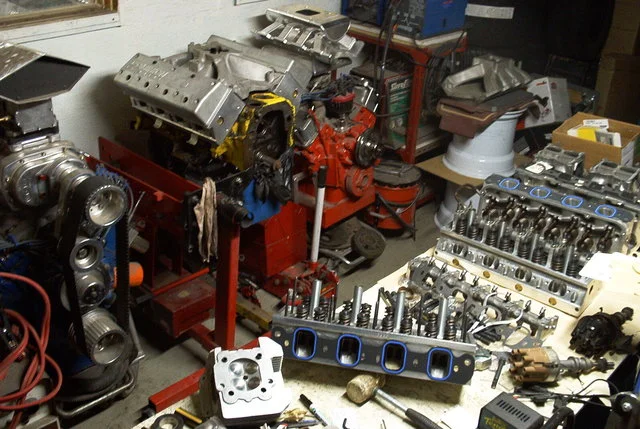

here's a setup for a 351C with 32 valve, not an overhead cam swap but still pretty cool!!!!!!
4Valve Cleveland Boss351 and Pantera Heads
here's another for windsor engines
