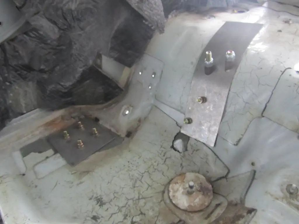

i was scanning Fredmatic's build thread and saw this picture, is the square plate the top of the torque box?
reason i ask, when i pulled my rear seat for the quarter window repair i notice very slight surface rust to outside of the seatbelt attachment area toward the quarter panel/wheel well .... im thinking its from years of rain coming in around the vert top... was going to wire wheel and spray with a rust sealer before i put seat back.... theres no heavy rust acne or anything....crawled under no visible rust or softspots, but need a lift for t-box... anything i can check on torque box without lift??
id snap a photo but its pouring out
any advice on product?
i was thinking rustoleum auto rust sealer... i dont think its heavy enough etc for POR 15...
That plate is the top of part of a popular chassis mod called a "Battle Box" by Wild Rides. It is designed to keep cars on slicks from tearing up the torque box. If you have rust, neutralize it with a rust neutralizer and paint over it.

cool i was like hmm how close is that rust to my torque box but had no reference point, the battle box top plate clarified that...thanks Kurt.
