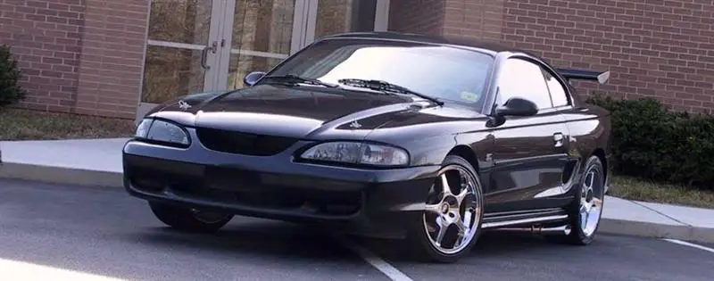

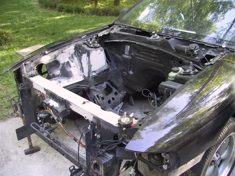

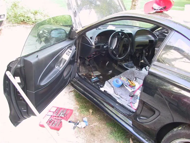

I miss having my car in one peice..... Having a big project can be depressing :(
My car is currently apart, I welded up the enginebay, and am putting the bondo glaze on it now to smooth it out.. Then comes the 347 and tremec tranny, plus whole new black interior. Can't wait to finish, but it's a long road to get there :( :P
Pix of my 347 coming soon.
Specs:
347 CI,
68 Mustang 302 block
Scat Crank
Eagle Rods
Ross Forged Pistons
Trickflow Twisted Wedge Heads
Weiand Ported / Polished Intake
Black n Red Ford Racing Valvecovers
Barry Grant Demon Carb
7 Qt Canton Oilpan w/ deep pickup
And I'm running the Holley Blue elec fuel pump, and Tremec 3550 Tranny...MSD ignition... Fluidyne Radiator....4 pt rollbar + harnesses... Cobra brakes...umm... Y2k Cobra R's... Gonna get a Steeda wing instead of the much-hated Cobra R wing :D
Excuse the noobage within, I'm still 16, and it's my first MAJOR project. (All work done by me, except 347 shortblock assembly) :p

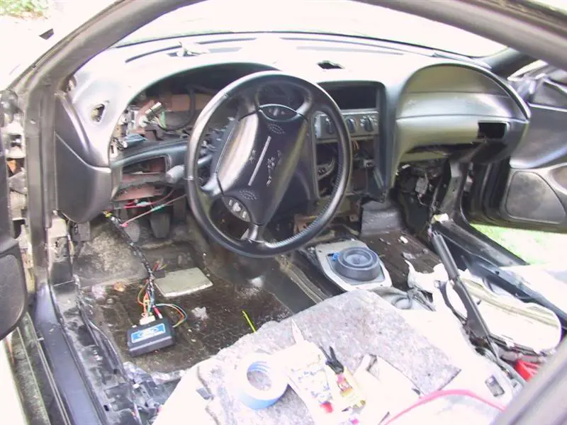

Btw, which wire is the power wire from the electric fan? I'm running a switch for the fan.
Enjoy.

At what point are you askin about the power wire for the fan? At the CCRM, at the fan itself, etc?
Pin 14 at the CCRM (NOT pin 14 at the computer) is the control to turn on low speed. Pin 17 at the CCRM is for high speed.
On the fan, IIRC, the middle prong is low speed. There's a ground on one end (the top IIRC) and high speed is the remaining wire on the other end. Double check wiring colors and schematics before soldering away.

Yeah, it's no small project. The car is basically stripped of everything except body.. I already did the suspension earlier this year... Putting in new fuel tank, pump and lines too, as well as 31 spline axles, Cobra brakes on the rear.. Lotta stuff :D
And yep, I do it all in the driveway.. It hailed the other day too :nonono: I have a little EZ Up shelter to keep the direct rain/hail outta the enginebay of the car.

HISSIN: I meant right at the fan. That's what I needed to know, thanks!!
