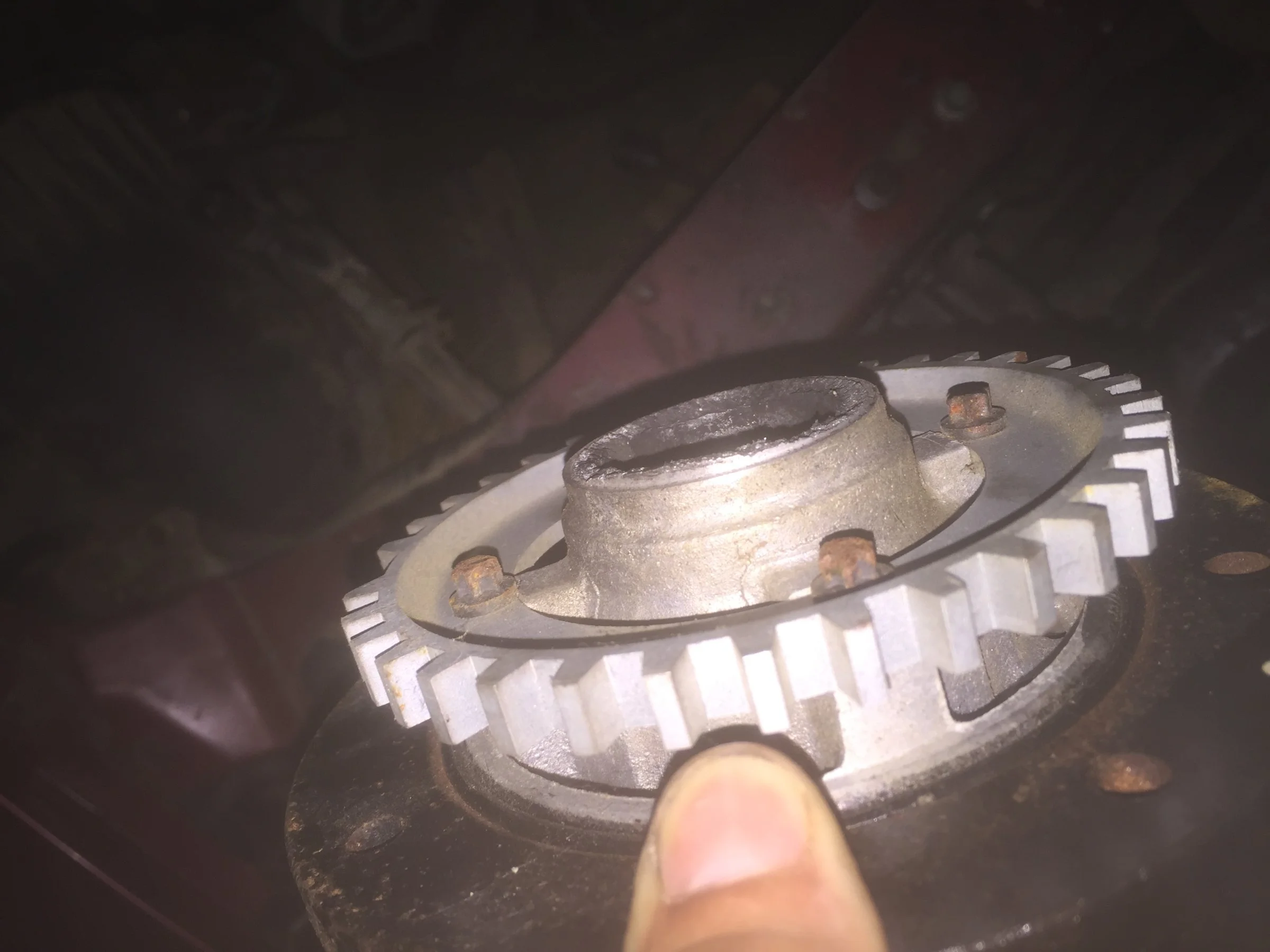

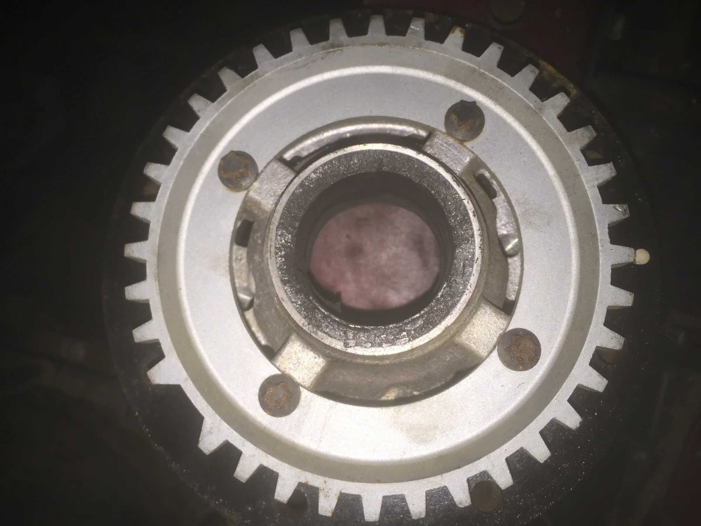

i recently bought a 94 Mustang with a 3.8 off a yard sale site for $500. I knew the car had been sitting for years and suffering no crank no start at the time it was parked. I knew I had my hands full when I bought it, but I like to have something to tinker with.

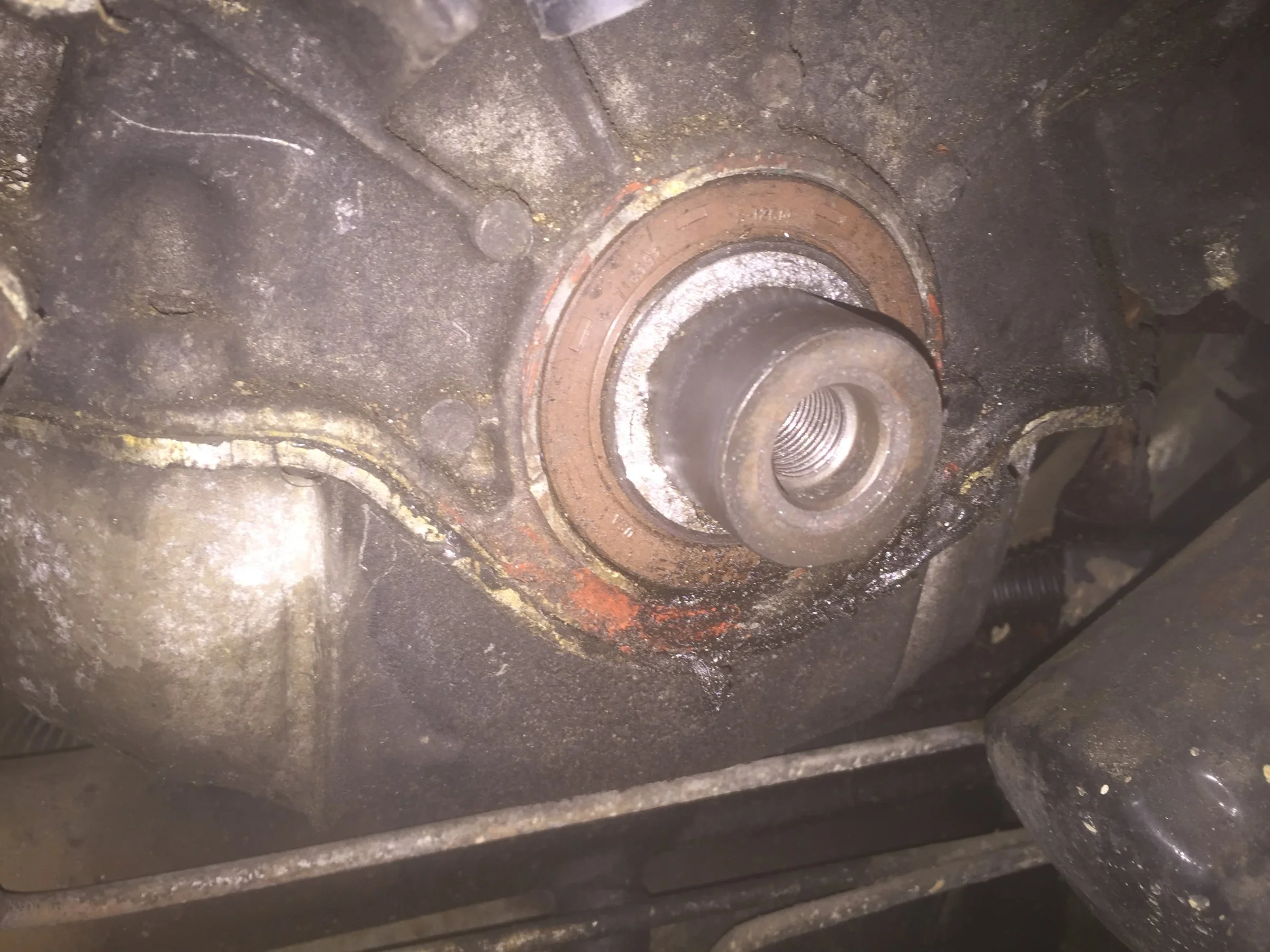

Anyway, I got it home replaced the battery and started checking the wiring and then decided to give the crankshaft a turn to ensure I wasn't wasting my time before I put the car on jack stands to get under it. I took off the belt and the harmonic balancer and pulley dropped, it was hanging in by what little shaft was left on the balancer.
Long story short I need to get the rest of that shaft out of the block, preferably without damaging anything else.
Has anyone experienced this? Any ideas?
Yes the baller shaft is broken off, part of it is still in the car.

I was afraid to manually turn the crank bolt to far without the balancer in place. I didn't want to strip the bolt. But, when the bolt got tight and I continued to turn some residual coolant came from the lower radiator hose so I don't feel like the motor is locked up
Best chance to get that off is to pull the timing cover off, and then see if you can get a puller behind it, or split it carefully to break it off.
Gott break the engine down to this point
Probably explains the no start condition. balancer broke
It used to happen a lot with explorers. Taking the front cover off is the best way.
That's actually a good sign....means it was probably running when it broke. Not a bad time to put a timing chain in it while you're there.
The other option is to weld a ring to the od of whats left of the balancer. Then put bolt in. Use 3 jaw puller to pull it off.
After closer examination youd have to pull cover as stated.
