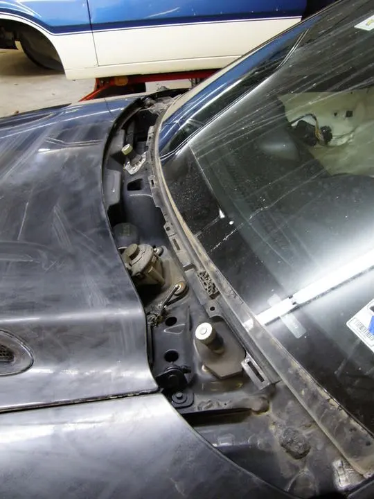

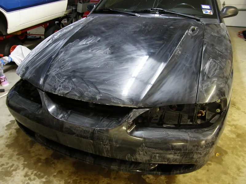

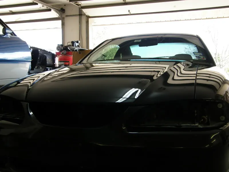

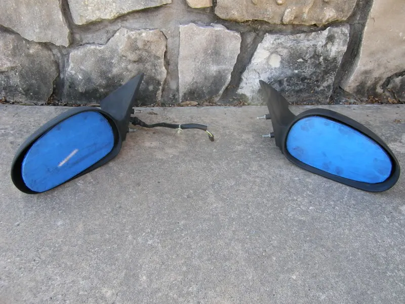

Ok, toe typing in progress!! Sorry for the suspense, I had to work last night. As I stated earlier, I wet sanded the whole car using 1500, then 2000 grit. Buffed with an electric buffer with 3M Rubbing compound, then with 3M's Performance finish followed with Meguiars Deep Crystal (whatever that means) system Carnauba Wax. Smooooooth as a baby's bottom!!! And yes, my arms were pretty dang tired. Also, the mirrors and cowl panel look great in flat black. The pictures I took with my camera are decent... I took some more creative ones with my moms d-slr. I'll see if I can get them and post em up later. The pics dont do it justice, however my front bumper sucks..

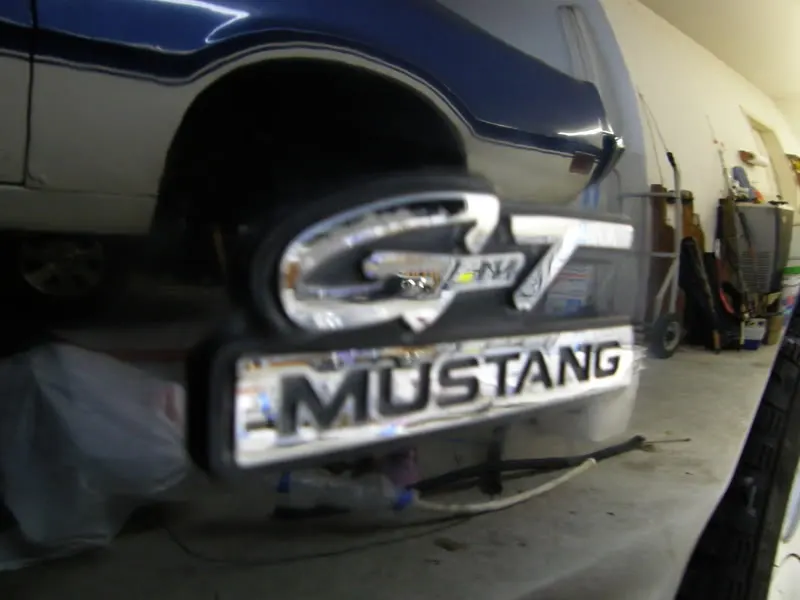

The beginning:

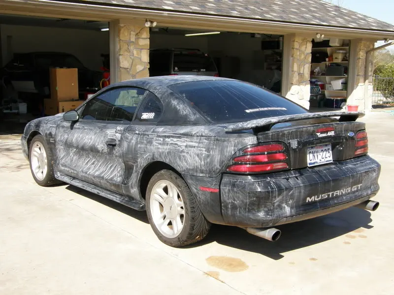

Everything wetsanded:

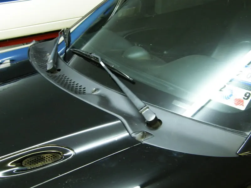

Cowl getting prepped for paint:

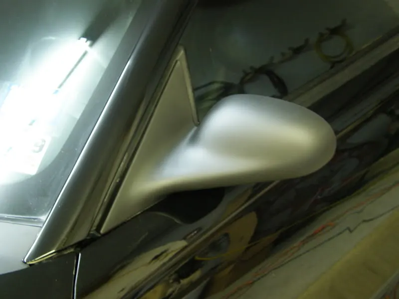

Mirror prep:
Painted cowl:
Painted mirror:

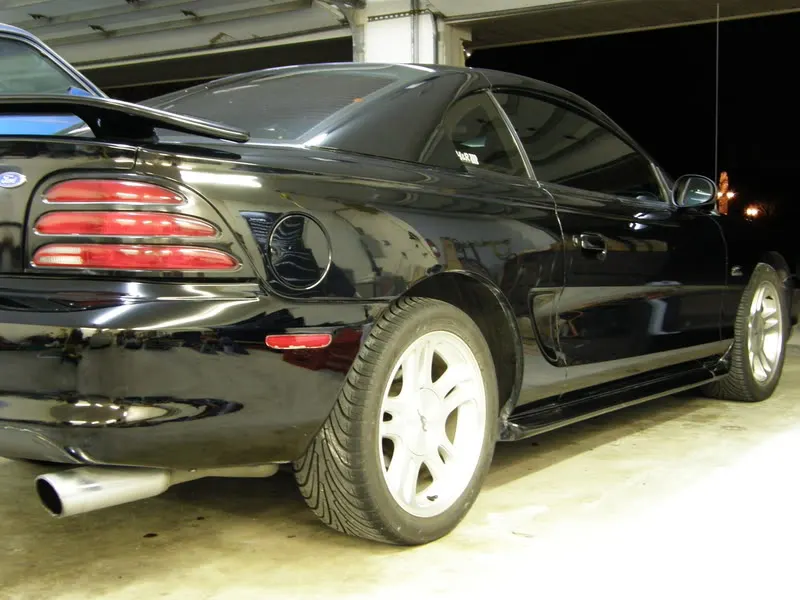

Nice deep gloss :nice:
Just like a mirror!
All done!
Victory!!

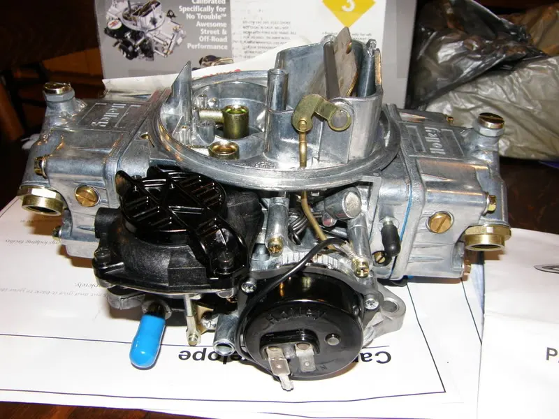

This came in the mail the day I finished, what a wonderful day it was... This will be going in my 68, on a future 351 Windsor. Its a 670cfm vac secondaries with elec choke :D
Daaayyyyyymmmnnn skippy :nice:
