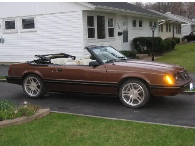

before

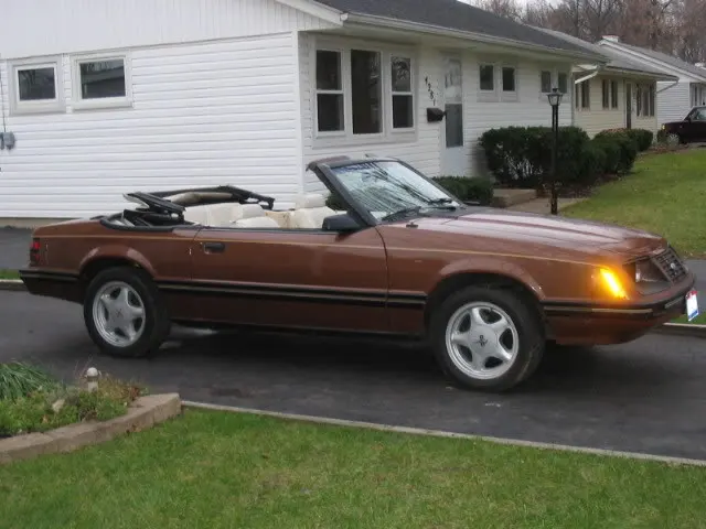

after the wheels and lowered a bit.
whats the back spacing of the split 5's?
im getting better with my ms paint skills ant I :banana:
