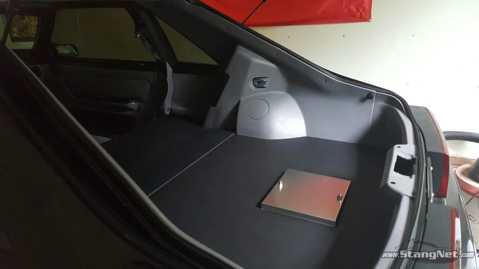

killer5.0
5 Year Member
Oct 8, 2009
725
83
59
Jul 27, 2016
#15
  • Jul 27, 2016
  • #15
Thank you..its a taylor box
