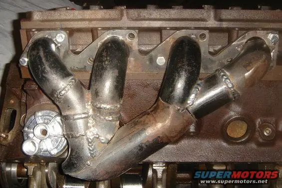

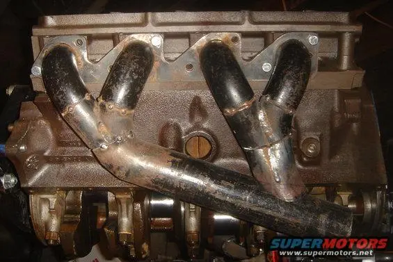

It can be done. Here's a mockup of a turbo Clevo in a '69:
You just have to make your own. Here's the driver side:
Here's the passenger side:
Is a Windsor narrower than a Cleveland? I believe it's not. I know the Windsor's deck height is taller (9.5" vs. 9.2"), but the Clevo heads might be bulkier where they come closest to the shocktowers. Anyway, Clevo's fit in '65-'66's.

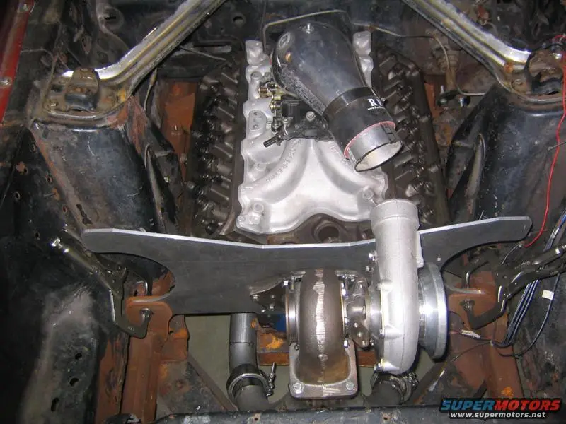

A little eye candy for you turbo mustang lovers. Not sure if he is a member on here, but he hangs out on the VMF alot. Goes by the username R100RT. Here are his specs and a pic of the engine bay. Did it all himself and looks damn nice. :nice: Running twin Garrett T3's and hasn't dyno'd the motor with any crazy psi, just 10.
TT331FB - T3/.6/.63 turbos, Spearco intercooler, 302/331 Mexican Block,AFR 185 heads, 3" MAF, 70mm TB, 50# injectors, Tweecer, Track Heat intake, Comp cams roller blower grind,DIY-WB, Yokogawa video display,T-56 tranny, 9" 3.5:1 Traclock, 4x disk brakes, TCP most everything, shelby roll bar. Dyno 522FWHP/587FT-Lbs @10psi boost :hail2:
Nice setup! 522 flywheel ~443 rwhp assuming 15% loss. Should be quite durable and a BLAST to drive...wish I could settle for that little power, though! I assume he notched the shocktowers?
