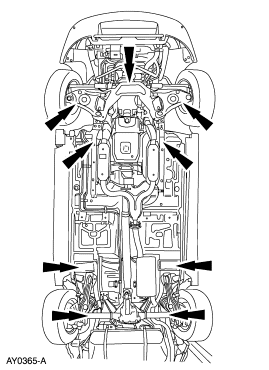

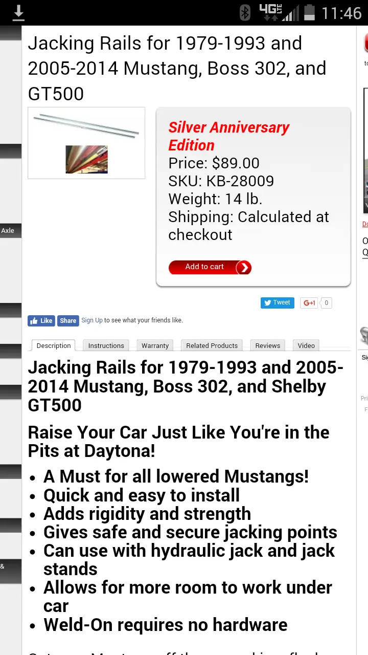

I slide the jack under the edge of the front control arms from behind the wheel. I put the jack stands under the control arm bushings. I never jack mustangs up at the pinch welds.
One day I'm going to buy a set of these...

Here's the jacking points....this is a fox mustang with a v6
