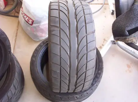

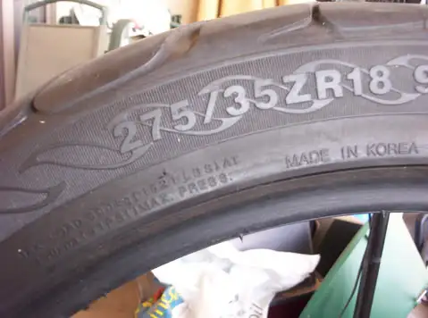

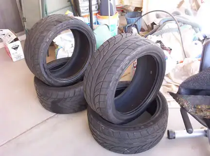

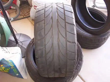

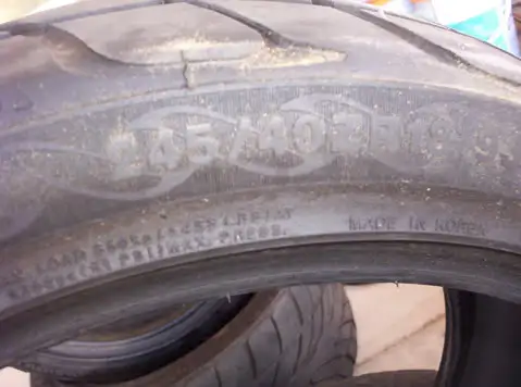

Probably a good start is just getting an alignment. If your toe is off by alot it can cause you to veer in either direction and might be causing you to track more. And new tires would help too probably...is the tread on your tires now worn in a certain pattern?
Heres a couple pictures of my tires before I put them on, not sure if this will help at all.

I am lowered, I have H&R Sport springs w/ uretane isolators. I dont really think its getting caught in a rut unless they are really really tiny ruts because the roads for the most part are pretty smooth out here. It definetely does just jerk me though. I think I will take it down to discount sometime soon and ask them and see if maybe they know what could be causing it. I dont think its anything with my suspension because it started happening right after I put on the new rims and tires. I'm just trying to figure out if there is anyway to fix this without having to get rid of my 18's.
