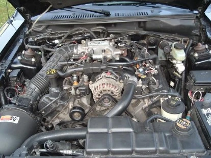

this is what i believe needs to attatched to the new pipe
