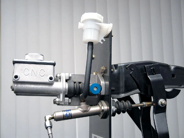

Jay,
I'm doing a T5 conversion in my 67 with power brakes.
Is this the shim you were referring to?
I've got a Midland clamp-type booster on mine.
So what I'm gathering is that this will angle the master cylinder in such a way that it clears the booster, presuming that I use this style with a remote reservoir?
If so, and it's angled down, then I guess the rod to engage it to the clutch pedal will have to be at the same angle. Should I then just drill a new hole in the clutch pedal that is at the projected line of the MC to attach a rod to it?
Thanks
Yes that is the shim for the master you have showing.
The bellcrank booster would clear the master even if it wasn't shimmed. This shim it to get the correct angle on the clutch push rod to eliminate side shear and in turn premature failure of the clutch master. There's no way to run a straight shot at the master with a straight rod because the column gets in the way. You use the original hole.
Yes we've come out with complete bracket systems for the cnc master and slave. The shim is available separately for those with the original JMC kit using the master shown. These were originally welded with an angle for these kits.

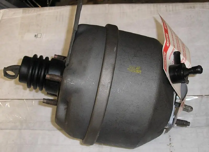

Great pics Markus.
I've got the clamp-style Midland booster:
I understand that this is the same diameter (7") as the Fox booster like you have.
It looks tight, but do-able.
