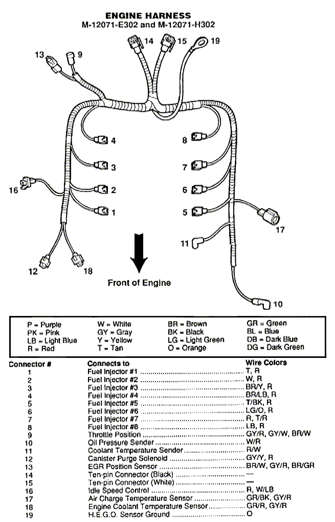

ahh, you dont say. i think i might have taken that off. kinda by accident. i'm not running any smog equipment or a charcoal canister, and when i took off a hose on the front of the intake manifold(the one that goes to the charcoal canister) i also unplugged a plug that has a connection near the injectors. possibly the coolant temp sensor. maybe thats my problem?
~Steve
i thought it went to plug 12, but maybe i unplugged connection 18. i'll double check this when the sun comes out to play.
~Steve
ok, i went outside to check this therory, and it seems though the coolant temp plug is pluged in. it is going right into the top of the lower manifold or something right there. do you think i need a new sensor? the clip that holds it down was busted off. it slides on and off. but i dont think that would be the cause of the problem.
