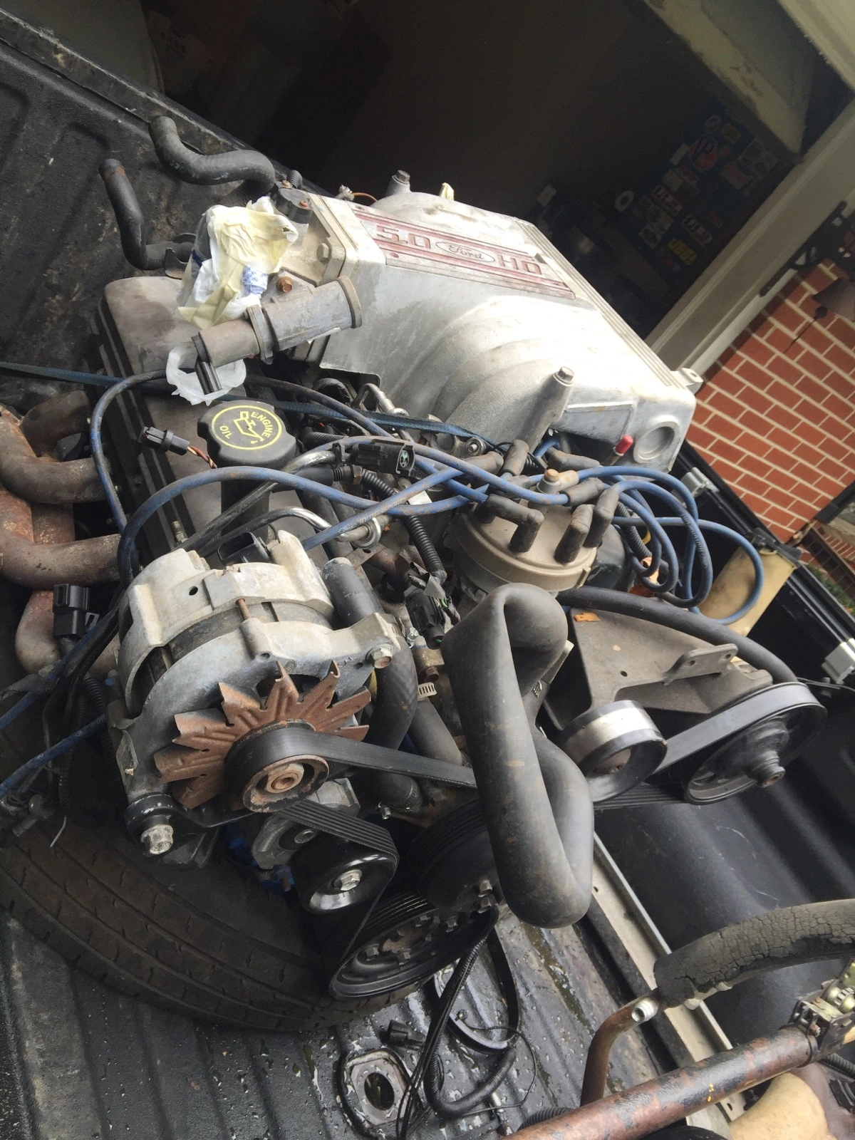

- Complete 1988 mustang Gt 5.0 engine Excellent condition recent refresh GT40 explorer intake BBK shorty headers $750
The guy said he pulled it last week
I think he's high on the price. Problem with Mustang engines is that you have to assume it was run hard. There could be a lot wrong with it that you won't know about until you break it down. Most explorer engines weren't run that hard and you don't see worn rings/ bearings as much.
