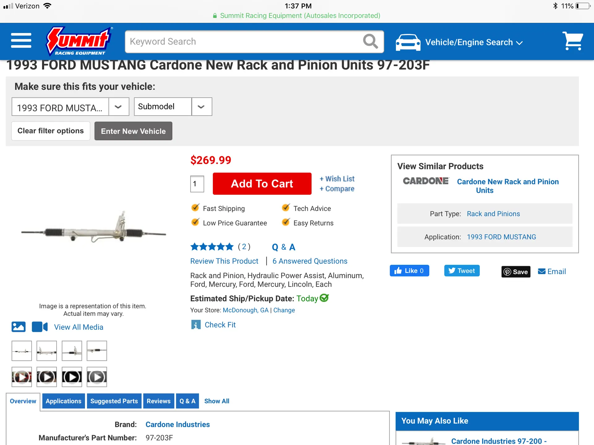

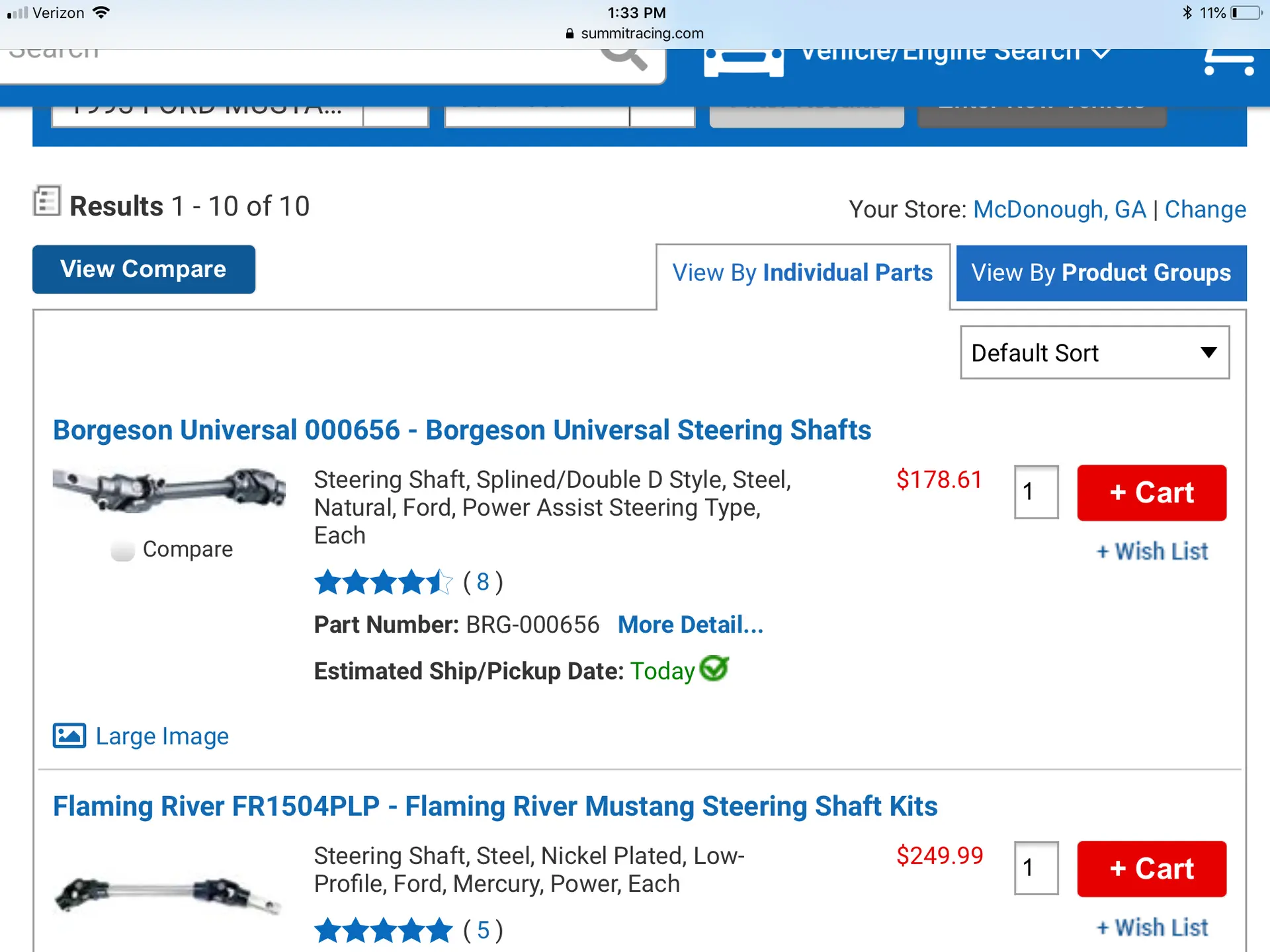

ebone84 said:
I’m looking to buy a rack and pinion and steering shaft ... is it 15 to 1 ... and if you don’t mind did you buy it online if so from what company..... Thanks
This rack is 3 turns lock to lock new by Cardone in stock at Summit Racing

Thanks..... I just wanna make sure I get the right rack/ Pinion and steering shaft thanks again

3 turns lock to lock is the 4-cyl rack when talking about power racks.
The sport rack is 2.5 turns (2.25 turns in the 91-93 due to rack limiters) for a 15:1 ratio.
Honestly, if you are changing the rack and the steering shaft, do not buy a fox unit. Upgrade to an SN95 rack (02-04 GT or 03/04 cobra preferred) and don't look back. It's a performance upgrade
Steering Shaft Assembly, SN95 Power Steering Rack, 1979-93 Mustang
SN95 Steering Rack Upgrade for Fox Mustangs

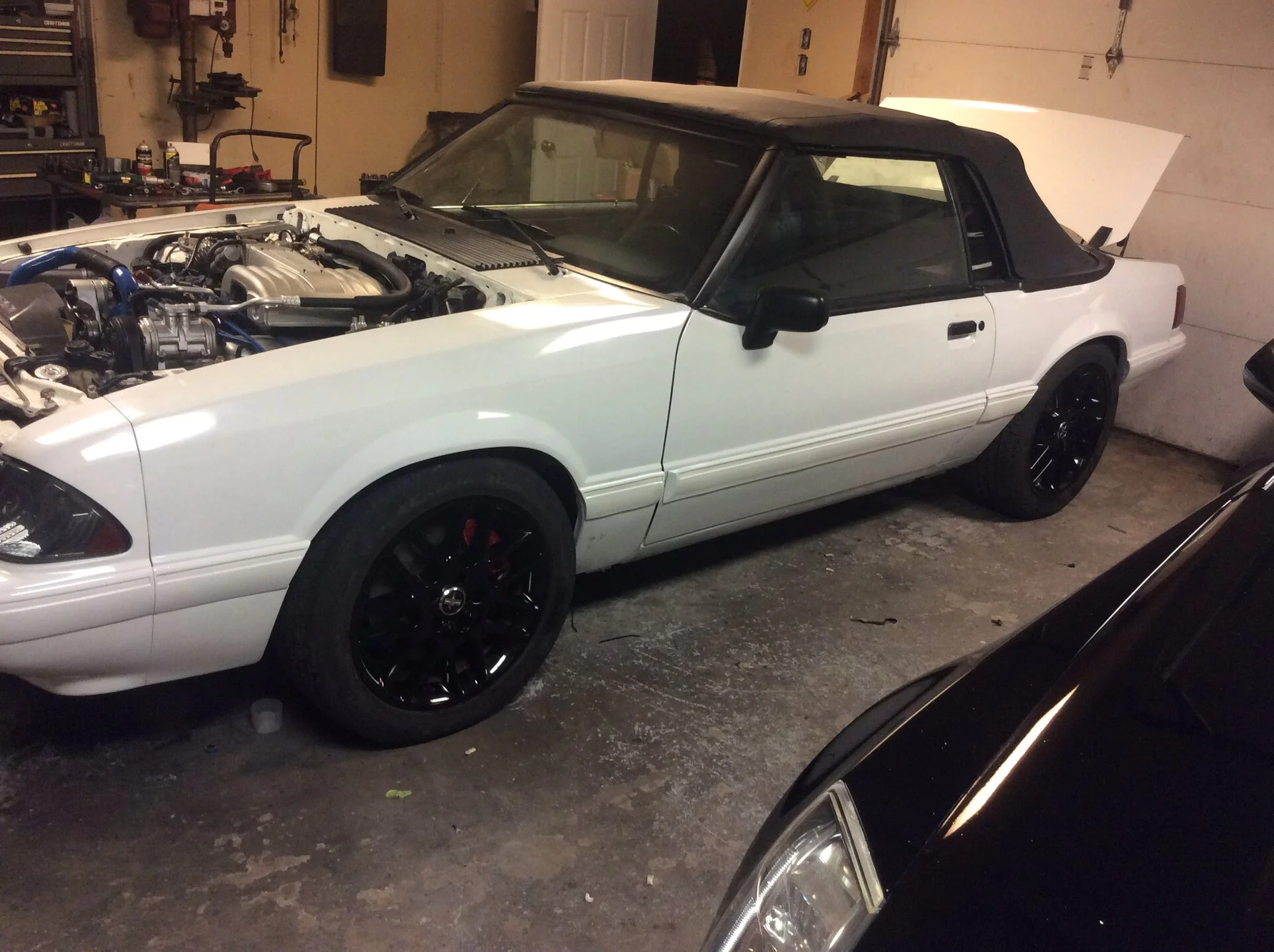

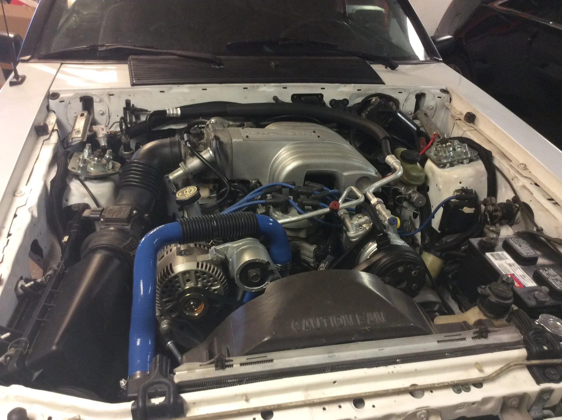

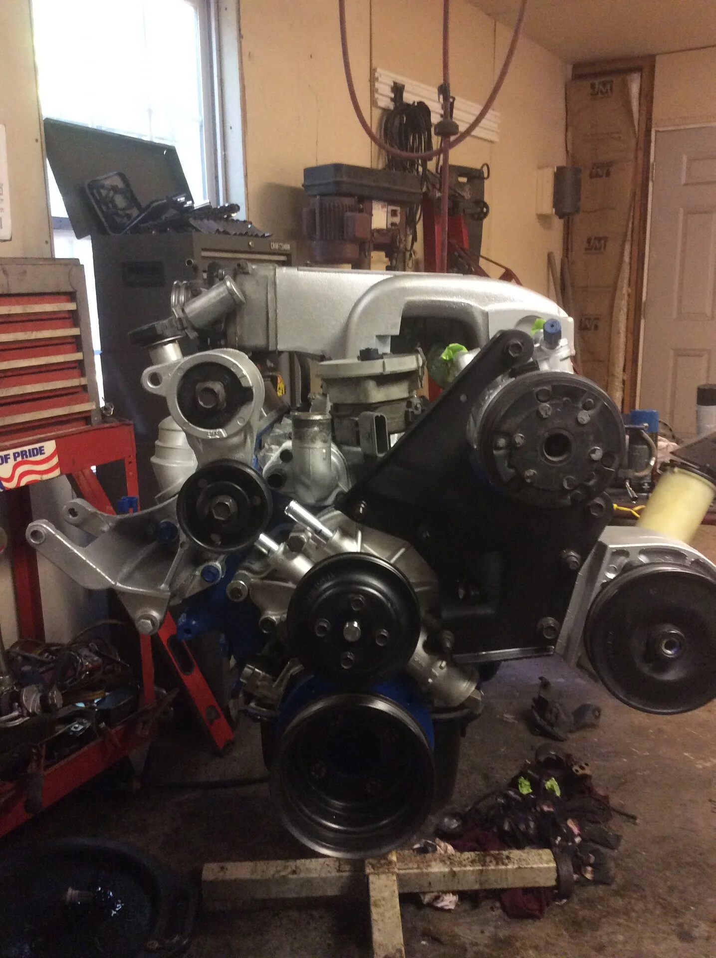

After a tough decision to put engine back in car stock, due to lead times at the machine shop and some indecisiveness on what exactly the end game will be for this engine. The engine is clean, painted, timing chain replaced and re sealed, brakes are plumbed and blead.
Just waiting on my 5 speed transmission and aluminum drive shat to show up so I can drop engine back in the car.
The next quest will be to decide on the right wheels
Reactions: Monkeybutt2000, General karthief and Olivethefet

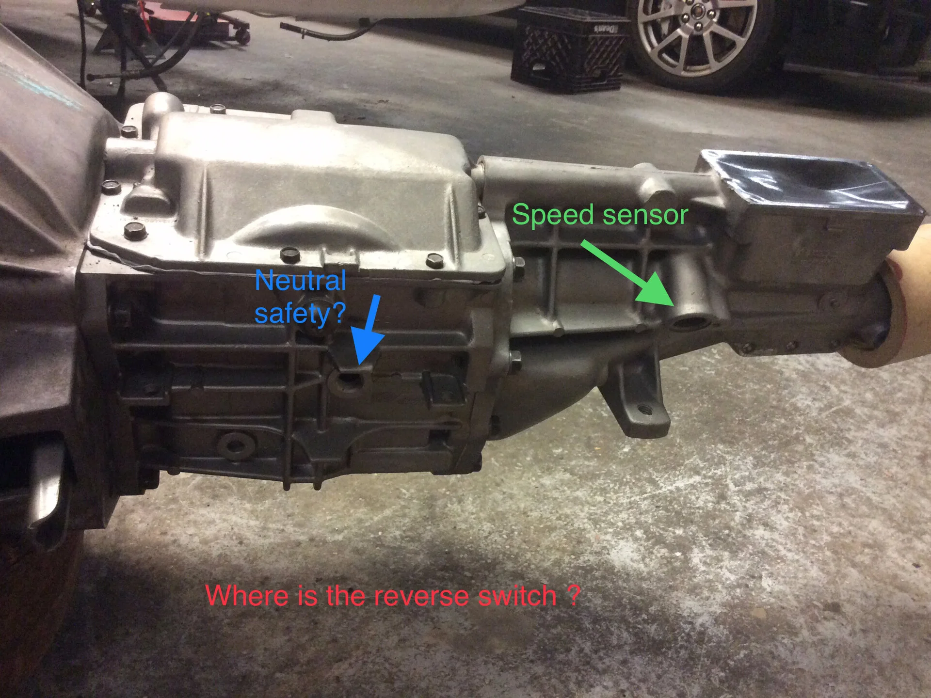

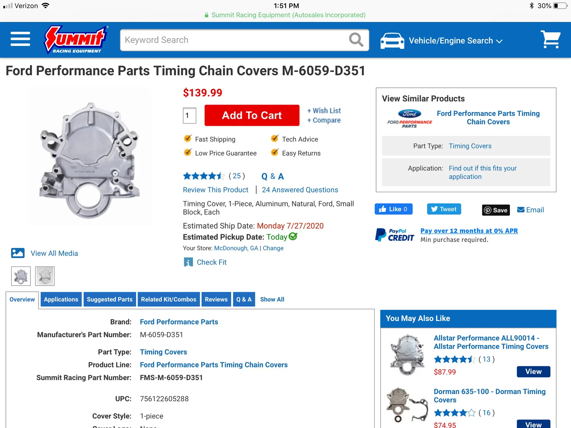

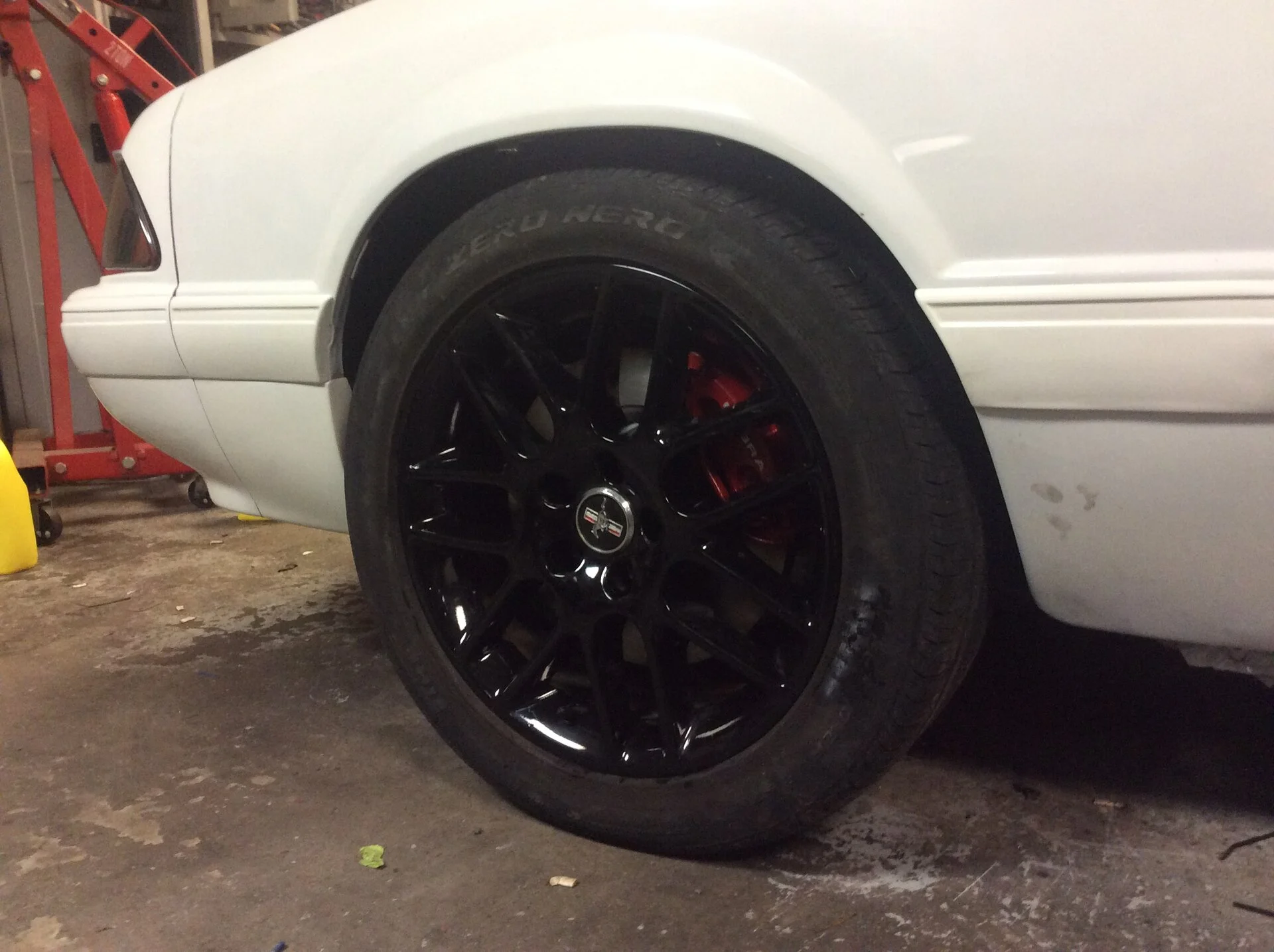

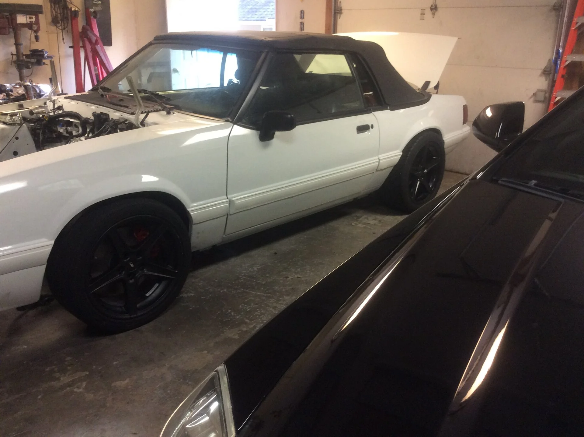

Almost ready to reinstall engine and transmission. Tried some 18” x 9” fronts and 18” x 10” rears with 25 mm offset close but didn’t work could not roll fenders enough, will be going with 05 to 14 style wheels with 45 mm offsets.
Also got a few questions

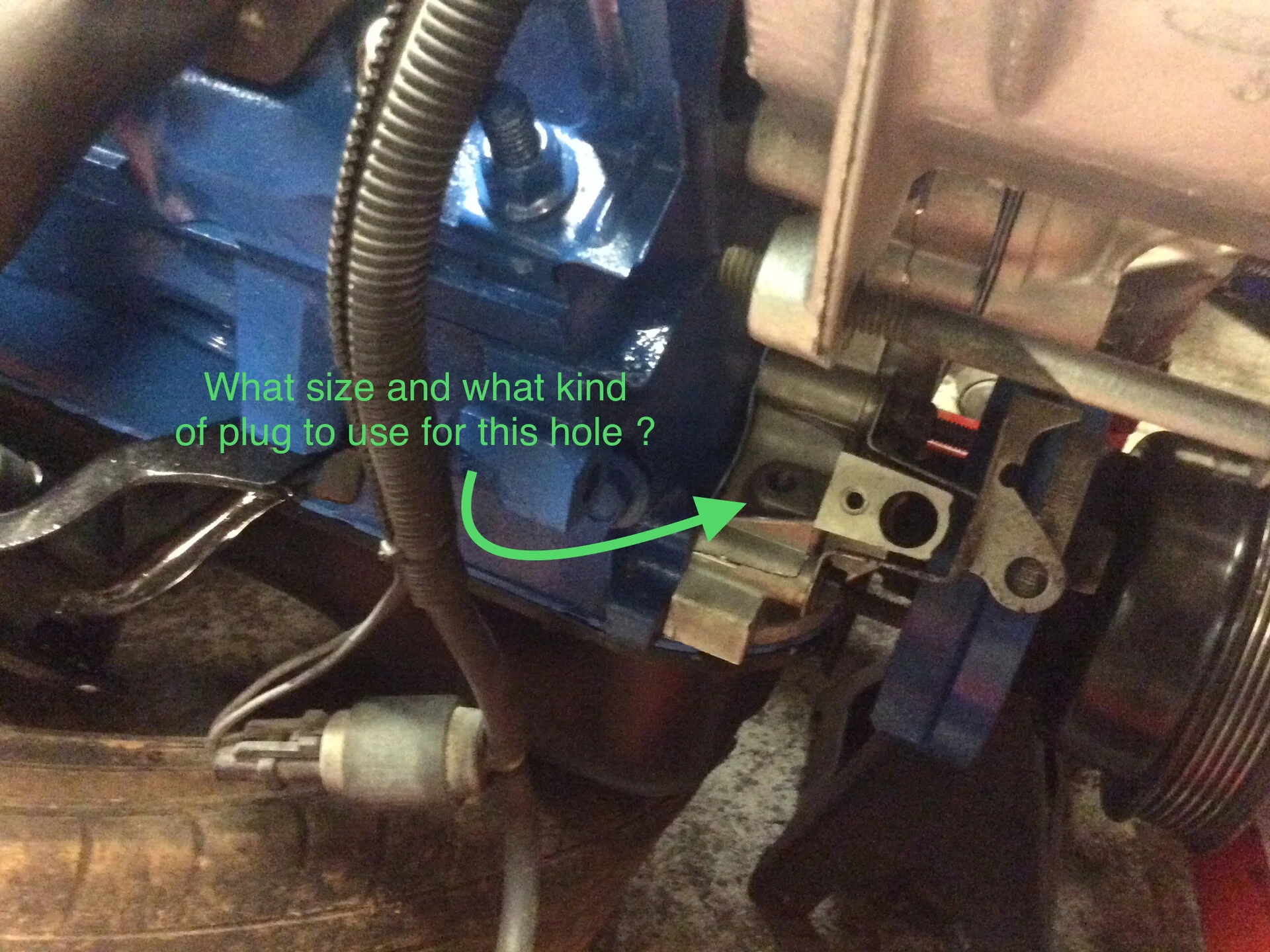

(1) Dose anyone know what kind / size plug I can use for hole in timing chain cover shown in picture ?
(2) I am using a transmission case from a 1987 where is the neutral safety switch ( if it even has one ) and reverse light switch ?

That hole in the timing cover should have threads in there and is for the little bracket that the wires for the starter hang on, not open to the inside of the cover.
Mustang 5.0 timing cover right?
Rogie Stone
Feb 21, 2016
41
59
28
Aug 23, 2020
#30
  • Aug 23, 2020
  • #30
Not threaded and it appears to be a hole all the way to oil pan.
This is timing cover.

Answered in another thread?

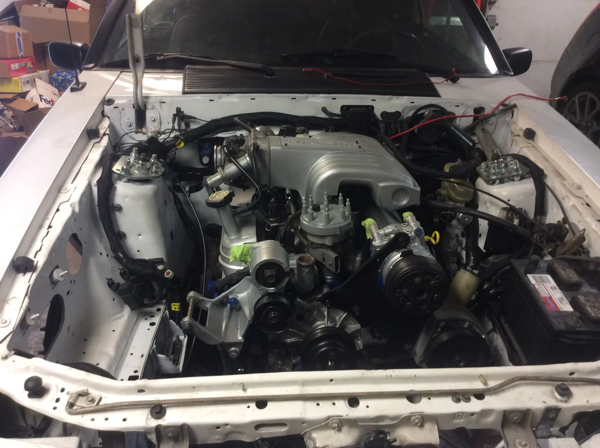

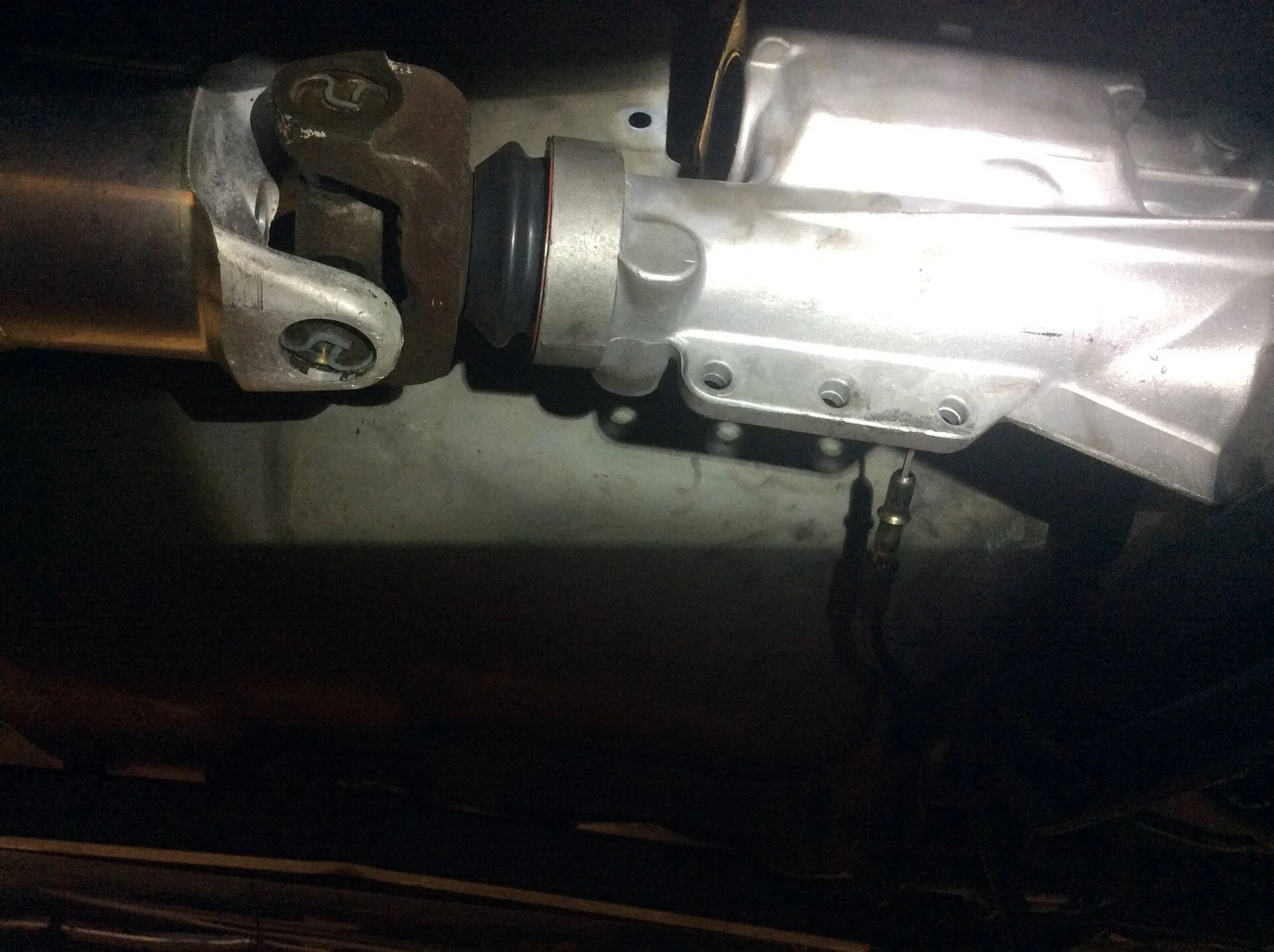

Engine and transmission in.
I used rearward holes in k member for the motor mounts. This allowed me to use the auto transmission mount and put shifter in a better position, but I am a little concerned with drive shaft length. After jacking rear diff up to ride height the drive shaft yoke never touches the transmission tail shaft ( which is good ). How much min clearance can I have from the end of the transmission tail shaft to the drive shaft yoke at its tightest point ?

Engine seems to be running well. Just need wheels before I can take it on test drive. Hopefully the stock engine will do while I source a more suitable power plant.
Reactions: Monkeybutt2000, General karthief and Potomus Pete
Rogie Stone
Feb 21, 2016
41
59
28
Sep 17, 2020
#34
  • Sep 17, 2020
  • #34

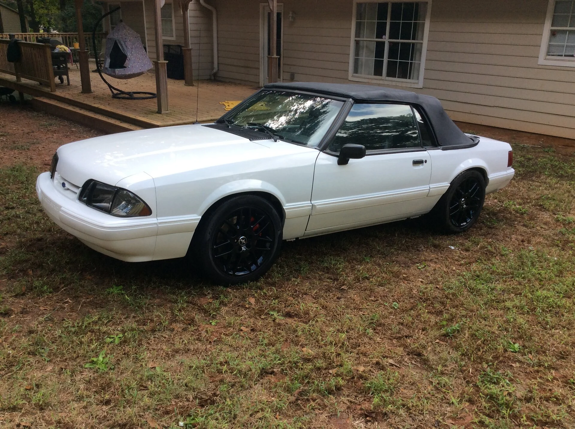

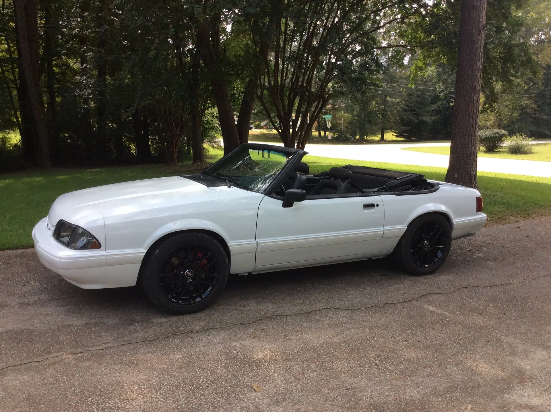

Found wheels that fit. Will adjust for better stance once front end aligned and will probably go with a little lower profile tire.
Should be able to take for first test drive soon.

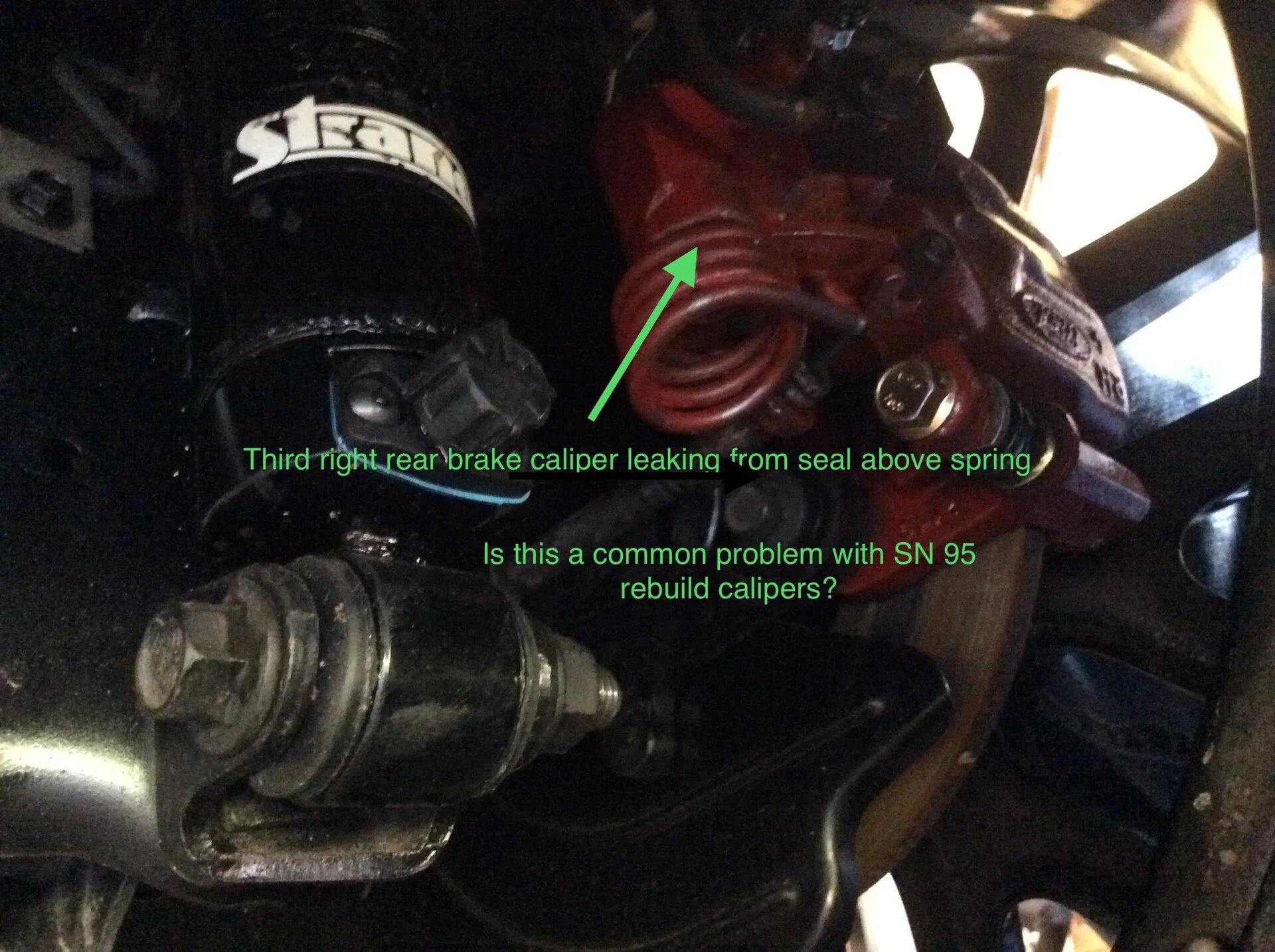

Took car on first test drive today, needs alignment, but other than that only problem is right rear brake caliper is leaking. This is the third rebuilt caliper I have installed, the first two leaked as soon has applied brakes with the engine running the power booster. Is this a common problem with rebuild SN 95 rebuilt calipers?
