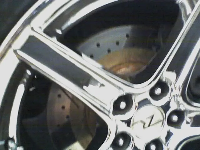

All i have is my camera phone for pictures right now..but you can see what im talking about..it makes the car look so ugly.

Sadly, yes, that is normal. Here's what I did to my Cobra brakes. Go to an autoparts store, pick up some hi-temp brake caliper paint. I picked black. Clean off the rust, then paint them. Not too heavy of a coat, just enough to cover. And use light coats. Make sure they're dry before reinstalling them.
Cheaper than sending them off to be coated.
