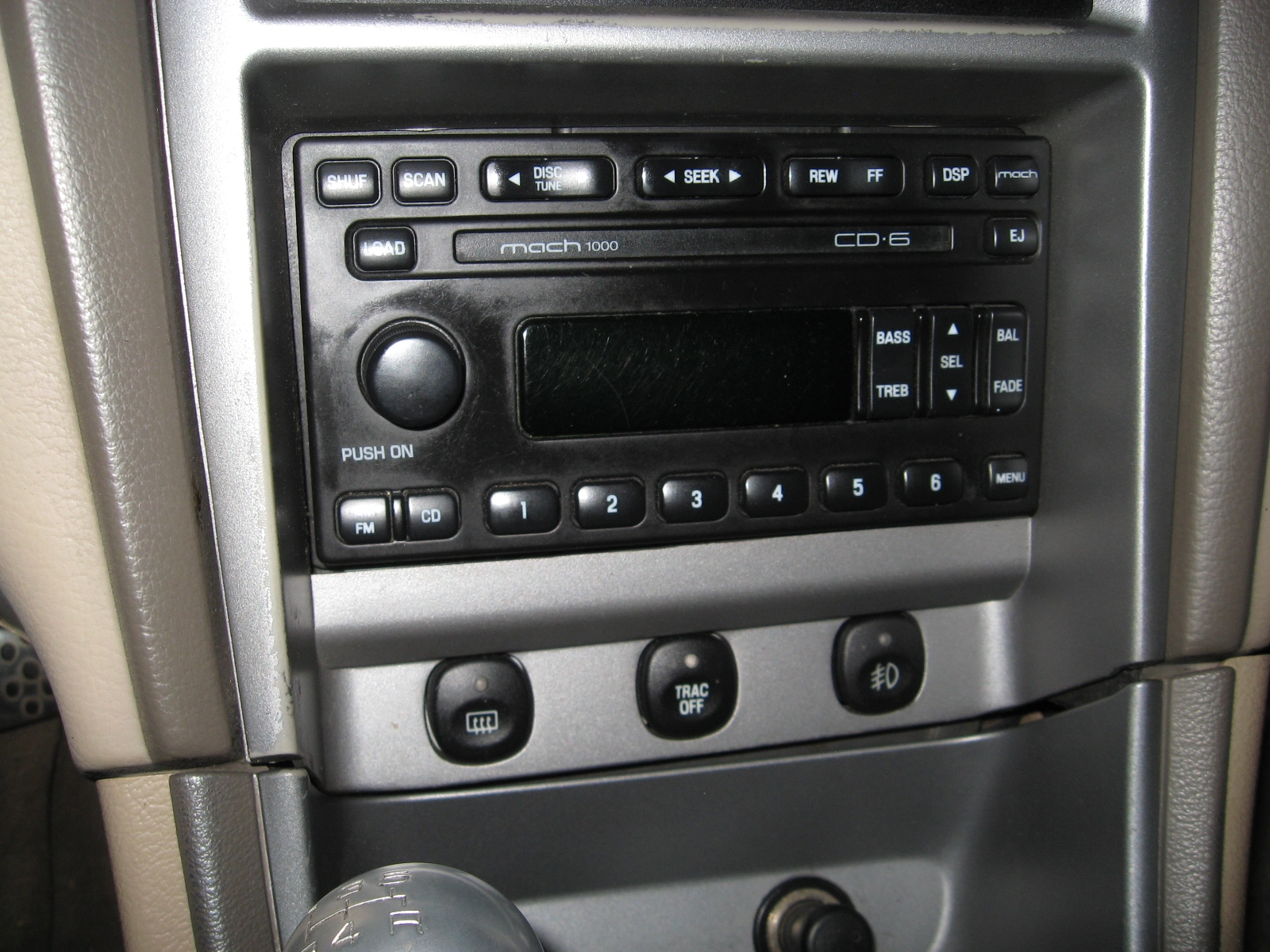

Just bought a 2003 GT with mid range speaker issues MACH 1000
Cartel
Aug 24, 2009
22
This car has the mach 1000 in it and the car smells of burnt PCB
I bought it knowing this.

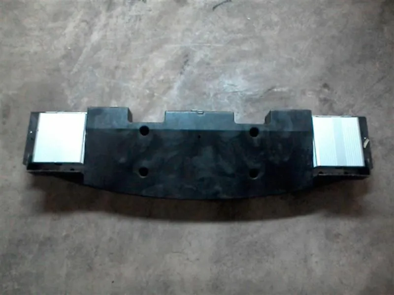

OK more digging and it looks like the door "woofers" and package tray "woofers" are powered by 2 amps that are bolted to the rear package tray and are not related the the mach 1000 amp rack.

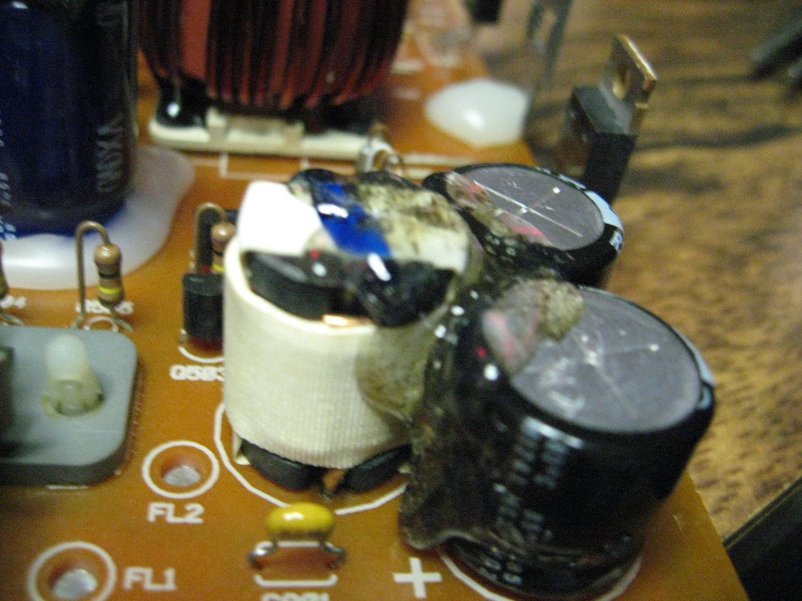

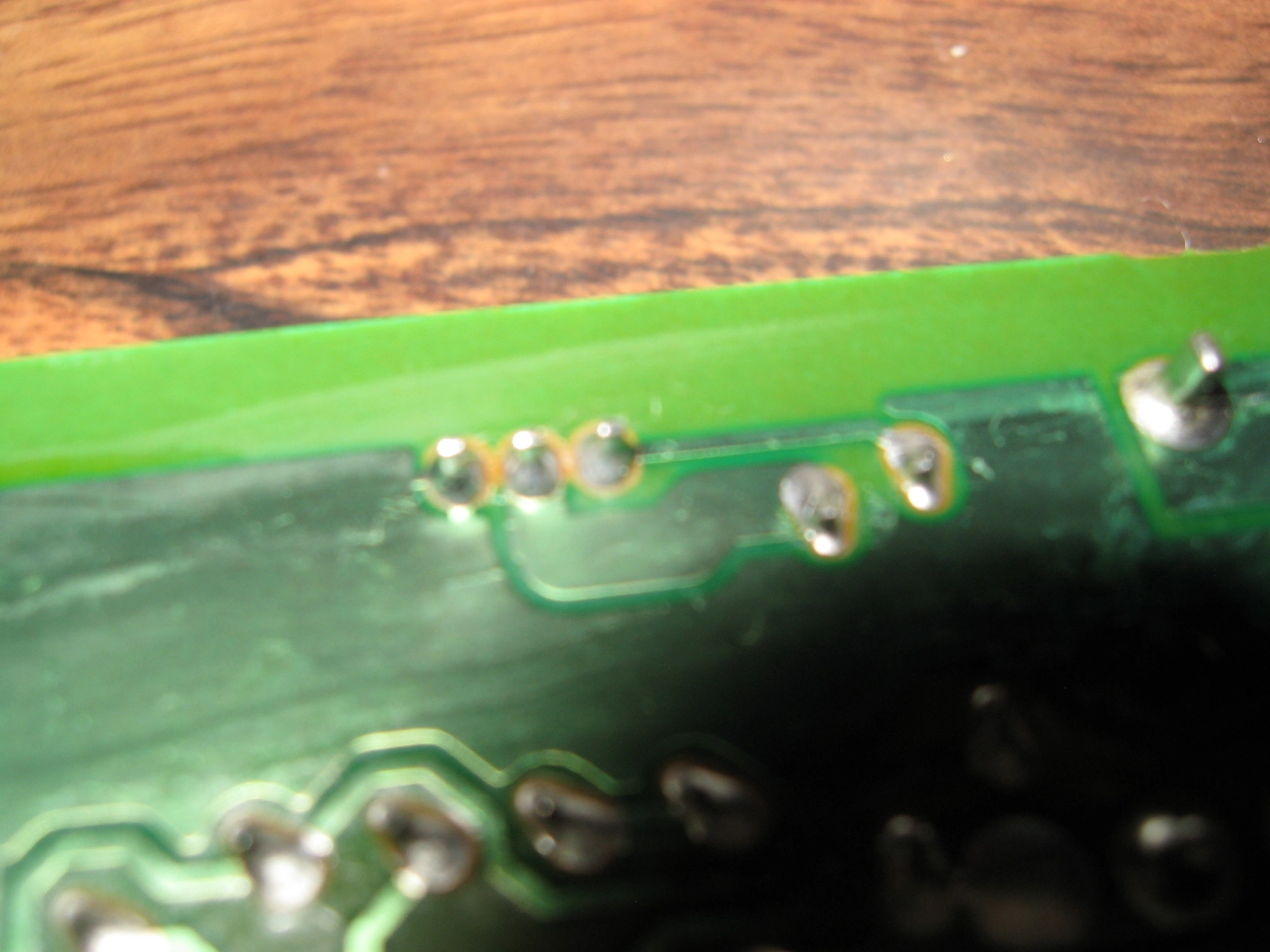

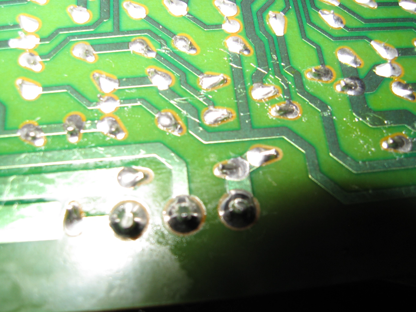

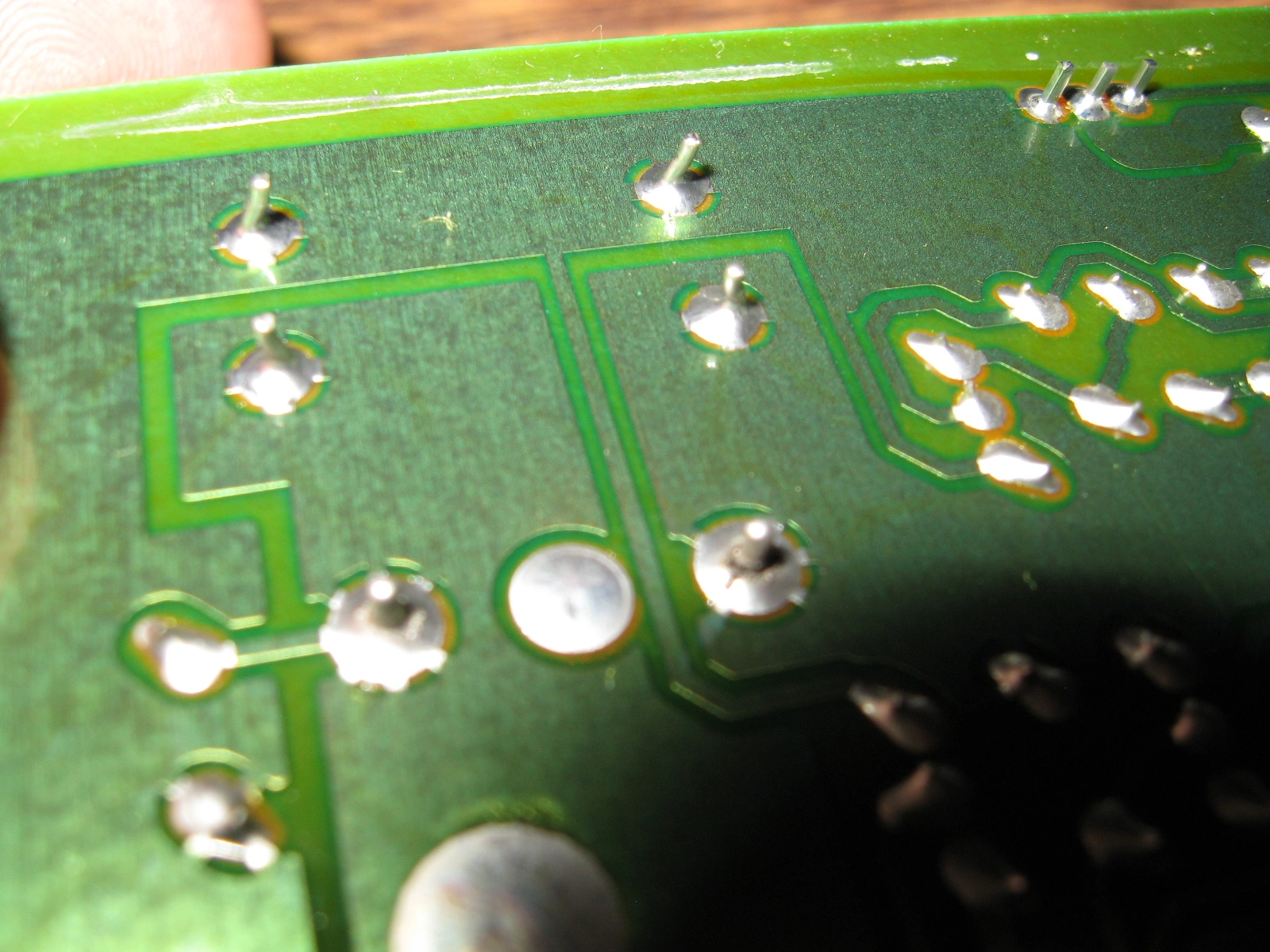

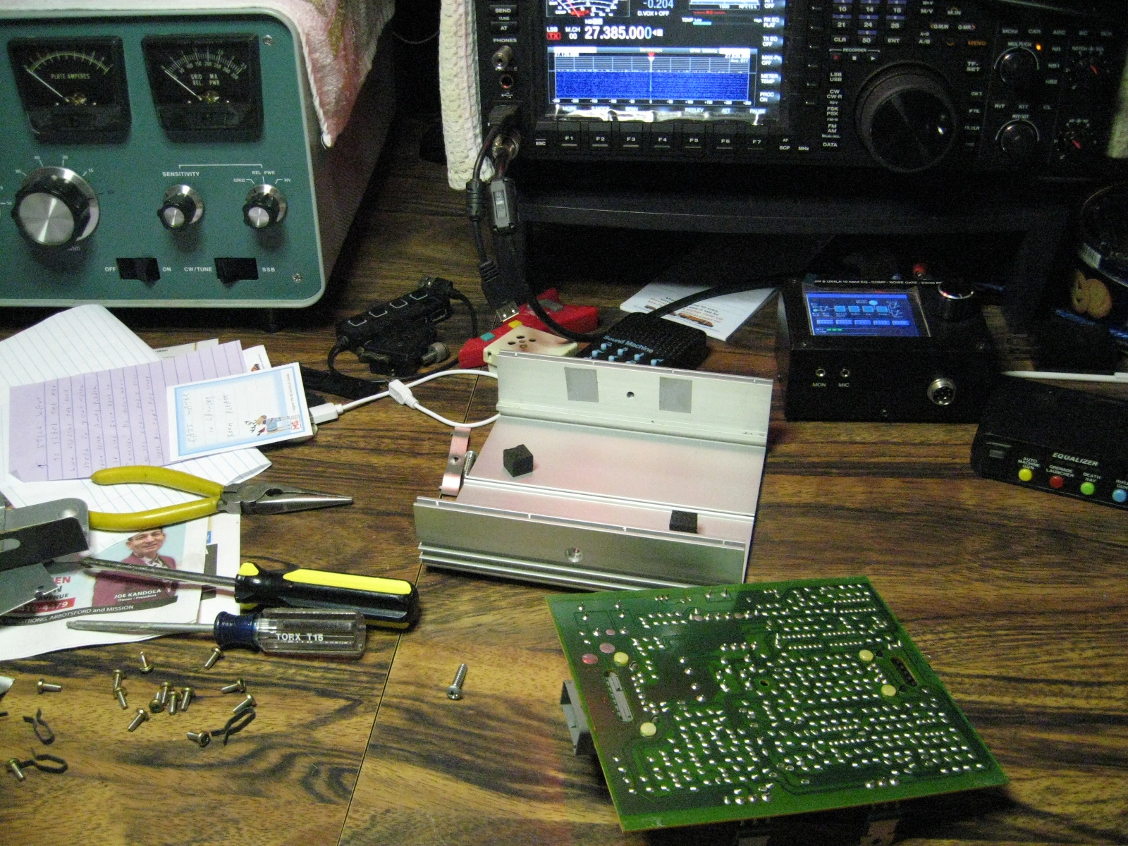

Today I crawled into the backseat and trunk and tested the voltage on the amps on the parcel tray which would be the mach 460 amps.

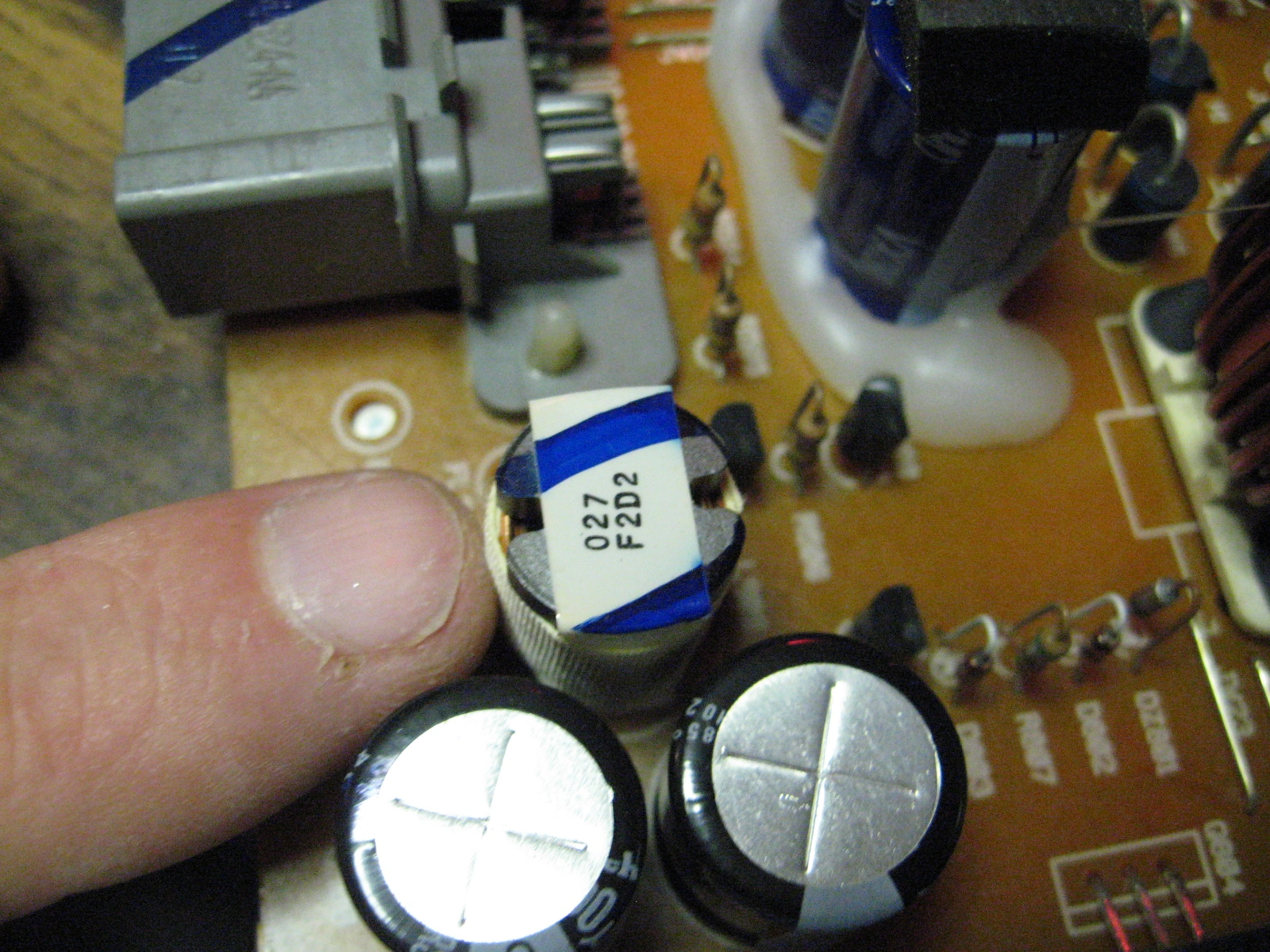

I tested the violet wires for 12v and they were good and I tested the small plug with 3 wires, 1 wire has the 5v and another 6.83 so they all were getting voltage. I tested the green/black for ground and they were good.

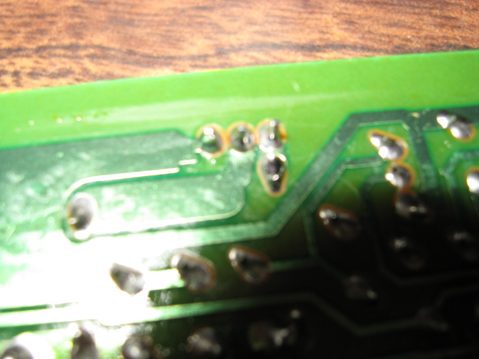

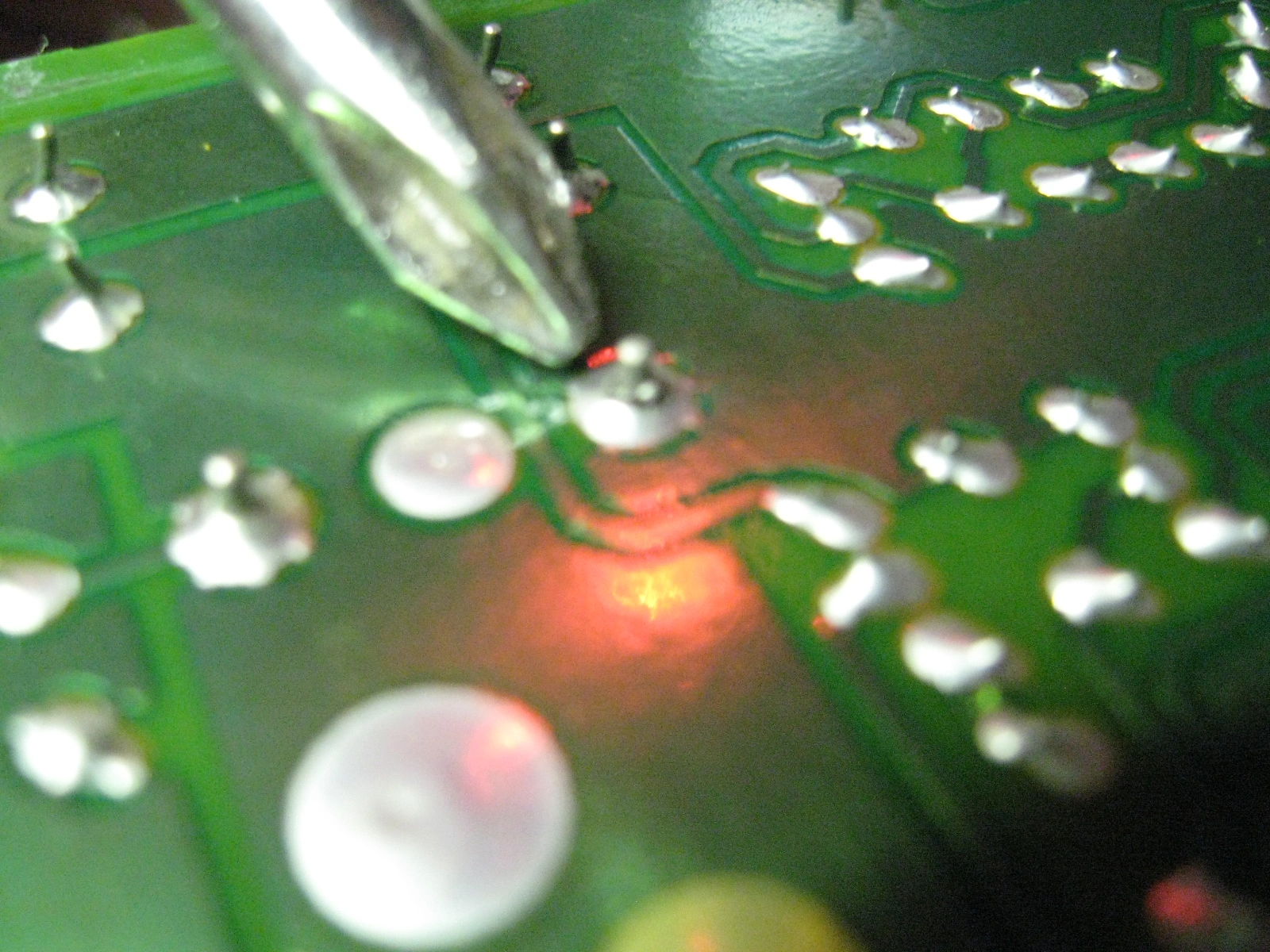

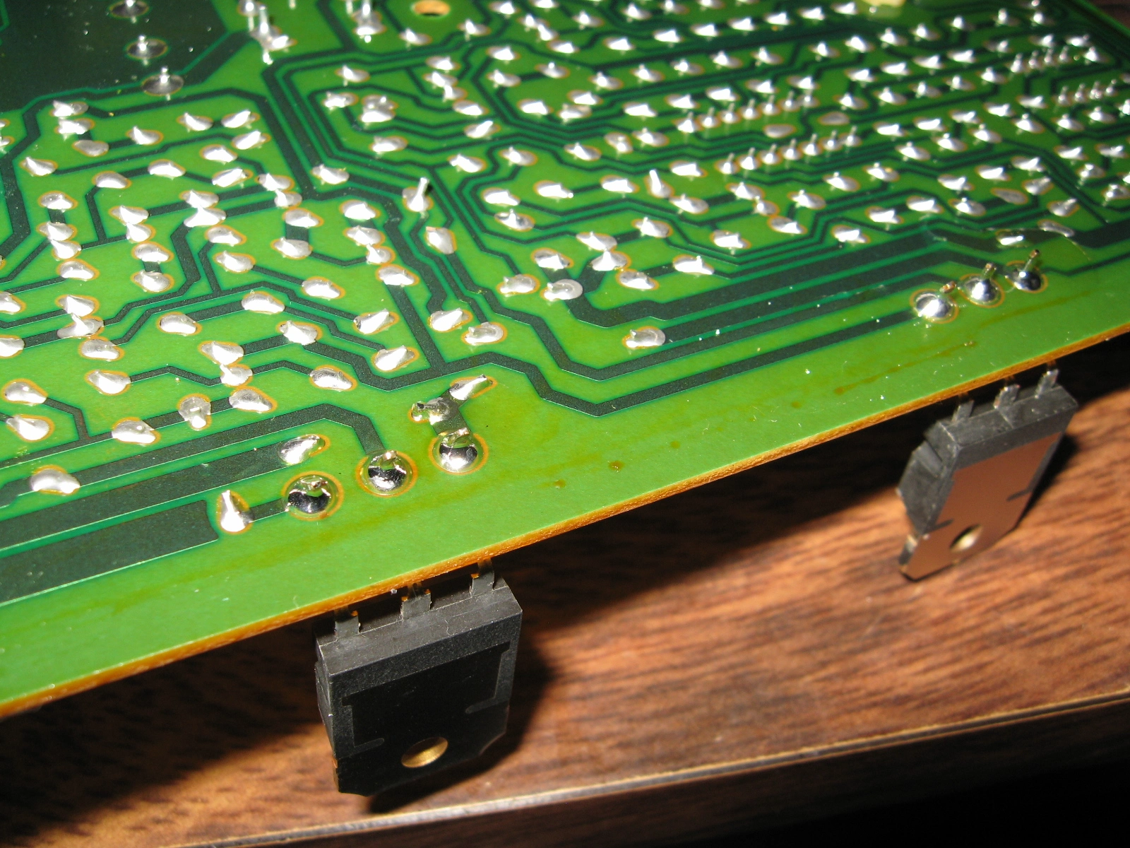

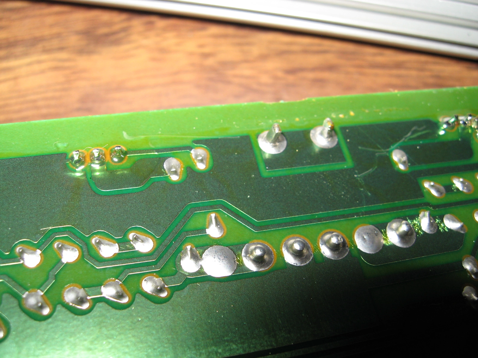

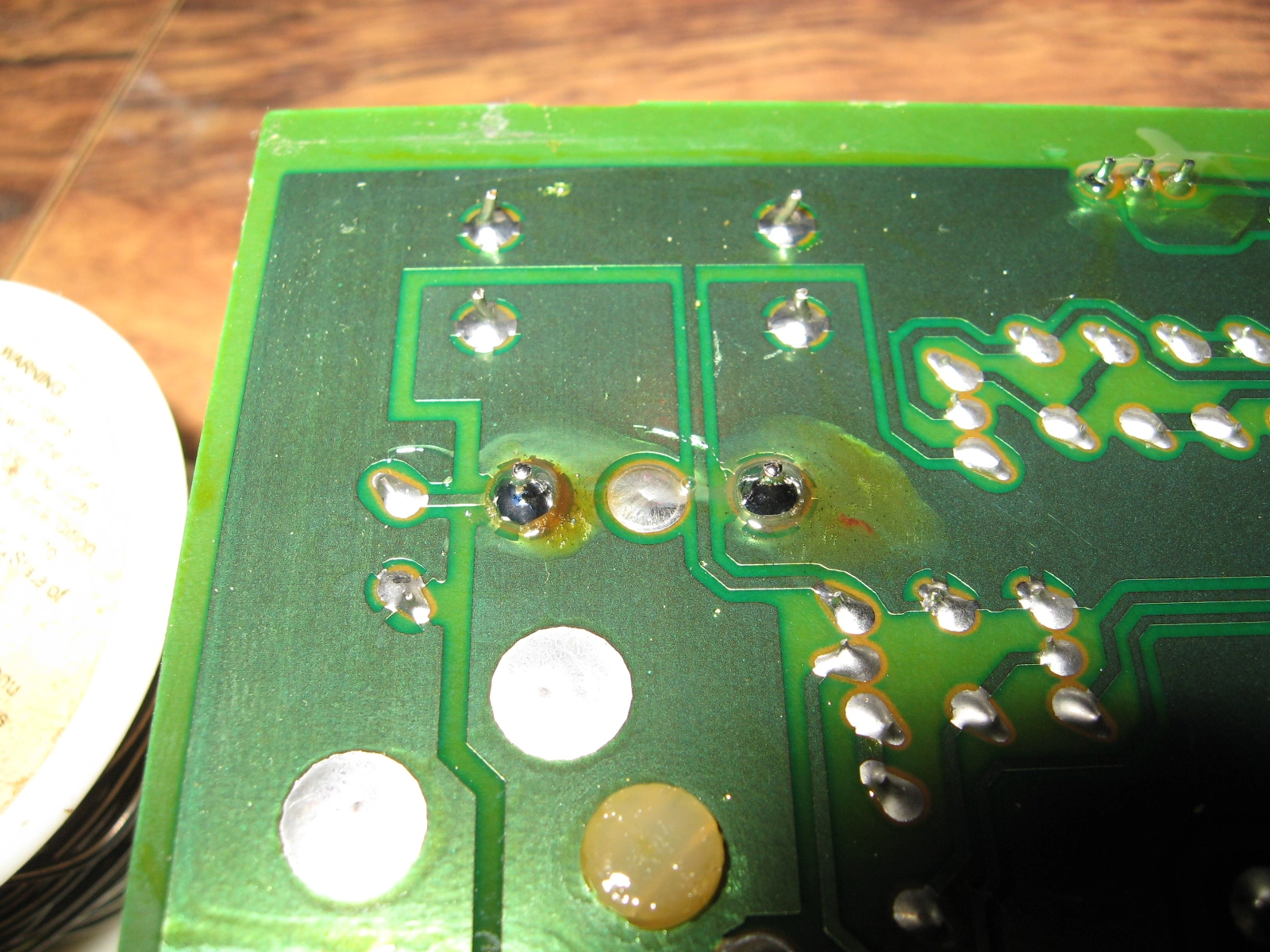

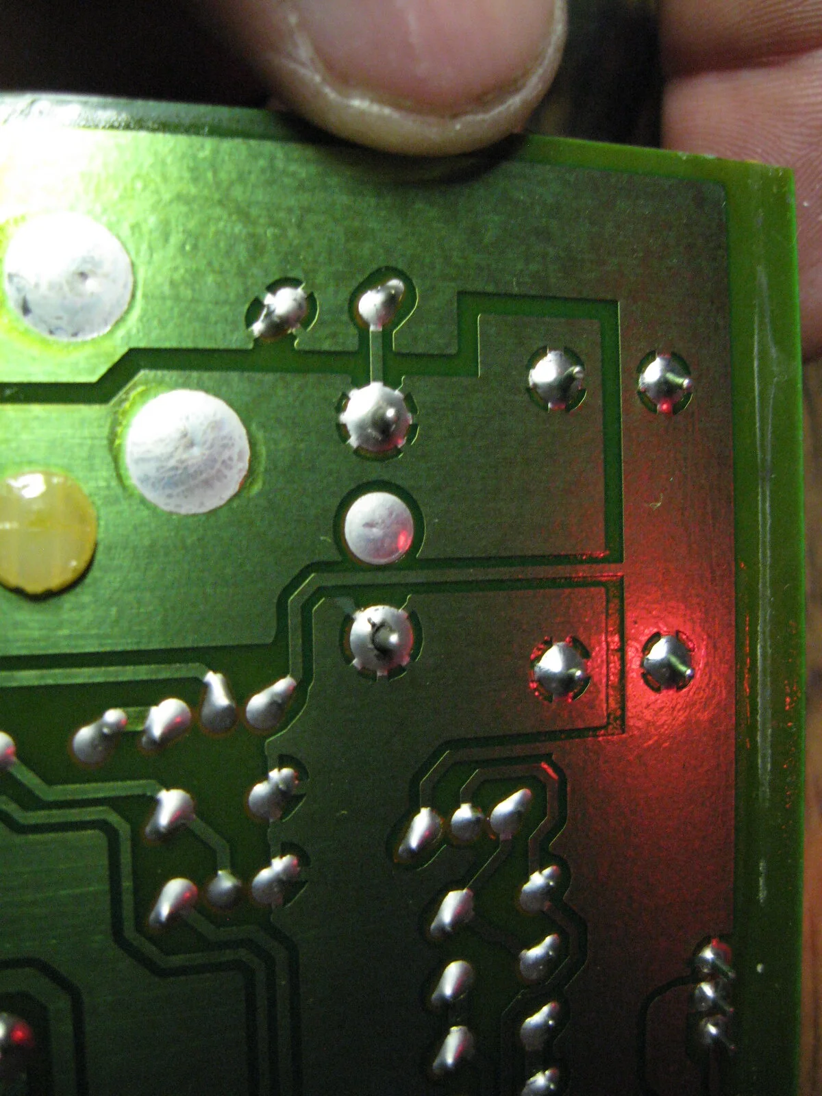

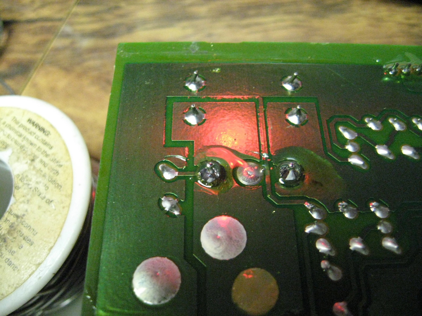

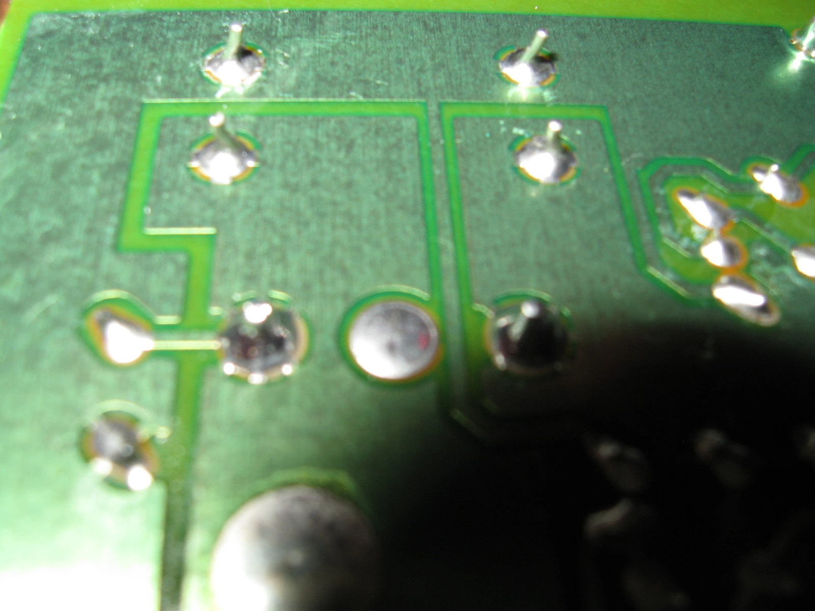

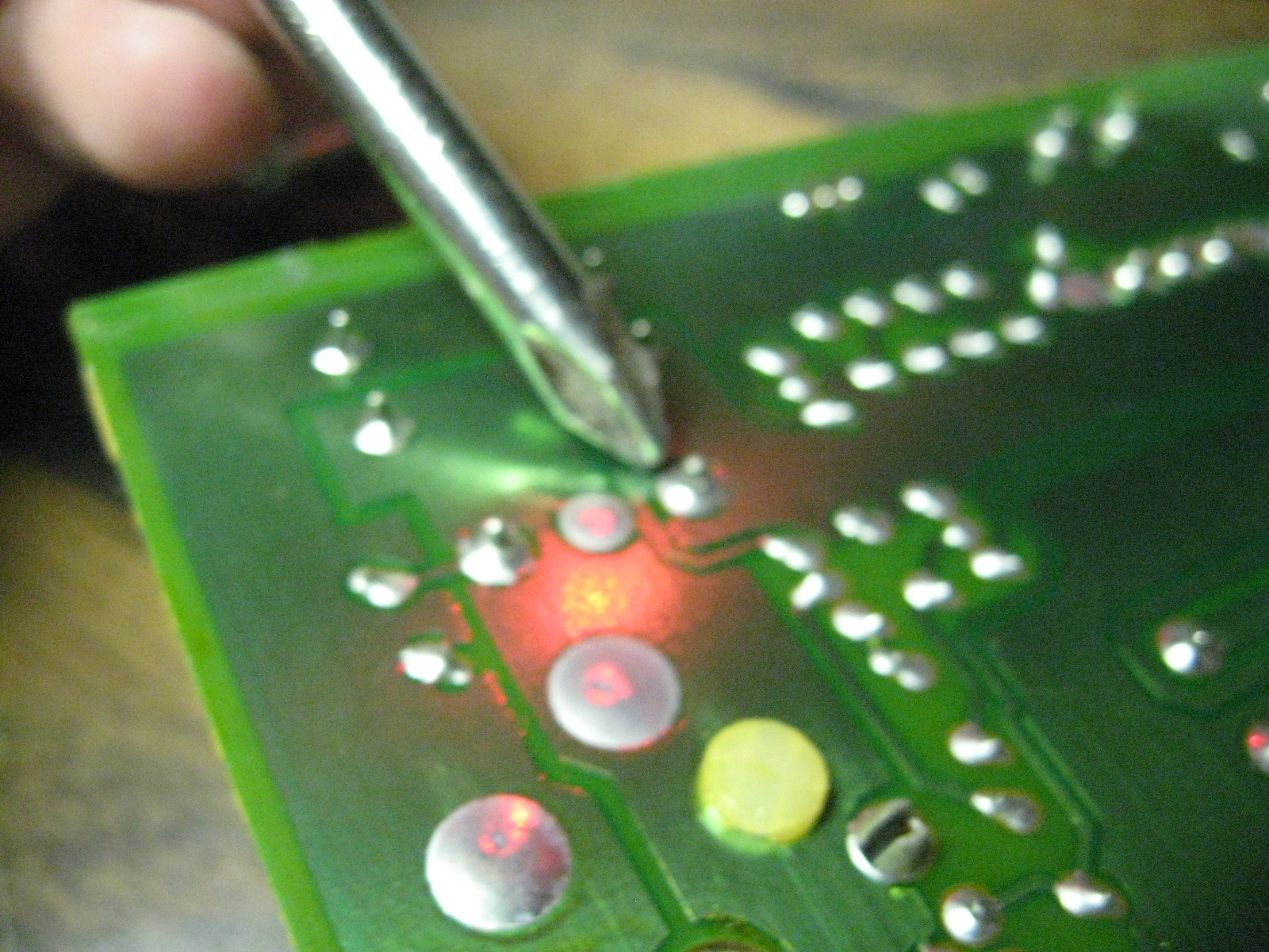

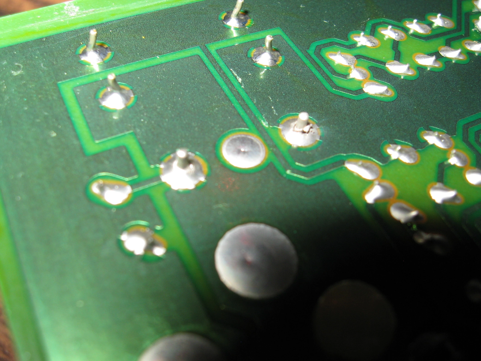

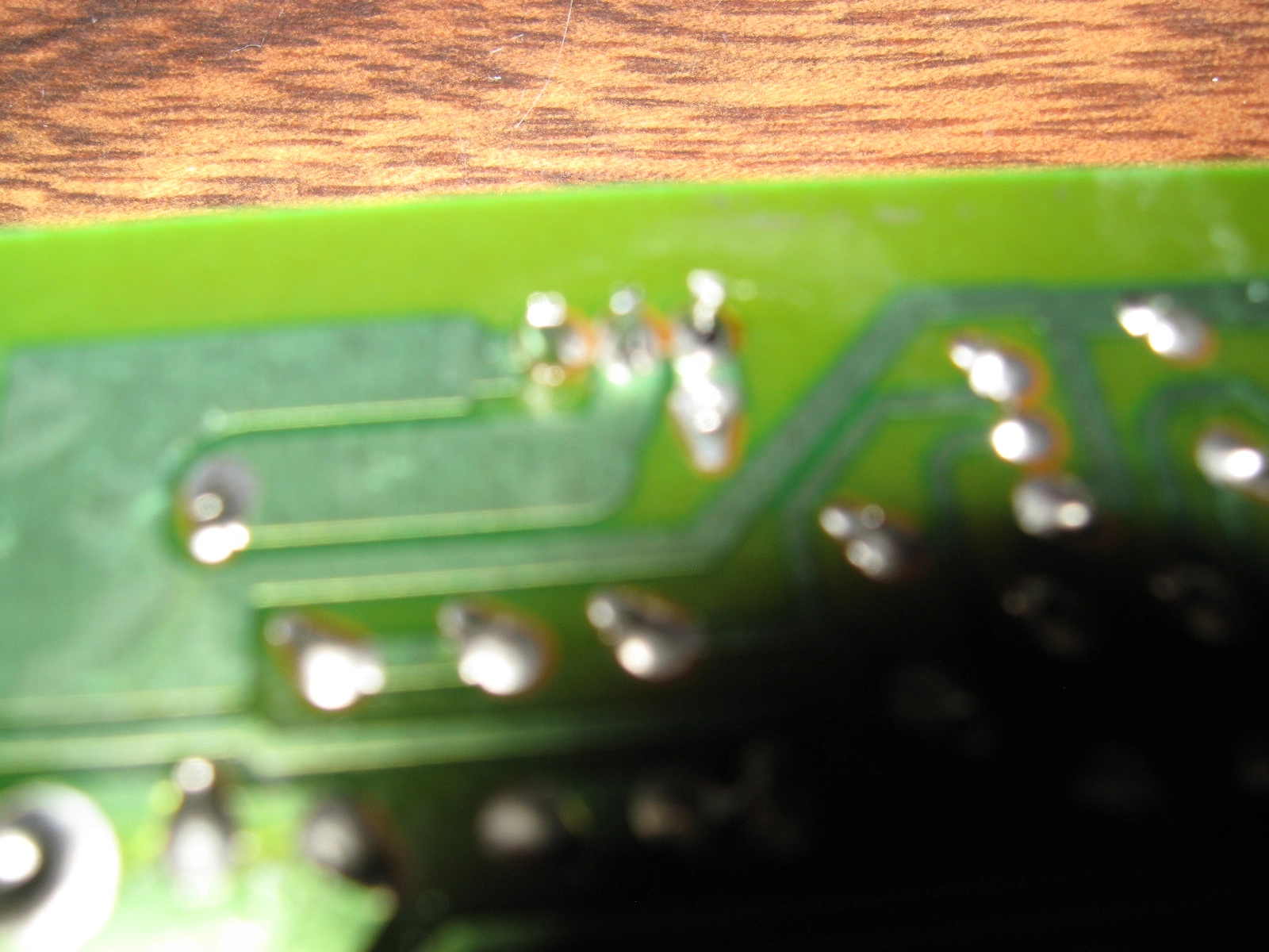

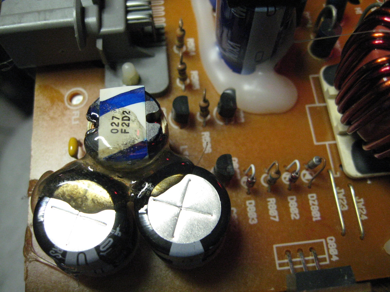

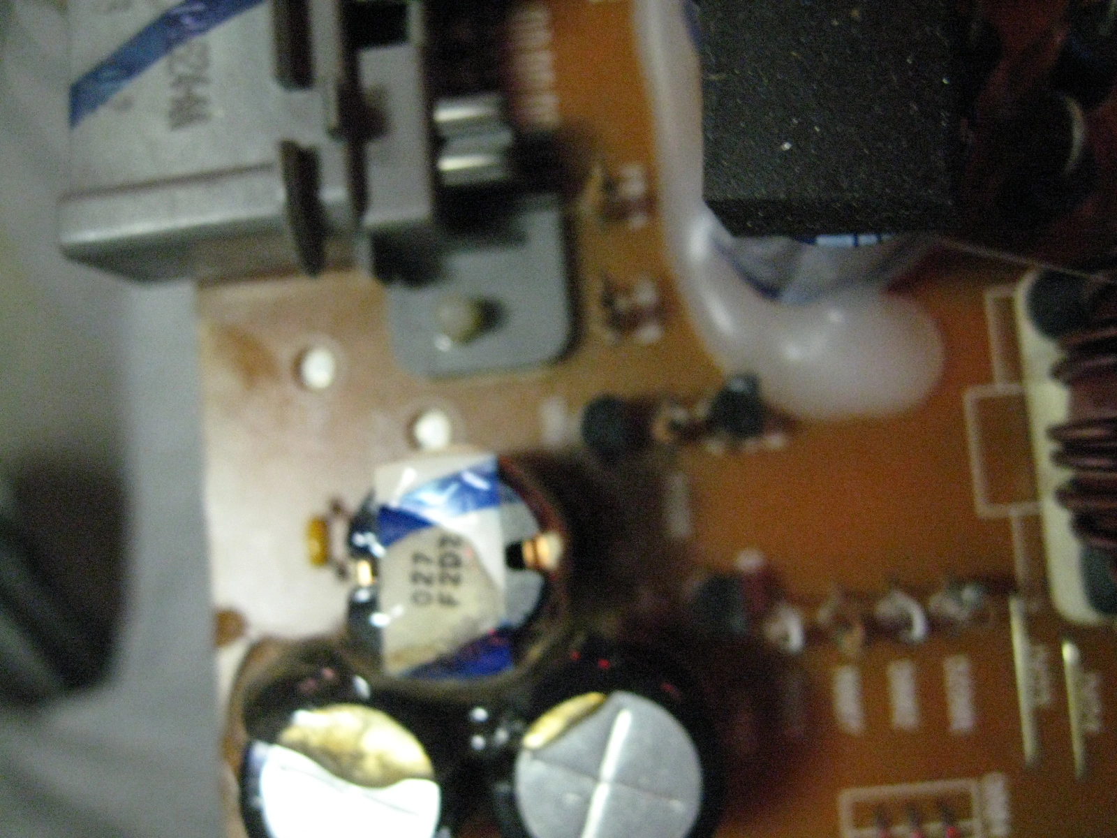

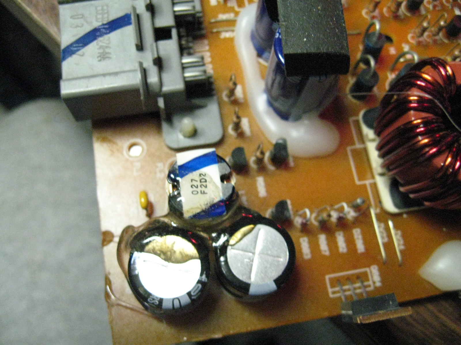

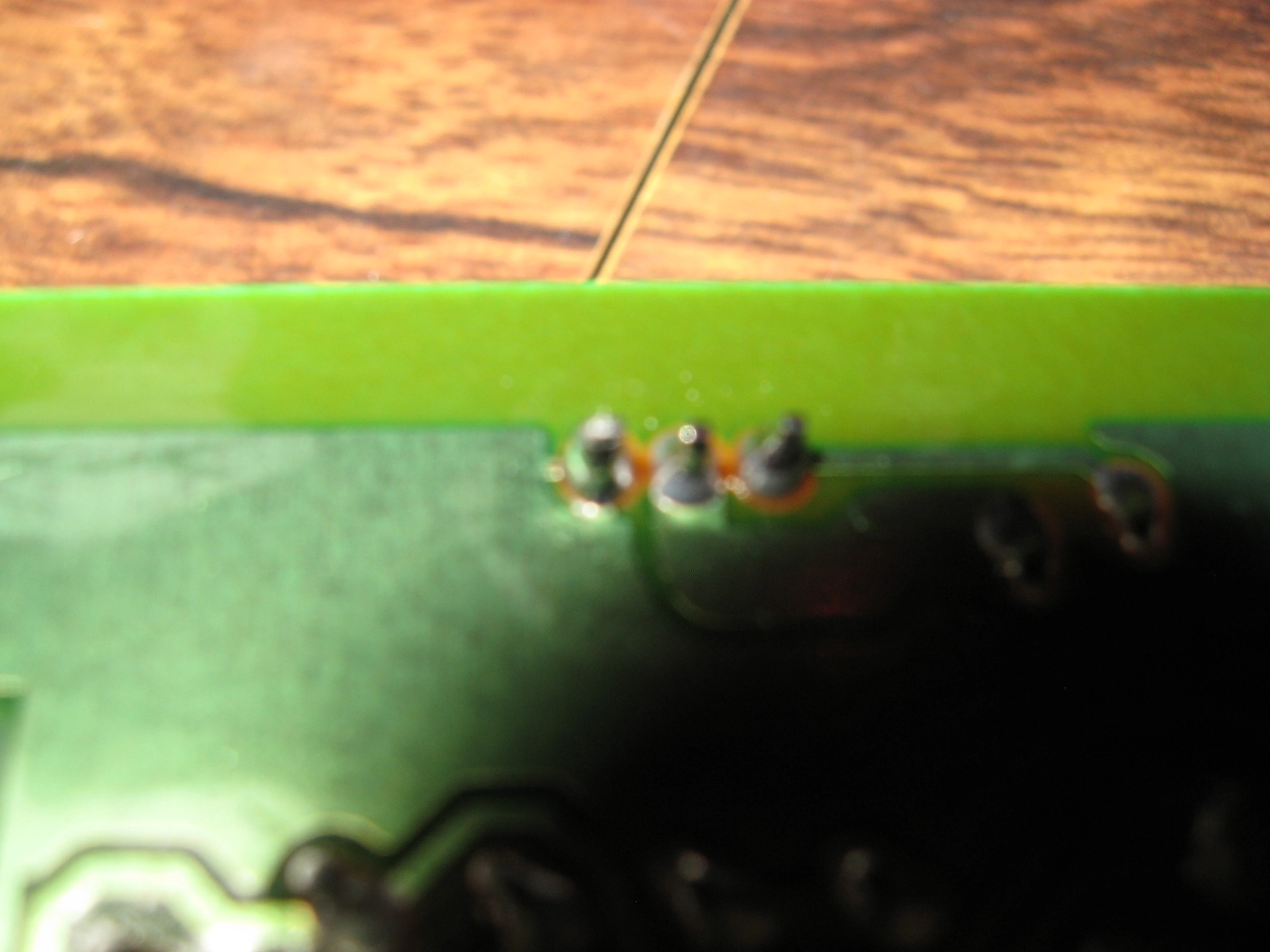

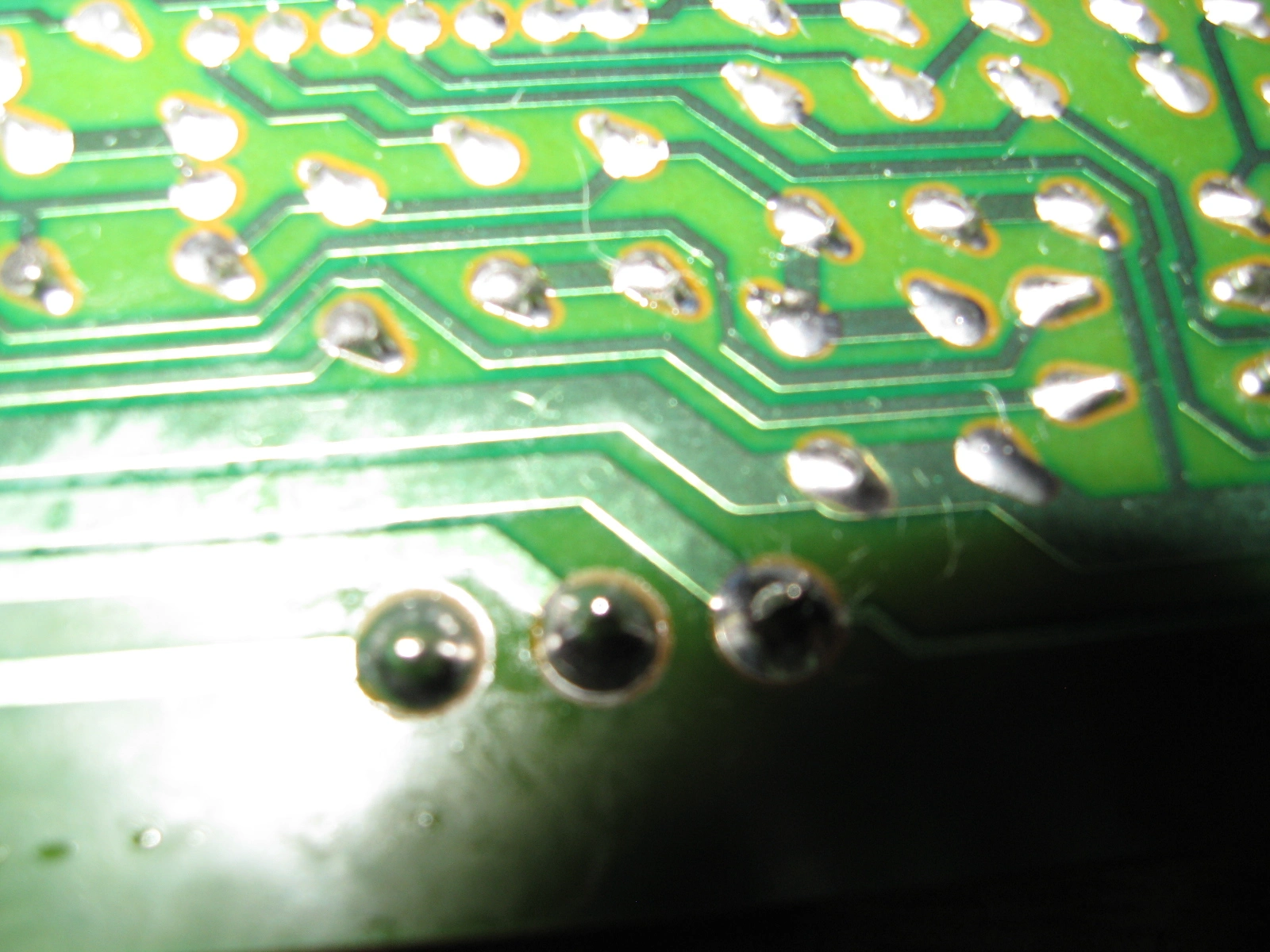

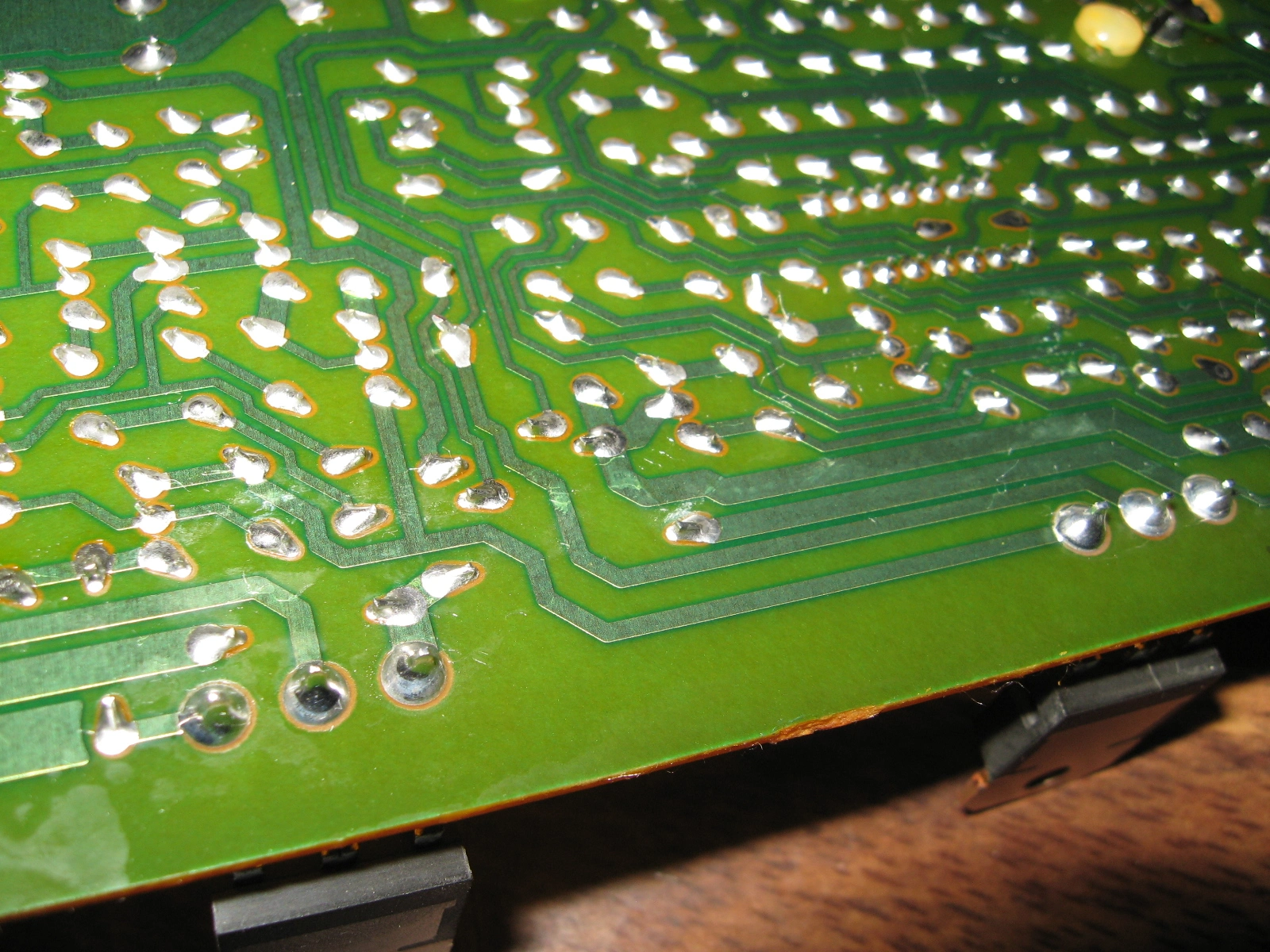

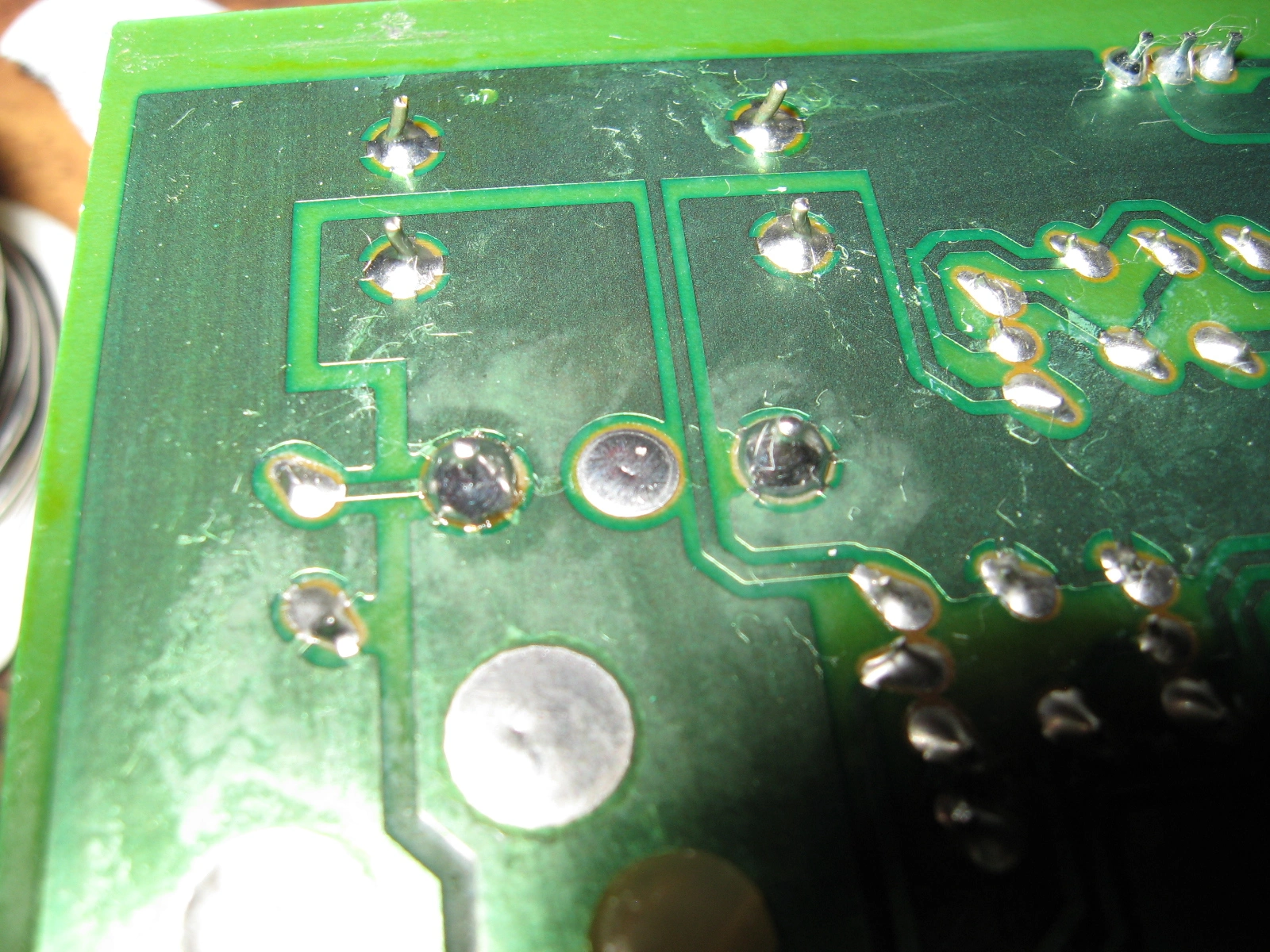

So I pulled 1 amp and checked the power choke inside and bingo! loose solder joints.
I sucked the old solder and used some Chip Quik SMD291 rosin paste and soldered them really good.
I report if it worked.
BRB
well I got good news and bad news. good news the amps work and the bad news is the drivers door "woofer" does not work.
