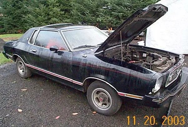

DAMN... You know, that think looks EXACTLY.. to a "T", like the '76 V8 coupe I had for a short time in Albuquerque. Same Color, interior, even same steering wheel and Wheels! SPOOKY. I'll tell ya, for a Frankin and a half, you did pretty damn good. I bought a '78 Ghia back in November for a Franklin and it doesn't look nearly as nice as yours. It's a Black on Black, V6, auto car too. Hell, 1/2 the V6 was in the trunk... :D See if I can find a pic...
