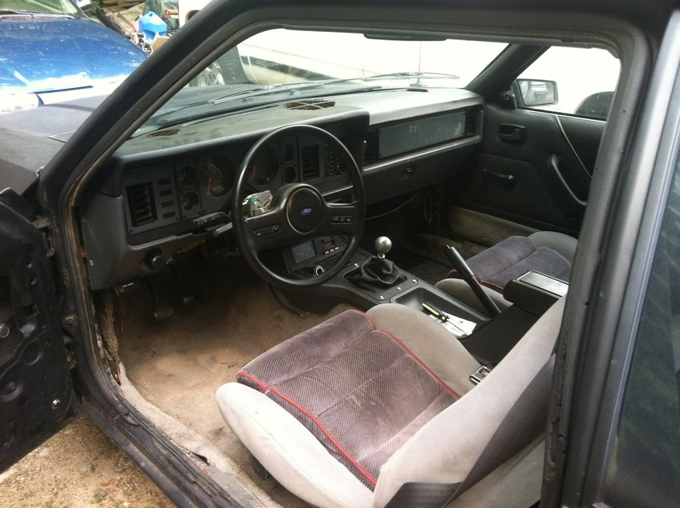

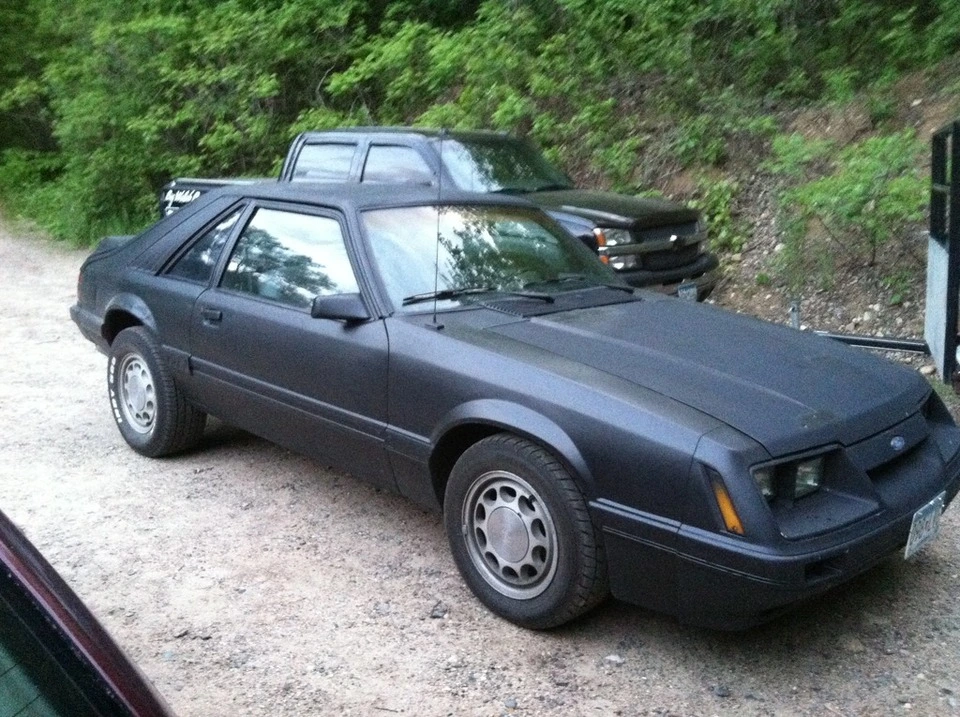

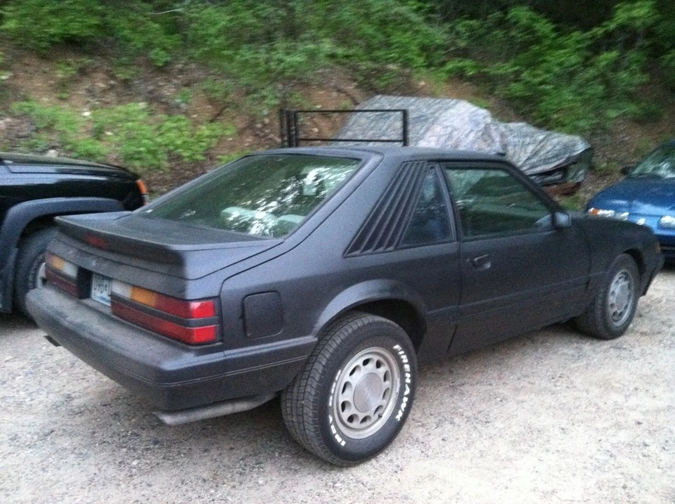

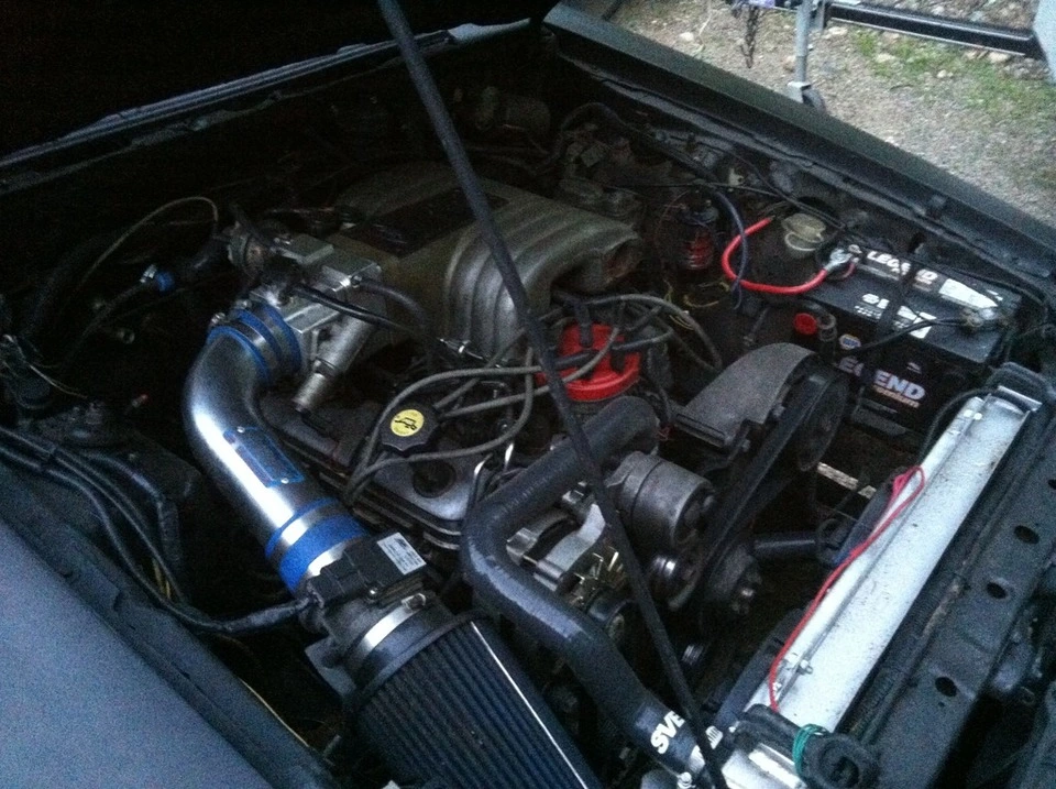

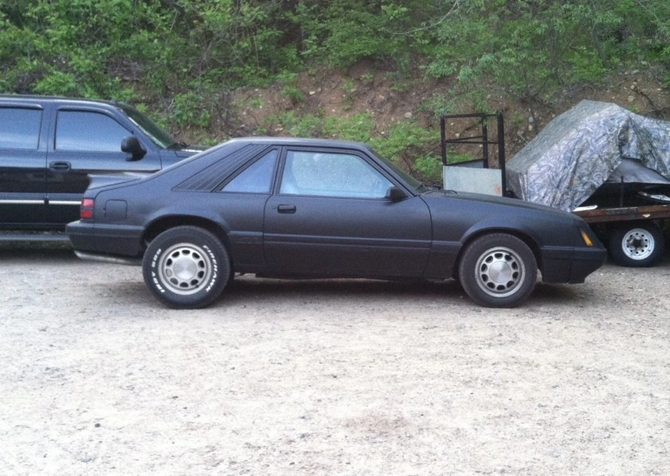

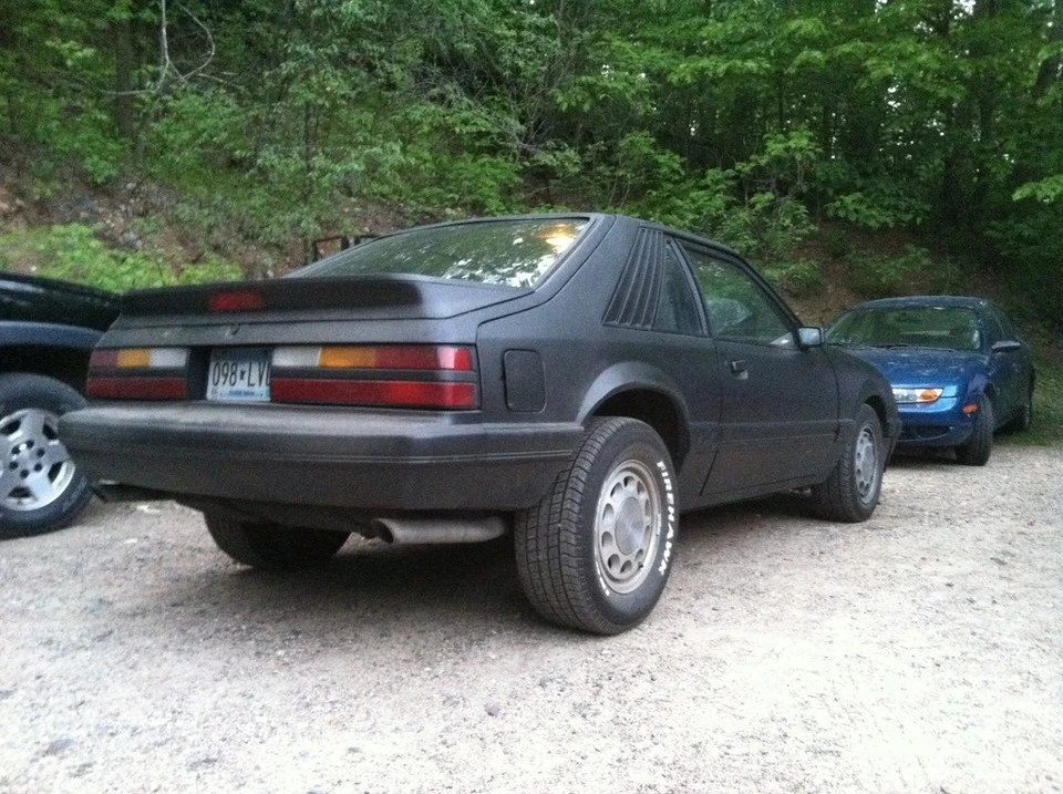

Here are some pics.

3. The "stinkbug" look. I don't know how he "added" 1"... the southside arms? Thinking about either cutting the stock rear springs(Ghetto) or buying aftermarkets. don't want to spend the money on coil overs.

#3) looks like the rear tires are considerably taller than stock. OEM tire size is 225/60/15 so use tire calculatiors online to see how far you are off.
