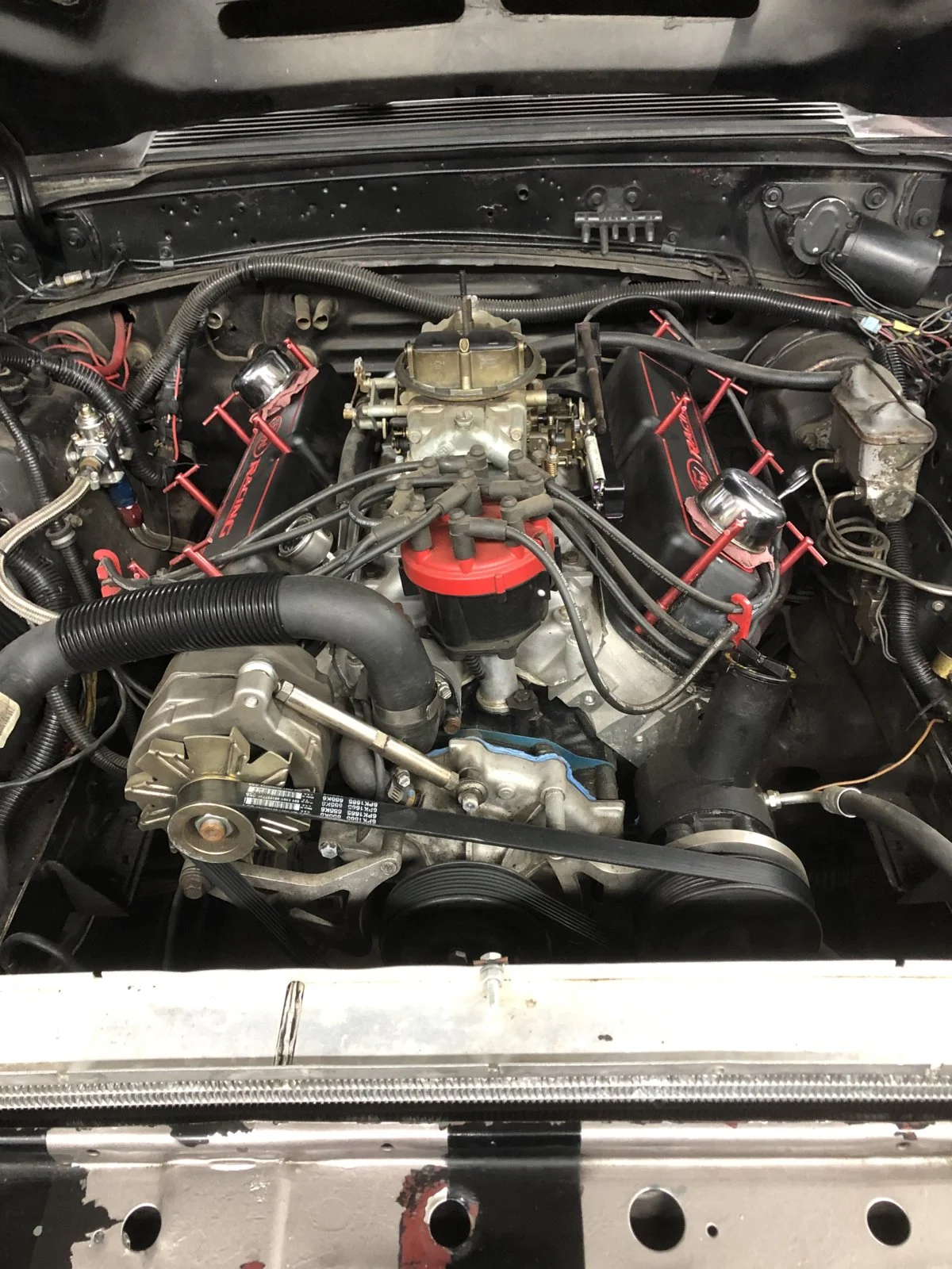

Hey guys thank you to anyone who helps.
But to start I have an 85 fox with a 5.0. Well what I’m being told. The guy is collecting all the paperwork for me. But he said it’s a 302 bored 30 over. It has aluminum heads with an Edelbrock intake with a 750 Holley carb and a cam. Cam size not sure. Sorry. It has long tube headers also. It also has a built c4 with a 3200 stall. It was converted to a drag car with a cage and seat with slicks. The guy says it runs 12.9 all motor. I managed to run 13.6 consistent. So my help is needed with what should I be running and from what I’ve seen from a 306 my next question is y isn’t it faster
Why don't we have some pics of the car?

Ok, get out that silly little smart phone and get a friend to take a couple videos at the strip when you get there and take some pics of the ride, we don't care if it has a lawn chair for a drivers seat, we like pics, oh and we don't judge.
Well, actually we do but it's all in fun.
